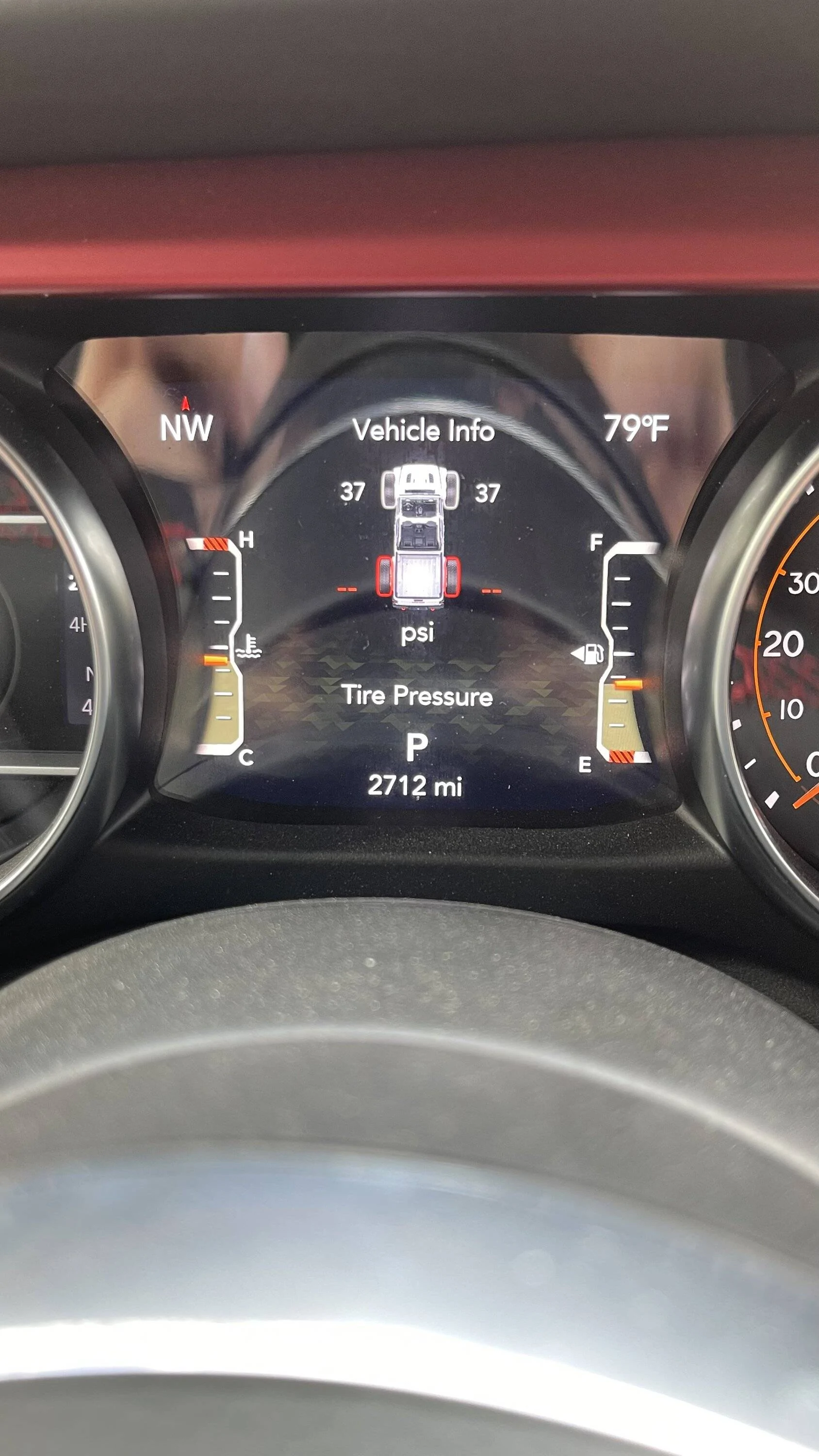

Surging after pro cal snap
Darkspeed
Aug 12, 2022
447
557
Central Florida
2023 JTDR
I decided to do the AEV pro cal snap tire size change and on the first drive I get a feeling like I’m slowing down then surging back up to speed. I also noticed a red line where my two rear tire pressures should be. And a low pressure alert. I put oem 433mhz transmitters in all wheels. Am I hitting a limp mode due to tire pressure or possibly pro cal snap related?

I changed the tire pressure in all 4 tires and the front two registered the pressure change on the screen. The back two are still not responding.

I’m starting to wonder if there is some interference with the rear two sensors

I put the oem tires/wheels back on and did a taco run and all for sensors responded and limp mode went away. Not very happy that a bad tpms seansor will limp a new gladiator.
