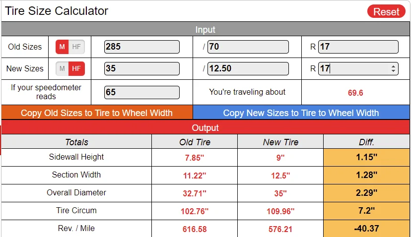

Currently have the Falken A/T tires on my stock Rubicon. First question how do I know if they are 35’s or what they are? Secondly What is the tallest tire I can go with that will not affect the handling especially on snow covered roads.? This is my first Jeep and I’m new to this whole tire size stuff. Thanks.

OEM tire size for a Rubi is 285/70-17, which is a 33" tire. You can go to a 35" tire with no lift

Here is a copy to our tire calculator so you can see the difference in size and how it effects your speedometer, keep in mind all tires measure slightly different on your vehicle.
Jeep Gladiator Tire size 1665444439885
