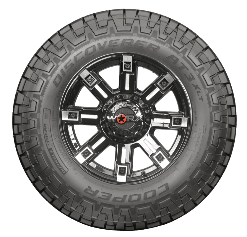

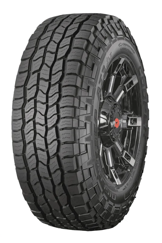

Discoverer® AT3 XLT™
  • Beefy traction shoulders grip to tough terrain for enhanced off-road control
  • Built for heavy hauling and towing
  • A long-lasting tire backed by an outstanding 60,000-mile treadwear warranty
there's also an LT version
