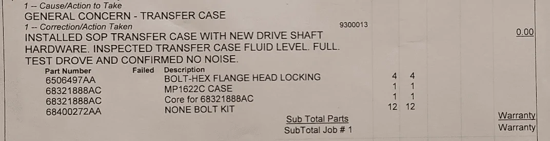

So.... no word from the dealer all morning so I started dialing. Finally got someone live and was told a new TC is on order. The TC won't be here until the middle of Nov so I brought it home until then.
I'm not 100% confident on the repair notes here, but for the rear (which is still making the noise when I brought it home) the notes said the drive shaft bolts were loose. They tightened them up and ordered new ones for the new TC.
For the front noise (which I think is axle-related) they ordered the new TC.
I think the TC is actually making the rear-ish noise... but, I'll let them do their thing and we'll see how it turns out.
