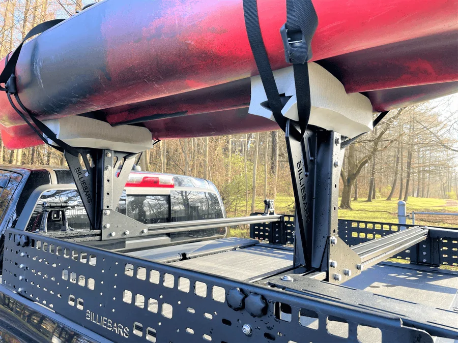

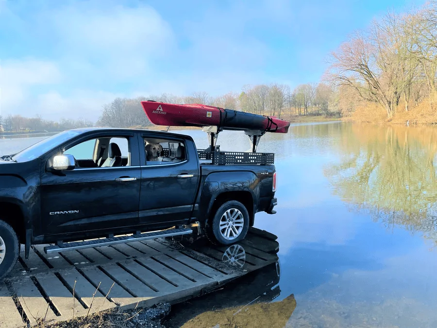

They have that covered too. Can bias the crossbars further forward on the bed if you want to reduce hang over the rear.
Jeep Gladiator Truxedo Sentry and BillieBars (and Kayaks) 1659375331922
Jeep Gladiator Truxedo Sentry and BillieBars (and Kayaks) 1659375378010
https://billiebars.com/collections/water-sports/products/billiebars-kayak-mount-kit

By the time you add up the cost of the crossbars and those kayak holders, you would be better off just getting an actual bed rack.
https://www.max-modular.com/jeep-gladiator-bed-racks-1/max-modular-22-high-aluminum-bed-rack
You would be able to keep your tonneau cover and roll it back with the rack installed to still keep your truck a truck and utilize your bed.
Don't forget, an actual bed rack like the one you linked isn't a "once and done" purchase either. You still need to get the mounts and attachment points your gear requires there too. Not to mention, it's not easy to remove to make full use of the bed like he wants. Definitely a convenience cost that needs to be considered there too.
I remember comparing that exact rack you linked before going with the BillieBars, and there's a decent commitment you have to make to having that rack that you just don't need to make with BillieBars. You can make them as big as full as you want, or as small as you want, or even remove the crossbars so they're not there at all. That freedom for some of us is the key.
