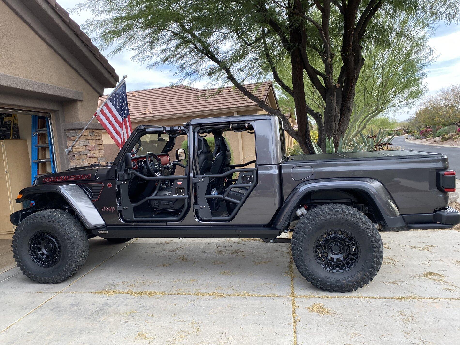

As pictured .....rides better than stock Rubicon.
1. 3” Rock Krawler lift
2. Falcon SP2s (these are game changers)
3. Yukon 4:88 gears (must do. ...I’m getting in excess of 18 mpgs)
4. 17” wheels
5. Cooper STT Pro tires 37x13.5x17 ( again... game changers on and especially off road)
Worth every penny. Good luck with yours!
