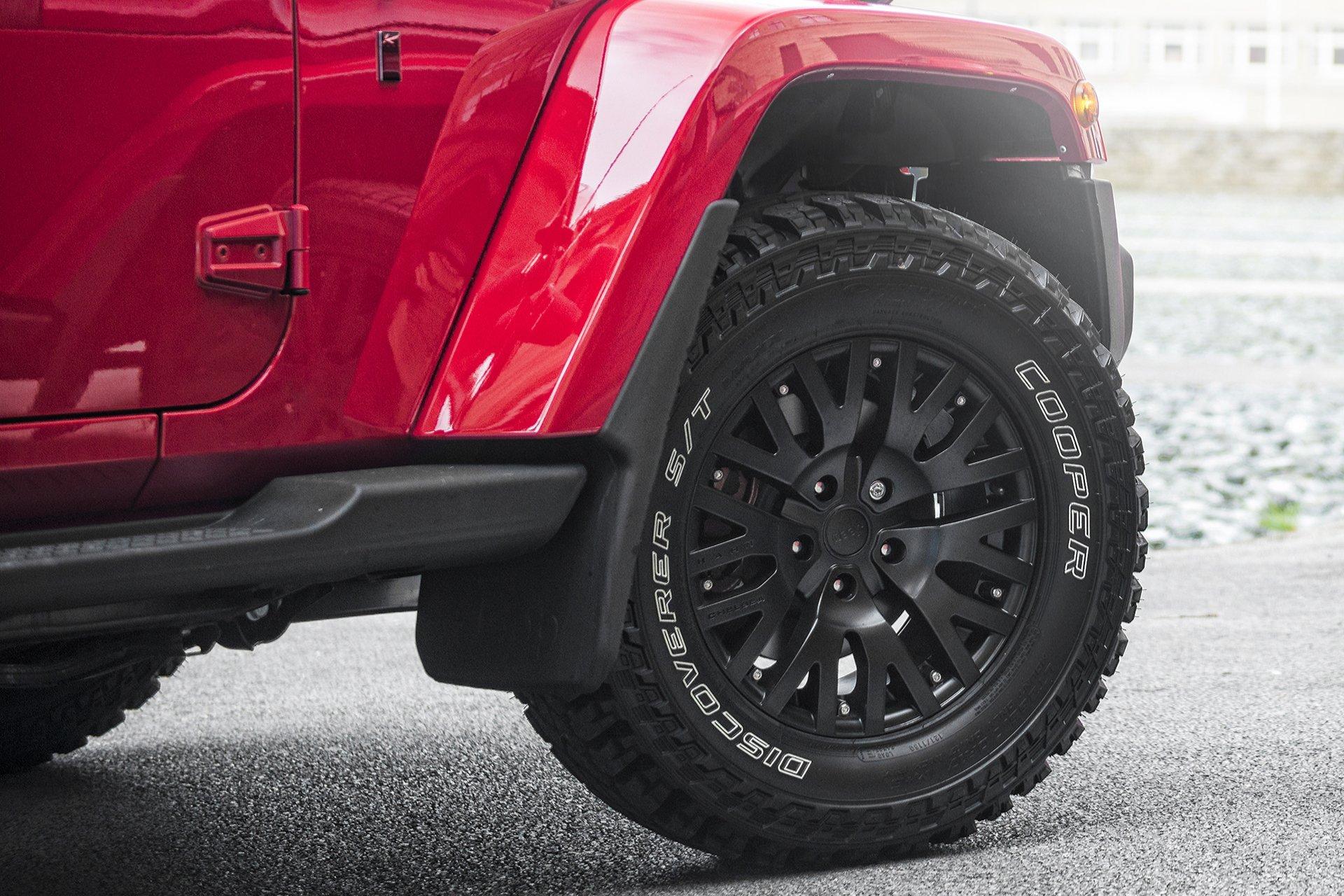

I like these wheels from over seas that say they fit JK wranglers 2007-2018. It's from Project Kahn. Project Kahn Site So I checked the specs on the JK wrangler and compared it to the Gladiator.

Here are the wheels and I think I'm going to purchase some Coopers 295/70 18 Discover STT Pro. I need to make sure these wheels fit because they are coming from Europe and shipping is quite a bit. No returns unless I want to spend over $500.

I’m running JK wheels.
They’re the same size, you just use your lug nuts.
