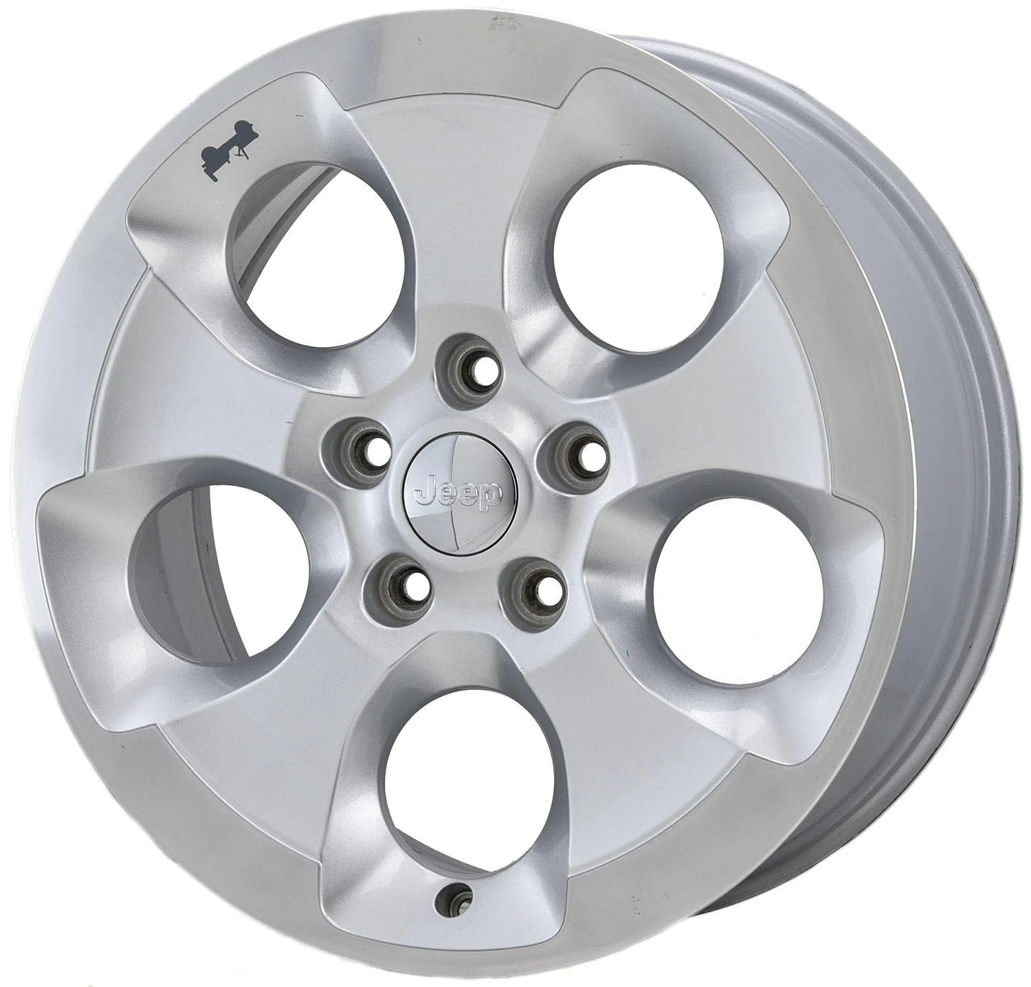

I have a chance to pick up some wheels and tires for a price I find acceptable. The tires are KO2s and are 285/65/R18 on OEM wheels. What Jeep they came off of I do not know, but they came from a local shop that does a lot of the Jeep modding work around here and they have the picture of the Jeep on them like the OEM wheels on my JT have. Will these fit my Gladiator Sport? I think they should, as the Overland uses 18 inch wheels.
ETA they use 14x1.5 lug bolts, which is what the Jeep Gladiators use. And they have the little jeep icon on them. So it looks like they are wheels that came off an overland and the seller put on KO2s (and ended up not liking them).
Someone on JL forum said they are JK Sahara wheels. Compatible? Though I don't think these are JK wheels. JK takes 1x20 lug nuts and the wheels I'm getting take 14x1.5, according to quadratec
https://www.quadratec.com/c/reference/wheel-bolt-patterns-typical-lug-nut-torque-specifications
Then again, these look spot on
https://www.detroitwheelandtire.com/hol-9119-mss-a.html
