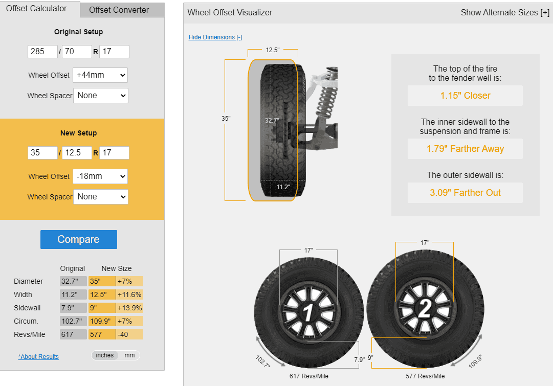

Go here and enter your numbers. It will give you a decent illustration of how it changes things
Wheel Offset Calculator

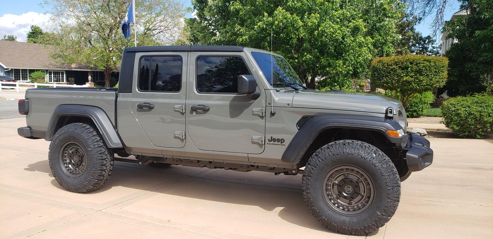

Jeep Gladiator Black Rhino fitment question 20200518_152534
Black Rhino wheels same size and offset as the wheels you listed on 37" tires. Used 1.5" spacer in the front and removed the air dam cover. No rubbing on the street but some fender rubbing offroad.

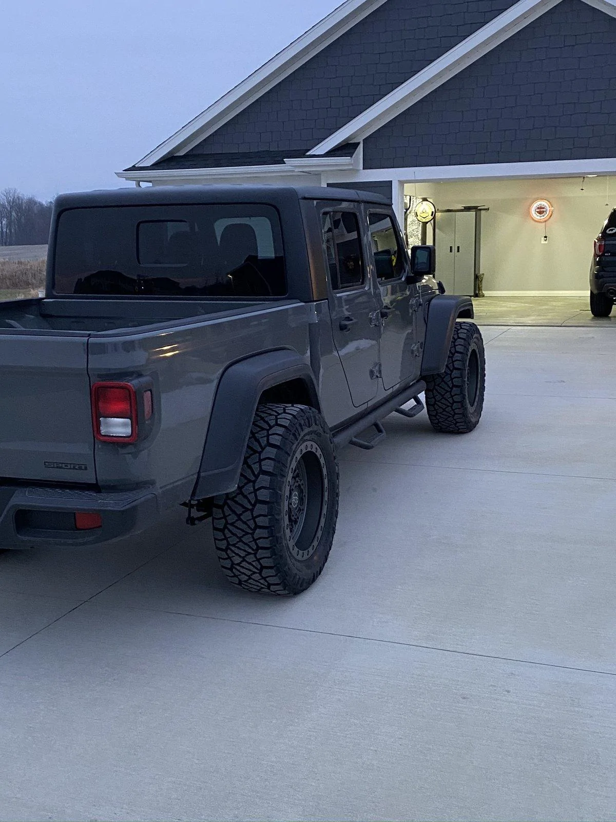

Jeep Gladiator Black Rhino fitment question 929D847F-1058-4E4C-A9FA-F10FB158115B

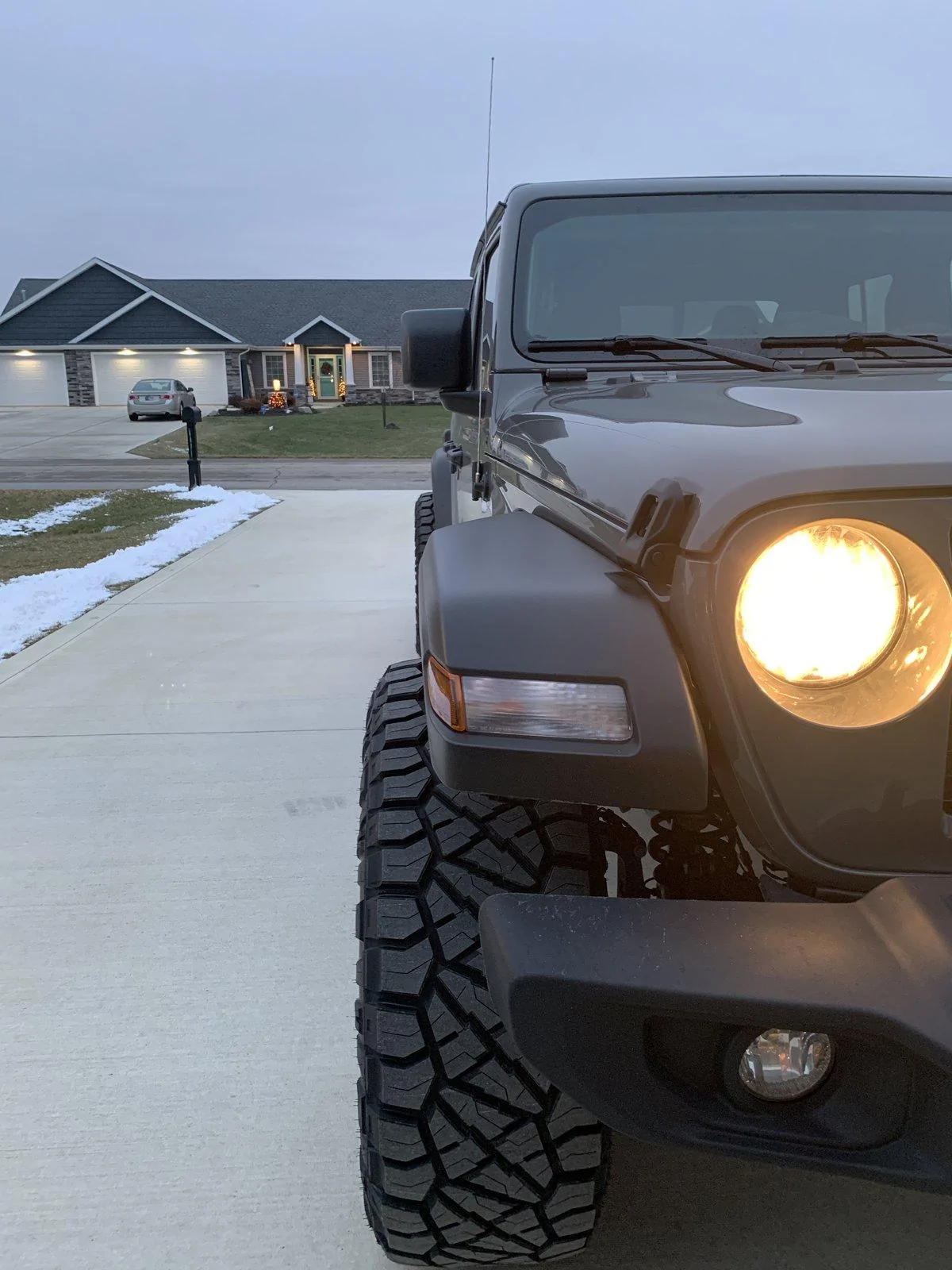

Jeep Gladiator Black Rhino fitment question AABB0361-1465-4DF7-A31C-AEE8068DEE52
Mine are 20” but this will give you an idea how far the -18 will poke out. I really like the wheels but wish they were closer to a 0 offset. The side of my truck is never clean.
