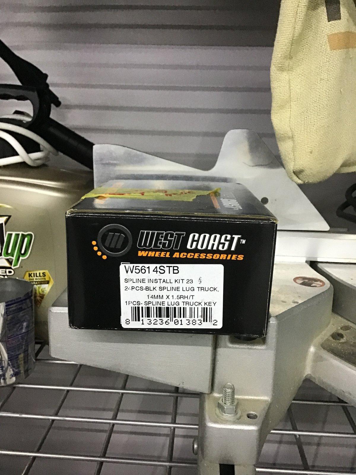

The same here. OEM will not work. Here is what my dealer put on my BR wheels for reference.
Jeep Gladiator Black Rhino Wheels: Lug Nut Questions image

Get spline lugs for the BR wheels.
So then I have to keep up with a special socket to remove them in addition to the one for the locks. I’m not a fan of this reason. If I can use hex nuts I would prefer to for this reason only. A regular socket or tire iron is always handy. A special splined tool, not so much. If I have too I will but I’m hoping there’s other options
There are other acorn style, but splines are typically stronger on a narrow walled lug nut.

Spline is the way to go. Stock won't work meaning the wheel lock you are worried about won't work either.
Just throw the spline socket in your glovebox and leave it there. Not that difficult.
