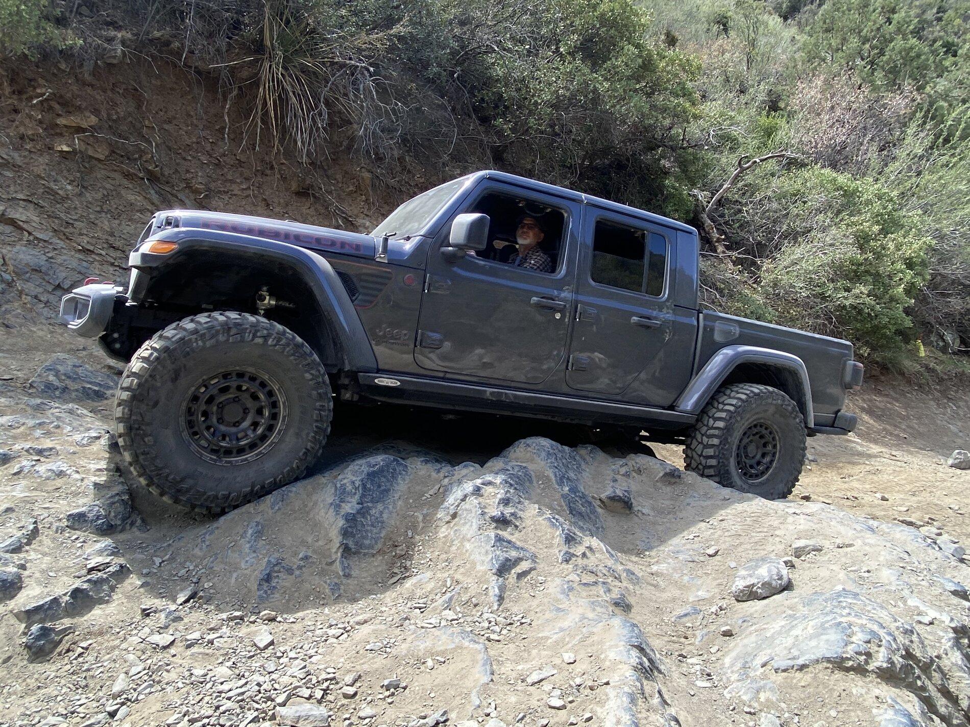

17 in rims and 35s. I used @Discount Tire as they are a forum sponsor and got me a great deal. You could go crazy with 37s. It would look good, but I do not know what you'd need to upgrade. You are running a diesel. I'd think the 37s would run fine, but I am not sure about steering knuckles etc. Someone on here could chime in on that.
All in all I feel 35s on 17s would look good, ride good and let you wheel most trails. For comparison. I have 33s and no lift.

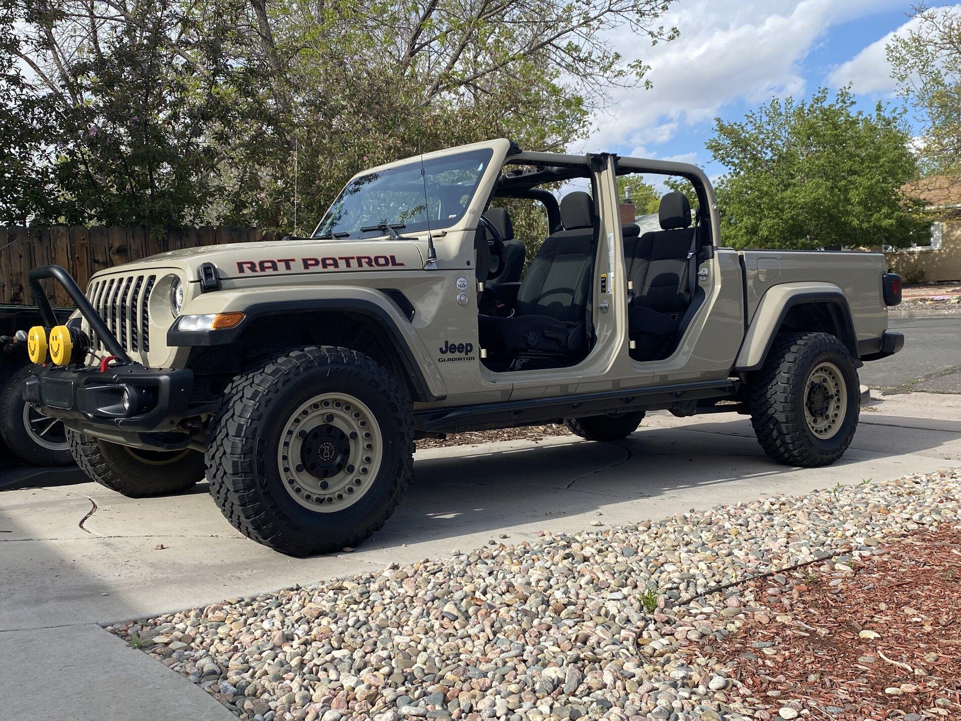

The age old debate. Really depends on what you actually want to do. I went 3” and 37x13.5x17 because I did not want any issues while wheeling. Call it that extra comfort level.
Went with Cooper STT Pros.... Love them. And they perform.
I did re-gear with 4.88s. This truck runs better than stock.
Do your homework before you leap. Good luck!
