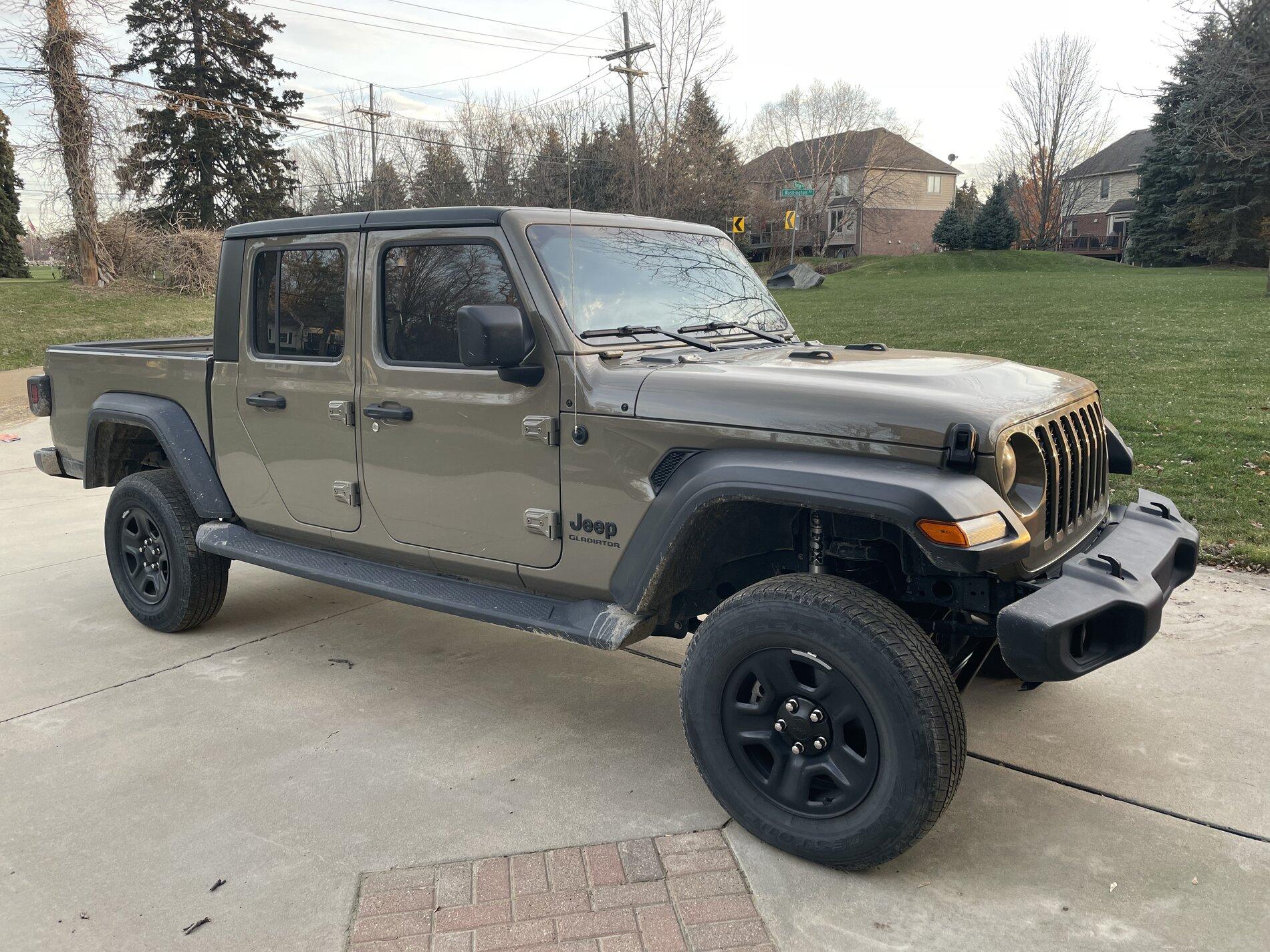

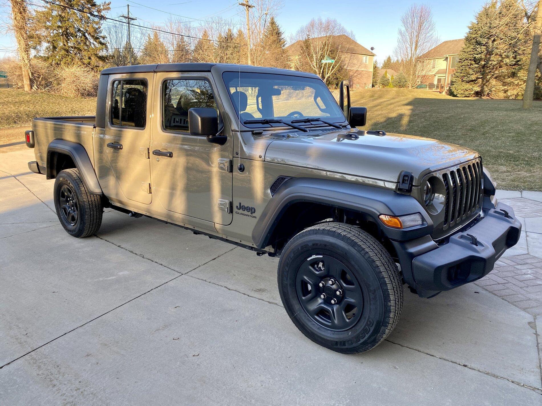

2020 Sport (non-max tow) stock:
Jeep Gladiator Simple sport build- Mopar lift and KMC wheels 4B5675F2-5E7A-4BF0-B9C2-7E9E54367733
Mopar lift, Daystar 3/4” front spacer, Daystar coil correction pads, JKS track bar, Fox steering stabilizer, carrier bearing drop spacer, overland running boards:

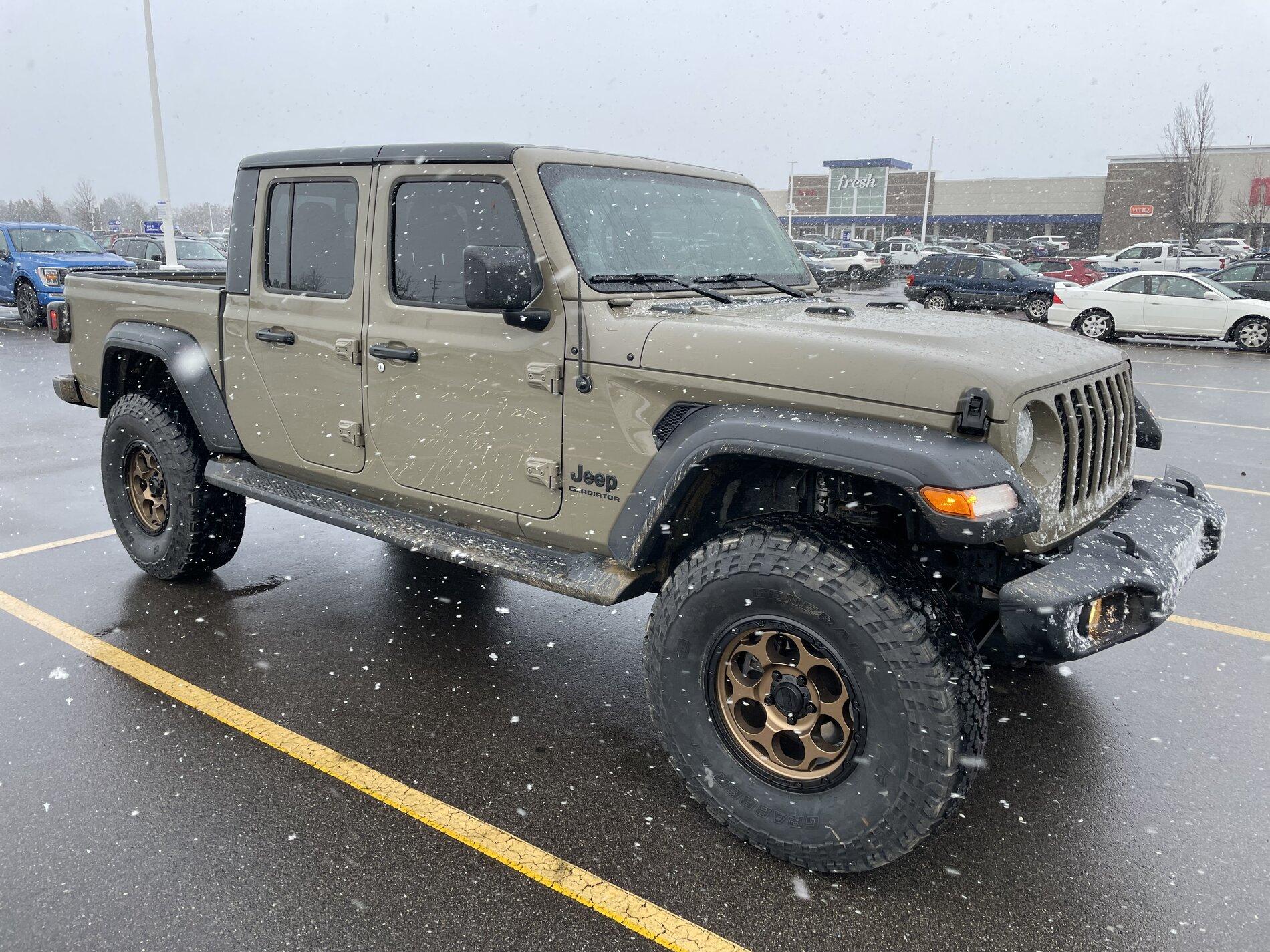

KMC Dirty Harry wheels 17x8.5 +18, General Grabber ATX 37x12.5r17:
