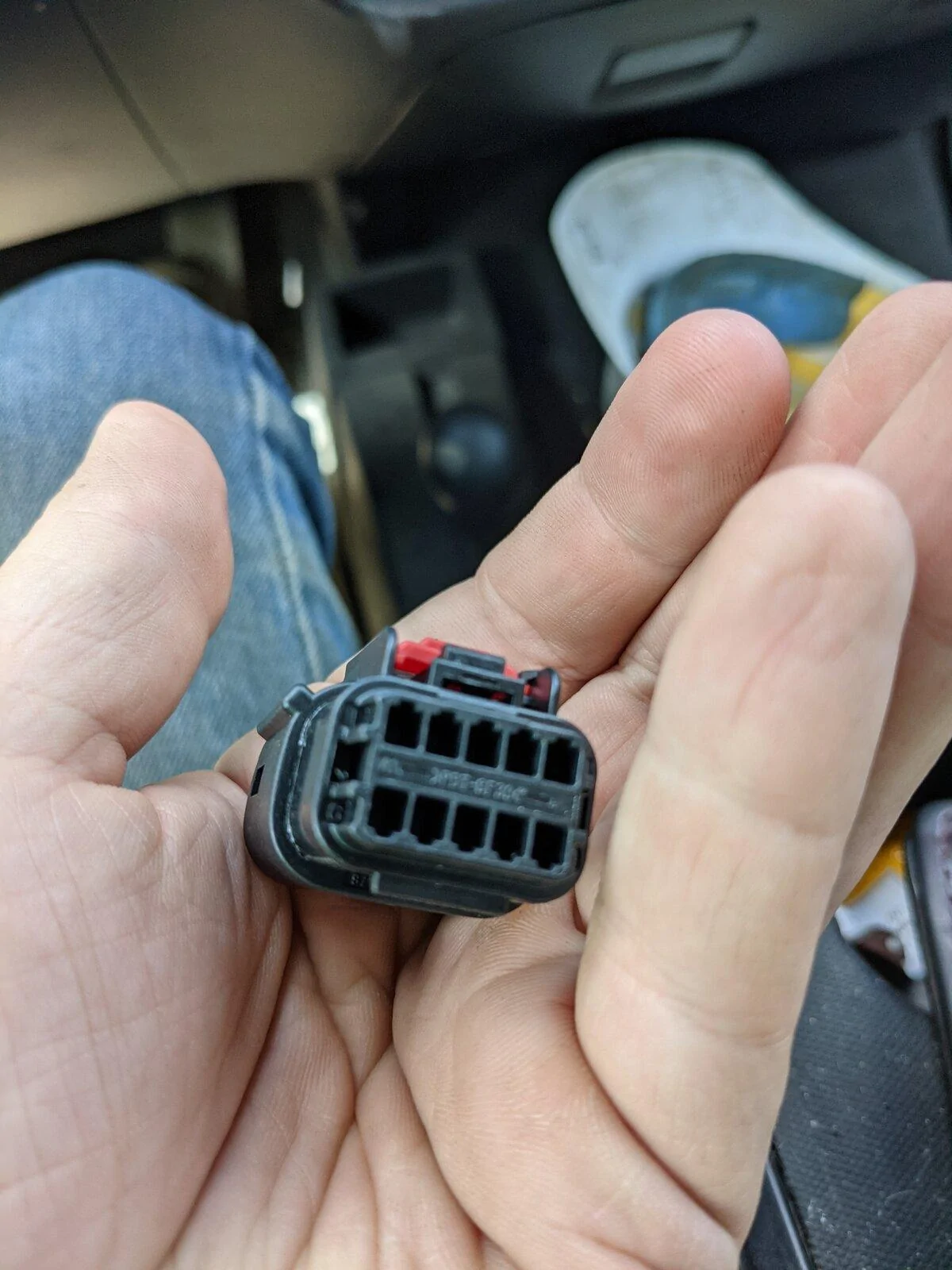

The plug that plugs into the back of the AUX switches, anybody got a part number for that or know where I can get one?
Had an unfortunate accident while depinning.

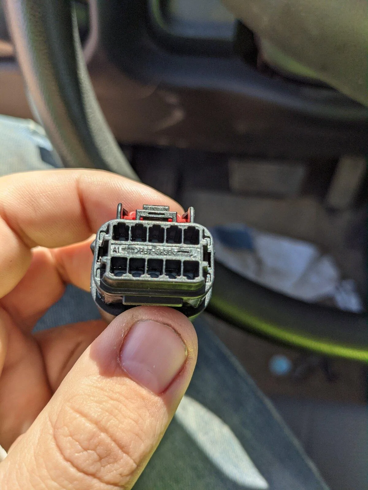

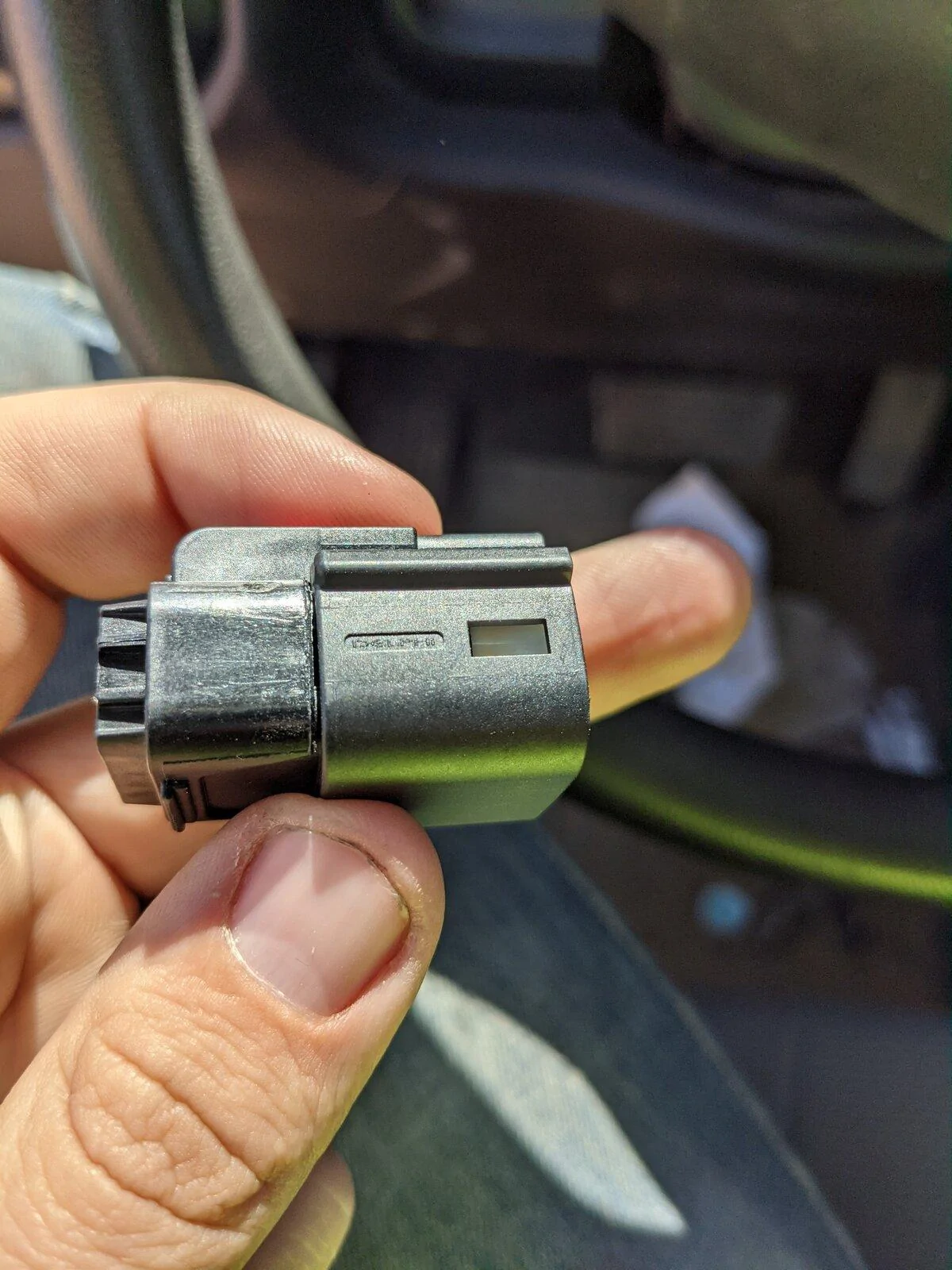

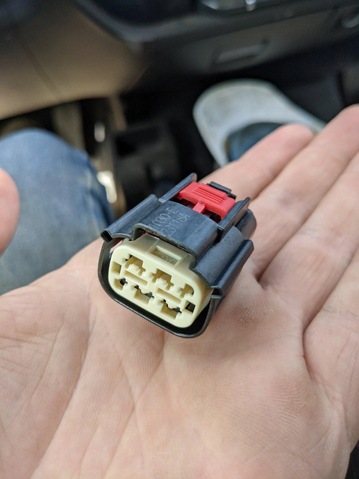

Well this is what I got fr the dealer, and the price is absurd but it fits into the back of the connection.
I'm gonna finish wiring tonight.

The front and back look a little different from the plug you posted but I still think it would fit

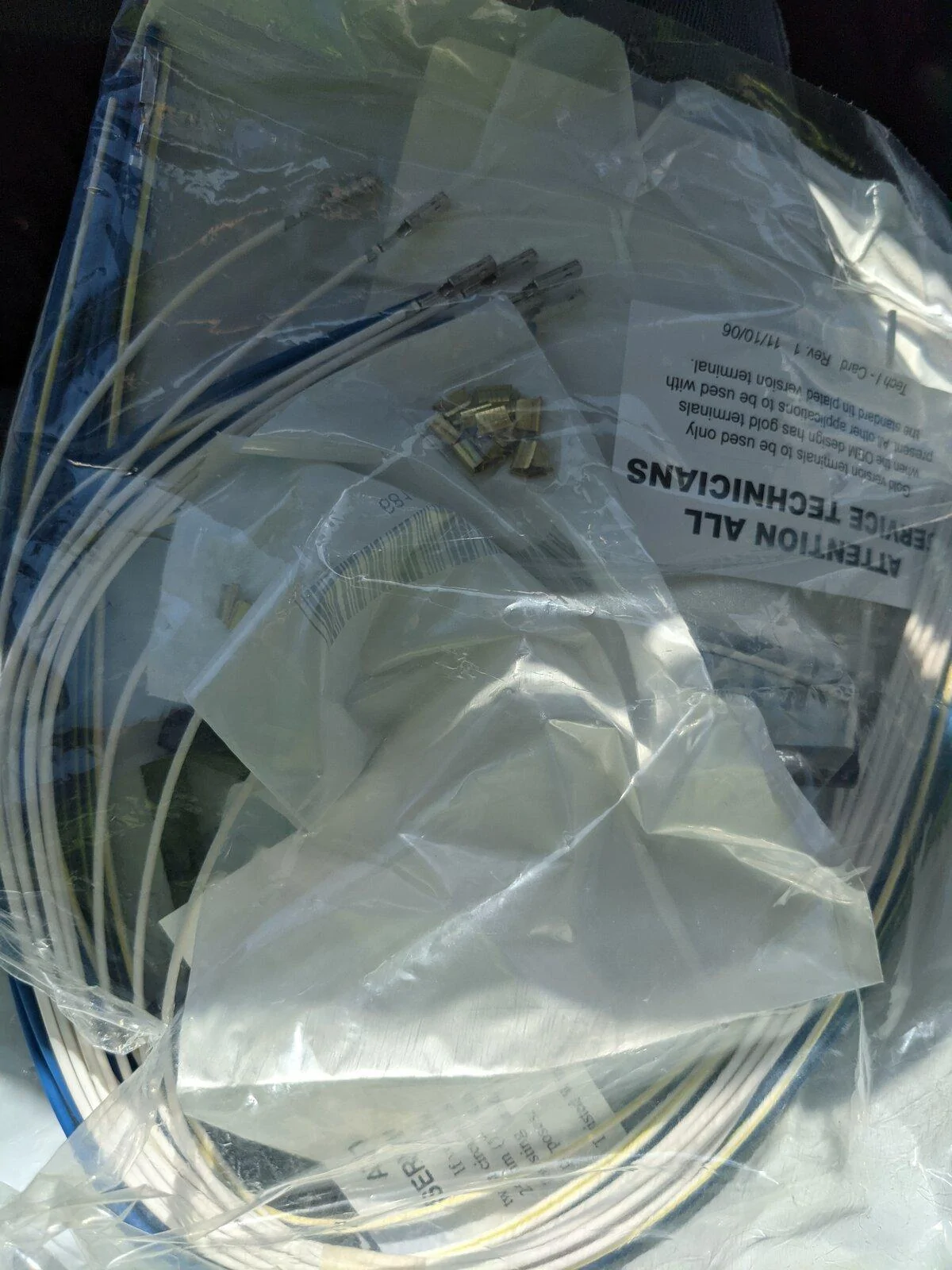

Technically what they charged me for was a parts kit harness.
I'm sure I'm getting taken for on price but this was the fastest way to get it done.
I'll update later.

I see, it's a kit. Hopefully, it has everything you need. You provided a very useful bit of information - the PART NUMBER! This will certainly help others. Maybe we're the only two who messed this up... Thanks again for sharing.

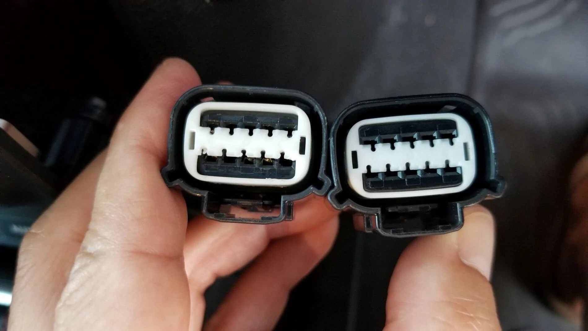

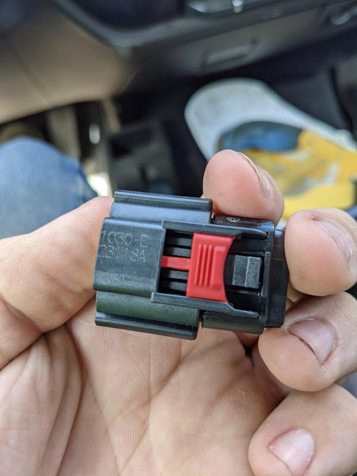

There's a part number for the kit and a part number on the top of the plug, I don't know who the manufacturer is but it's not Delphi like the original one was.
*Edit* just kidding it appears it is a Delphi plug. But it's definitely different from the one I got in the kit.

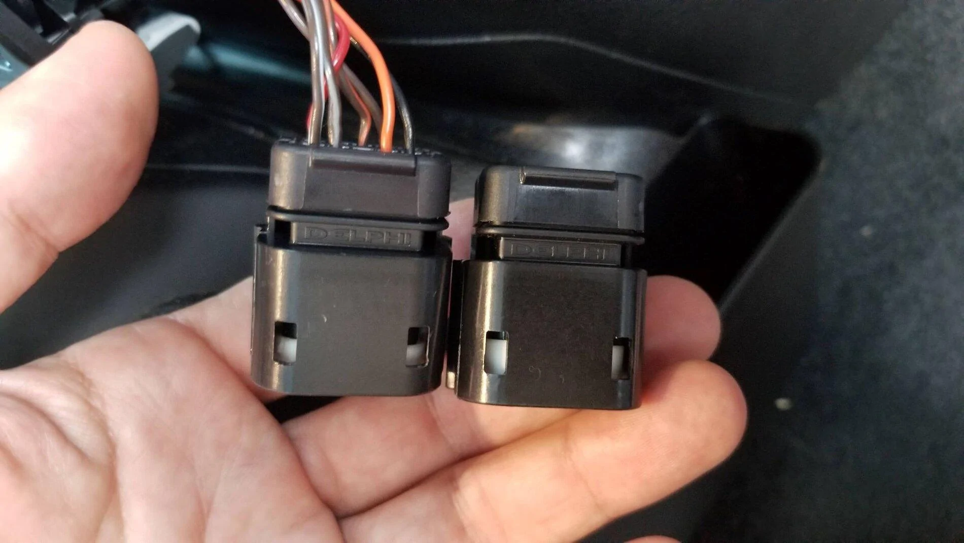

The part I bought from Mouser Electronics is the exact same plug that came with the Aux switch kit.
Original on left and new one on right:
Jeep Gladiator 10 pin Delphi terminal 20210902_184156
Jeep Gladiator 10 pin Delphi terminal 20210902_184058
I bought 18-20 AWG female sockets as well. Once I crimped them on, they slid in and fit perfectly into the shell.
The stock photo has the red lock (?) on the shell, but the one I got didn't have it. The connector shell that came with the original harness didn't have one either. For just under $14, I'm very happy.
