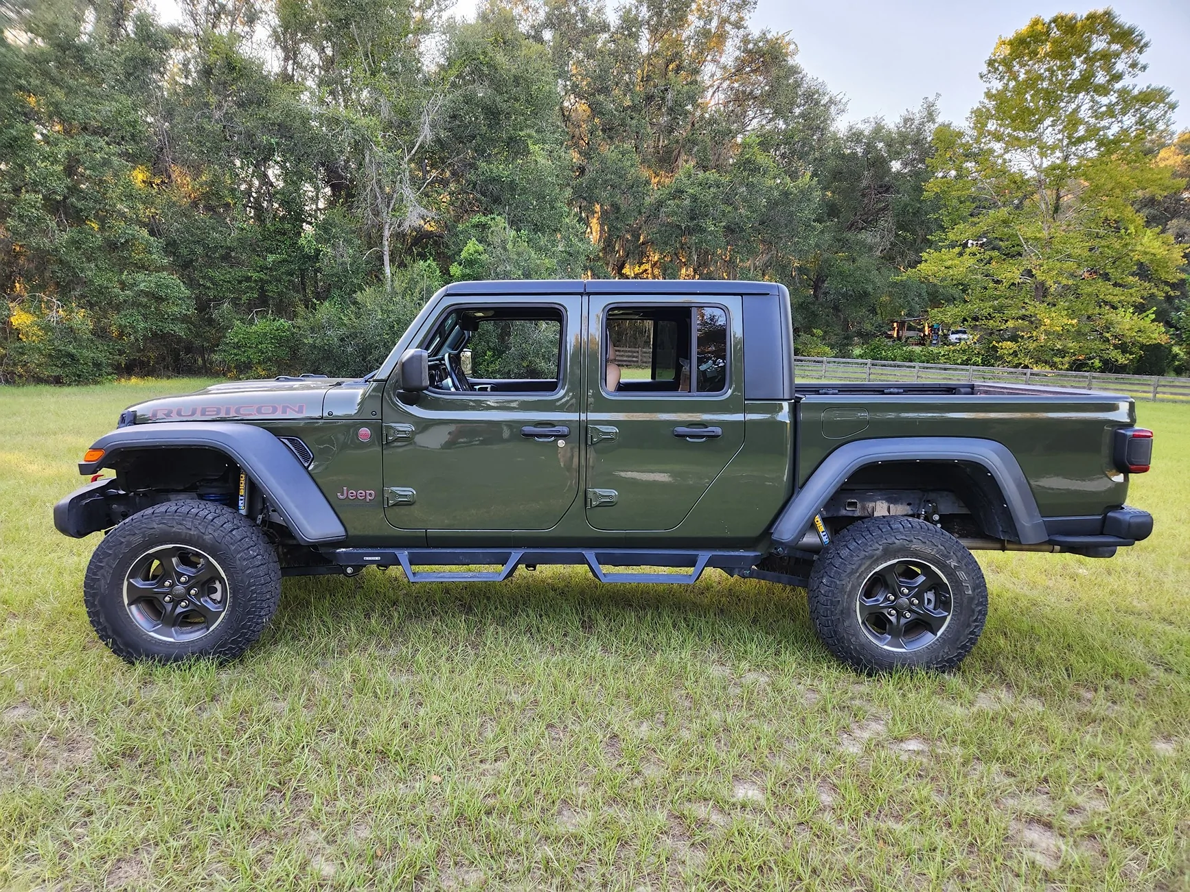

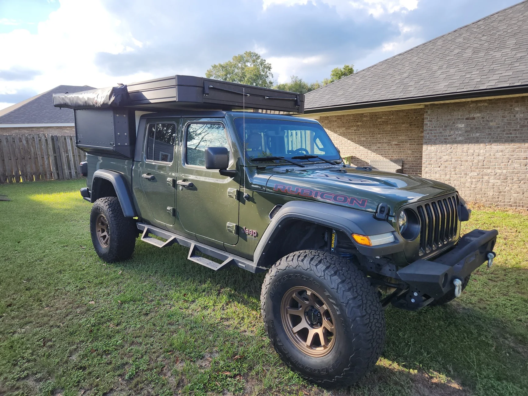

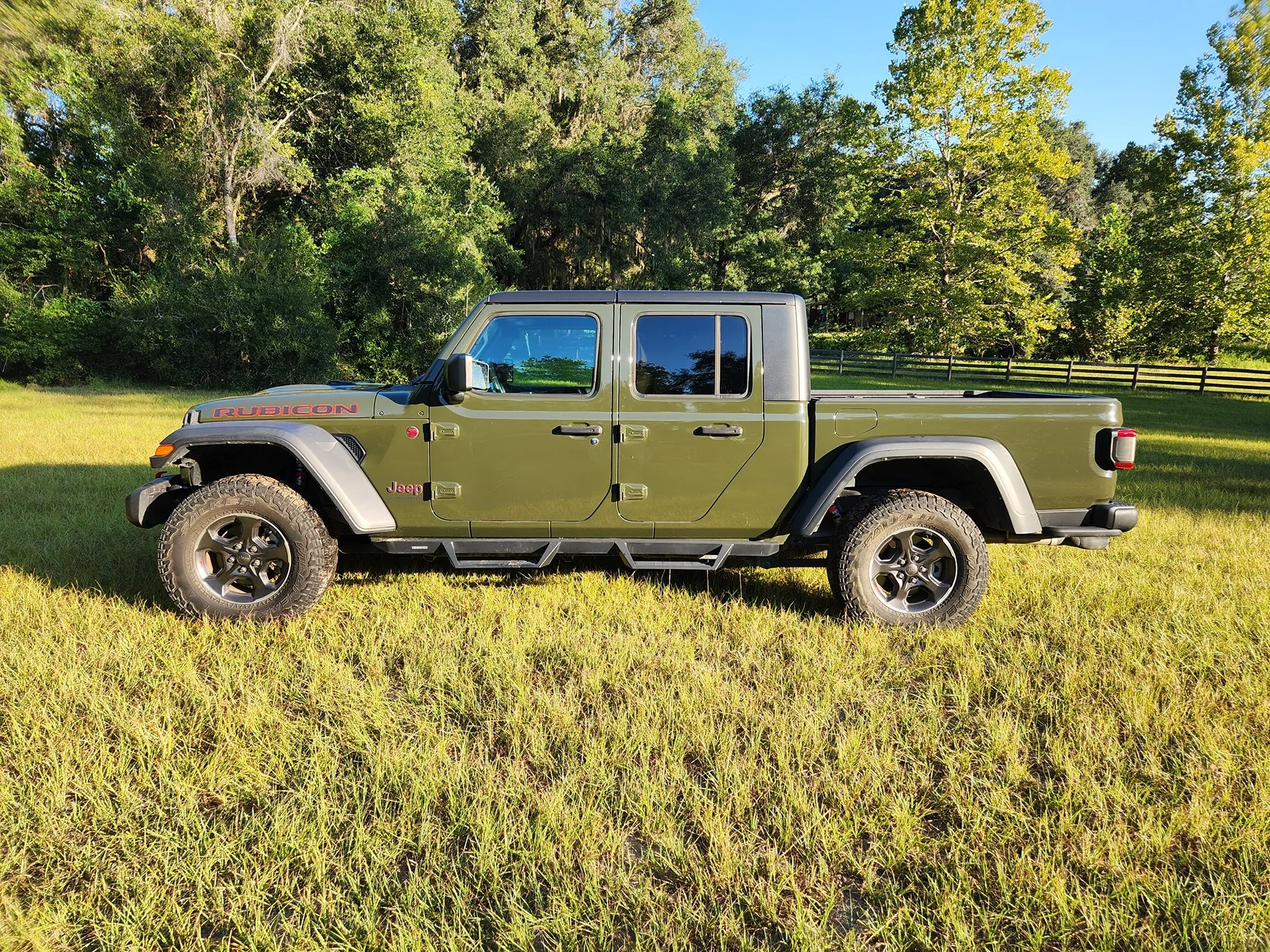

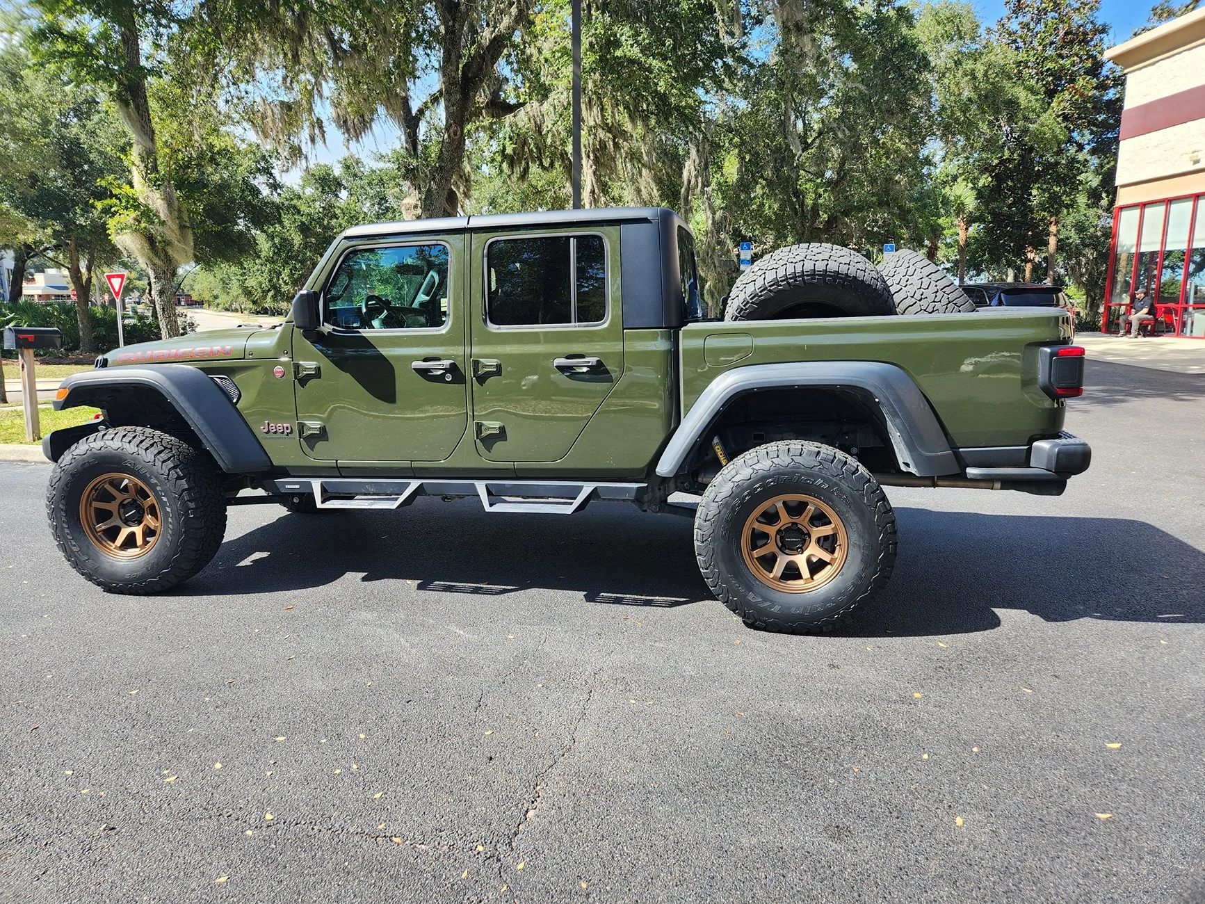

2022 Jeep Gladiator Rubicon 3.6L V6 purchased October 31st of 2024 with 23,XXX miles.
Jeep Gladiator LawDawg's Retirement Overland Build 20250915_082644
The Lift
AEV DualSport 3" with HD Springs
Jeep Gladiator LawDawg's Retirement Overland Build 20250915_185529
Rims and Tires
17' Vision Flow 9" wide -12mm Offset
BFGoodrich K02 37X12.5/17

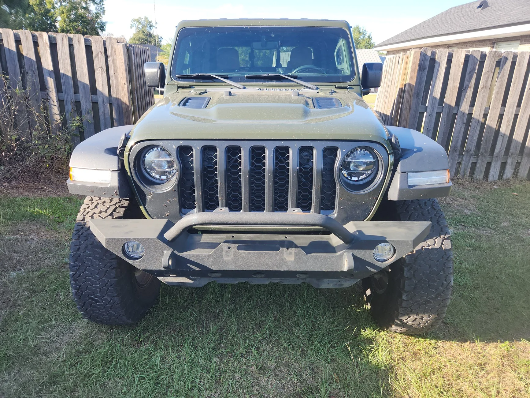

Front Bumper
Dunno. Bought it used from a friend.

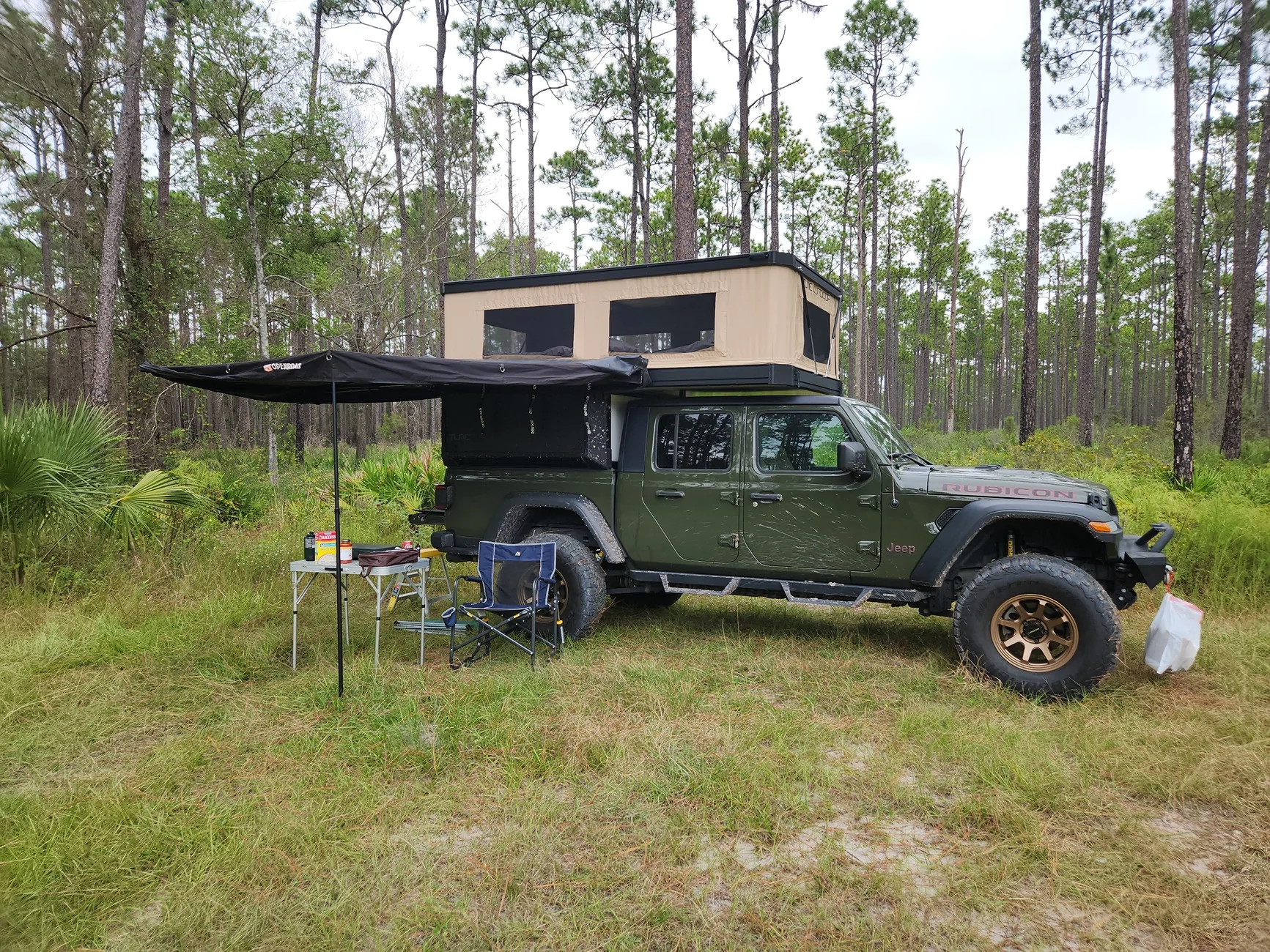

I retired on October 1st of this year at 46 after 25 years of law enforcement, never to work again. I've been traveling southeast Appalachia since 2015 in the back of a Jeep JK, WK2, and now the Gladiator. I've done ground tents, wall tents, roof top tents, and even off road trailers. Now, I'm going to build something that I can wake up in the morning in a heated space, stand up to get dressed, wash dishes, watch TV, etc., all inside. I plan to travel the entire country, including Alaska, plus Canada, without an itinerary. Now it starts.

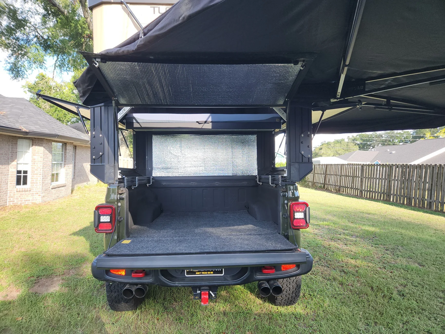

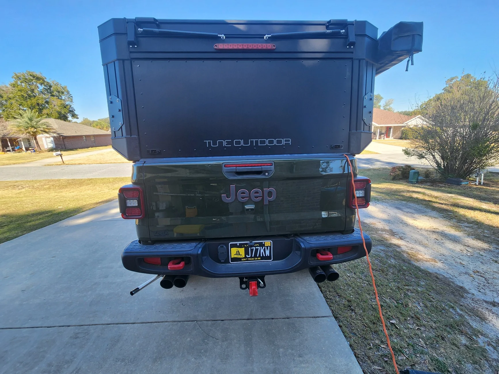

The Camper
TuneOutdoor M1
Jeep Gladiator LawDawg's Retirement Overland Build 1bb18352-5f7a-4ace-a71d-50abd7cf6df
Jeep Gladiator LawDawg's Retirement Overland Build Jeep3
Jeep Gladiator LawDawg's Retirement Overland Build Jeep8
Jeep Gladiator LawDawg's Retirement Overland Build Jeep7

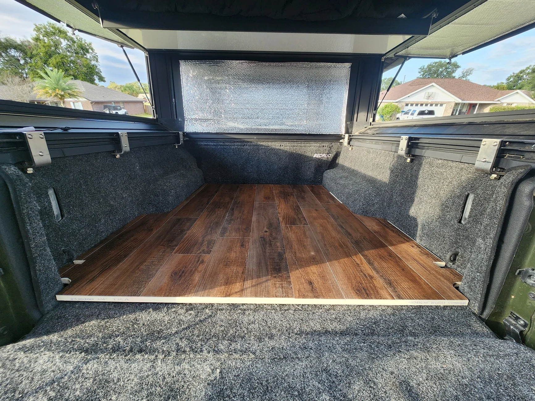

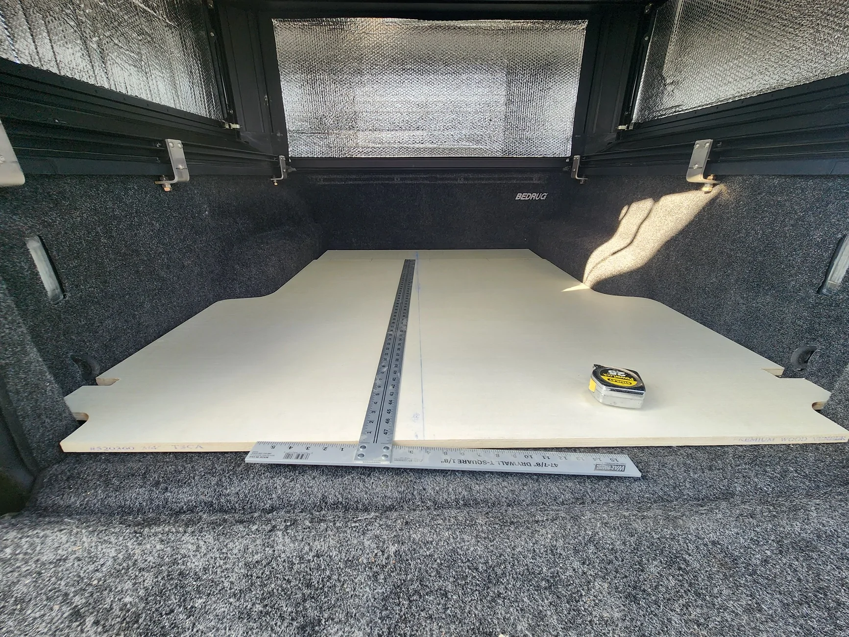

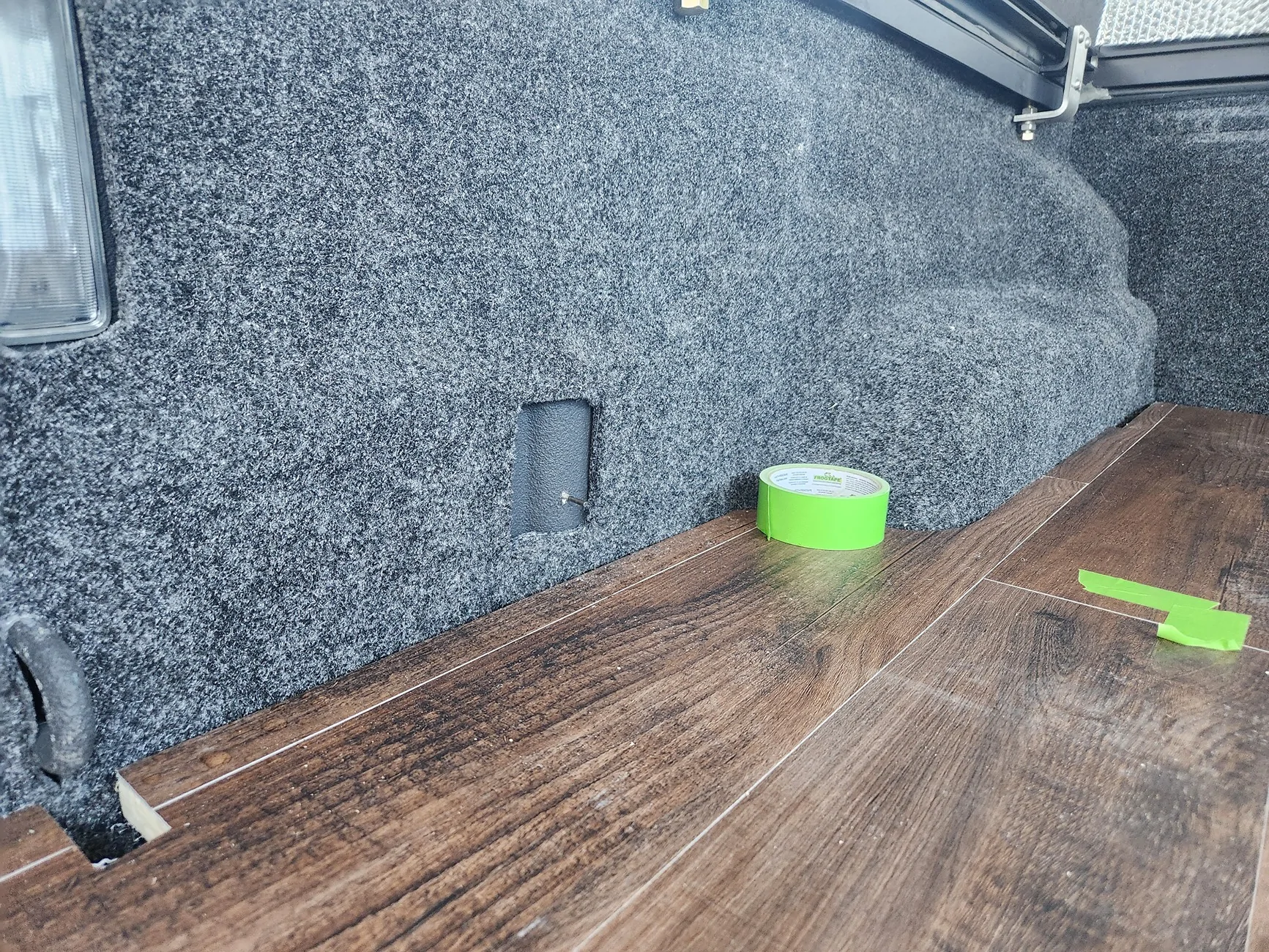

First is the floor.
Jeep Gladiator LawDawg's Retirement Overland Build 20251029_161225
Jeep Gladiator LawDawg's Retirement Overland Build 20251029_172902
Next will be the diesel heater.
To be continued...

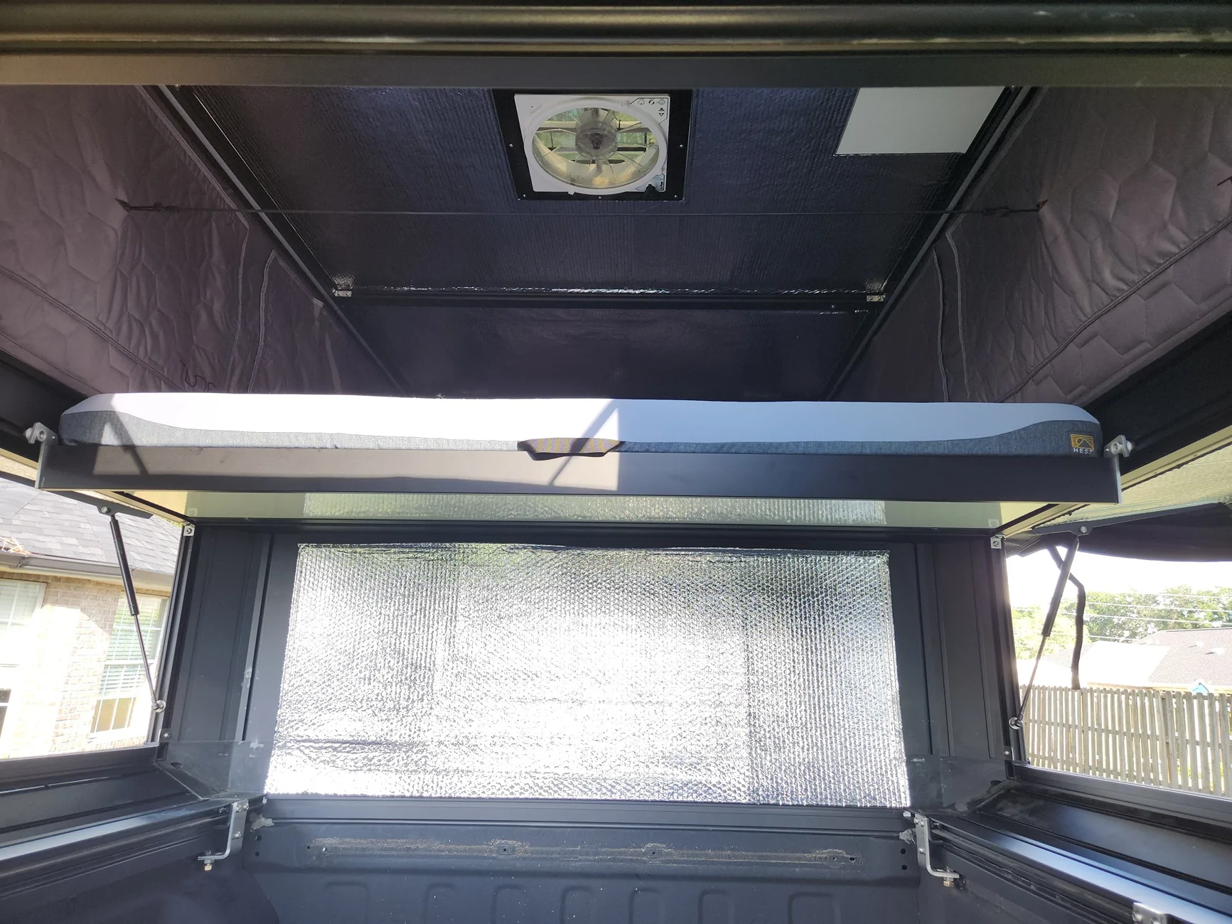

Looks like you got the king extension? How do you like the whole camper? I've been chatting with Tune Outdoors for a few months now and I'm pretty sure I'll order one eventually. Subscribed for updates!

I bought it used. I was dead set on getting an Ovrlnd Camper, but this was a deal that couldn't be beat. It was built in June, so is practically brand new. Differences in these style of campers really boils down to construction styles. I do like the Tune in that it is not made of just 1" tubing. The long runs are probably 6" wide, making it very stout. One drawback of the Tune over the Ovrlnd is that I cannot sit up in bed. In the Ovrlnd, the top is much taller. I'm 6'. My wife is 5'3" and has no probably sitting up. It did come withe the King extension and the Hest mattress. I make the bed with sheets and a comforter. So much more comfortable than a sleeping bag.

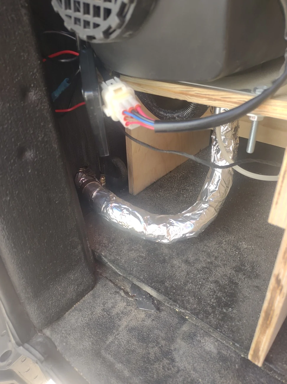

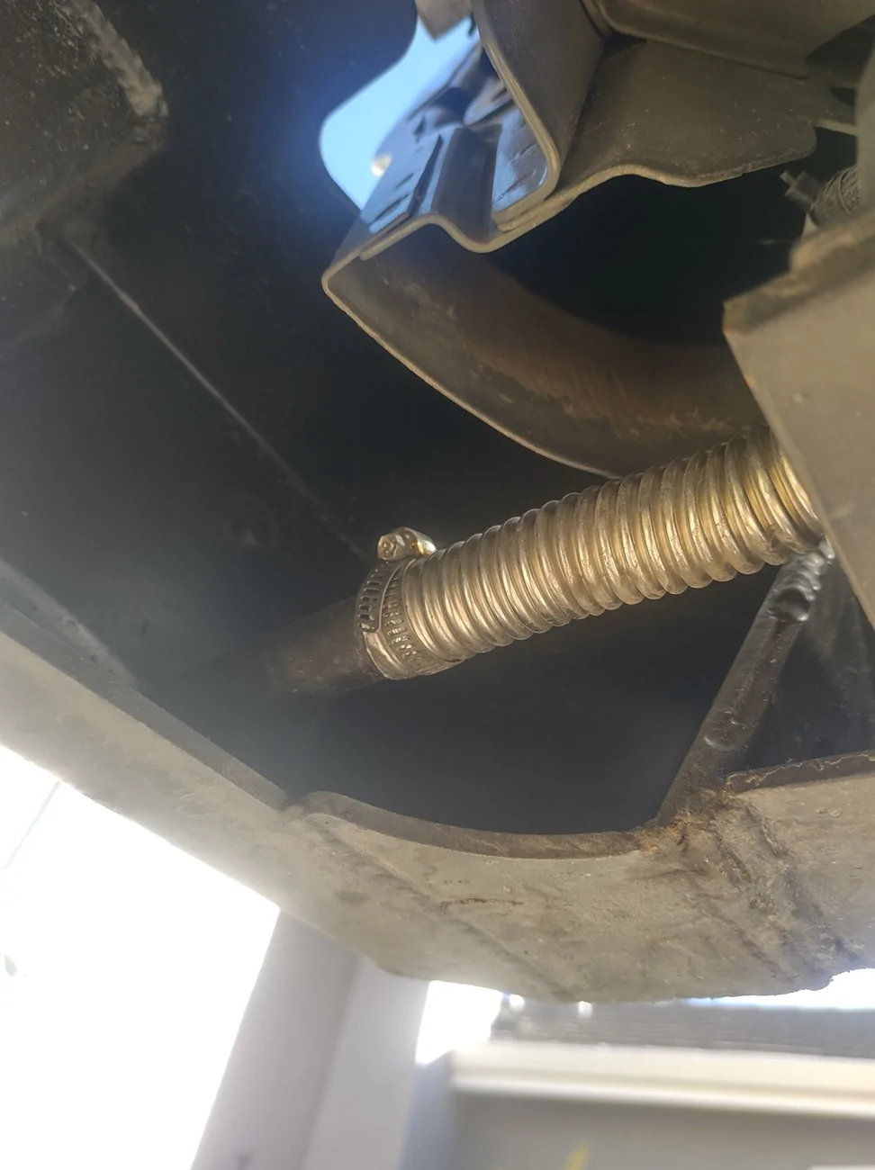

I'm expecting delivery of the Hcalory ToolBox Max diesel heater this Wednesday. This will be installed inside nearest the tailgate on the driver's side. I will be drilling a 2" hole in the bedside to route the side exiting exhaust, which will be wrapped. For the cabinets, the driver's side will bench height, while the passenger side will be countertop height for the sink and cooktop. I'm not decided if I want my 45 quart fridge installed at the front of the bed in front of where the 10 gallon vertical water tank will be or if I want it in the cab on the seat delete.

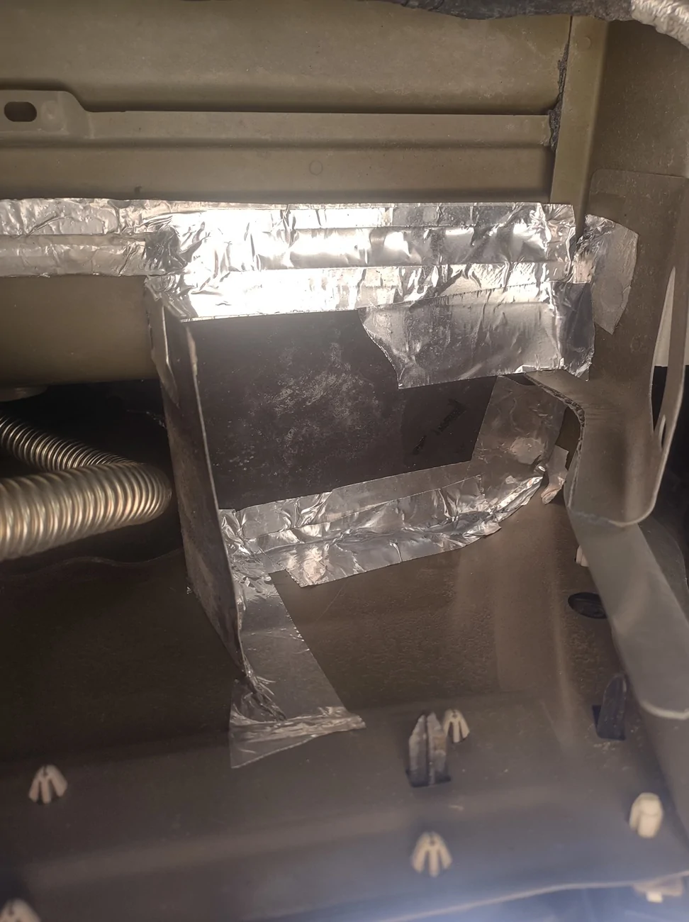

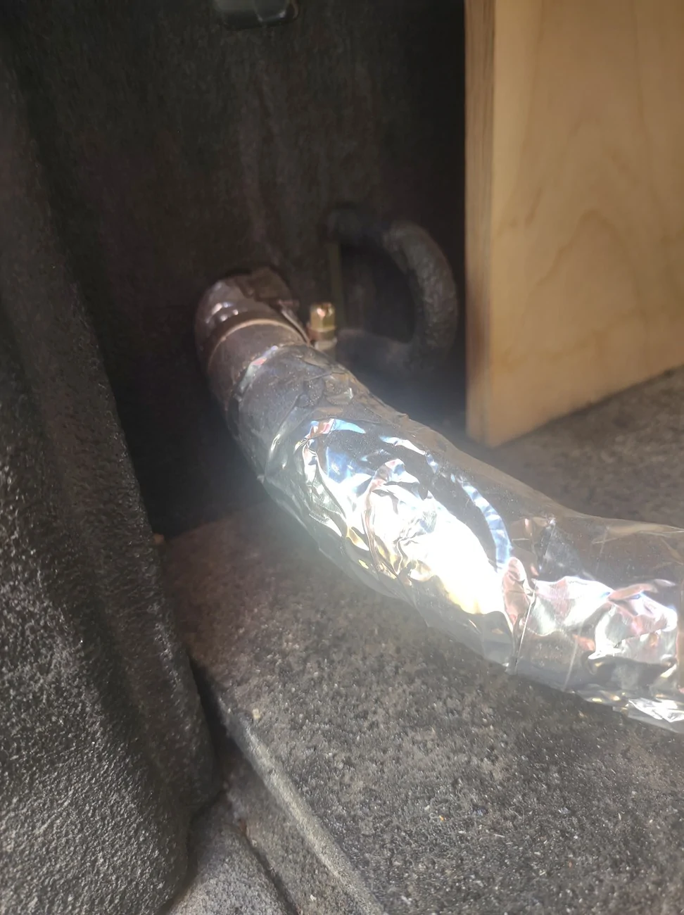

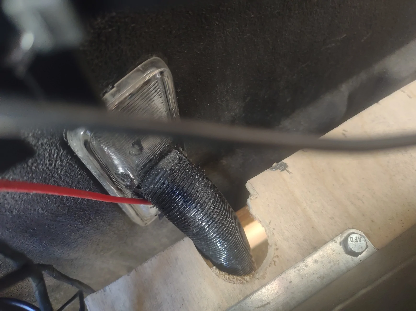

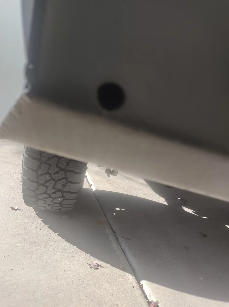

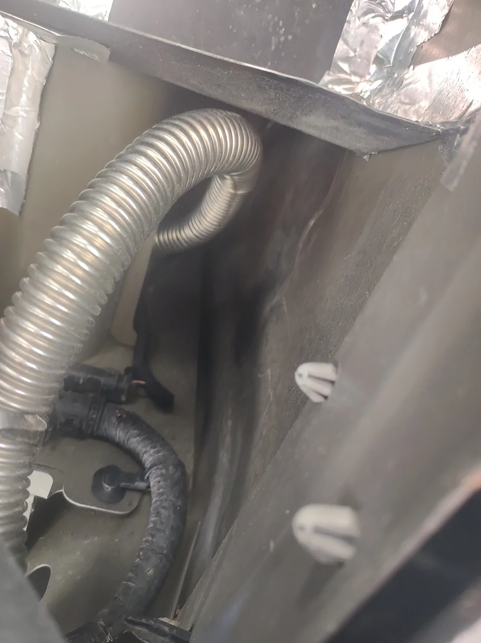

So on my diesel heater. I took out the bed light for my intake and the exhaust is routed through I believe a 1 3/8 hole. Then routed it down and out to the bumper which is my exhaust. The intake side I bought a second light and drilled it out ran high temp silicone to seal it. The exhaust side was drilled through the bed and down the area between the walls of it. In the picture with aluminum tape. That is the intake side. Blocked off from the tire spray etc.
https://www.jeepgladiatorforum.com/forum/threads/ovrlnd-camper-roll-call.66940/post-1255212

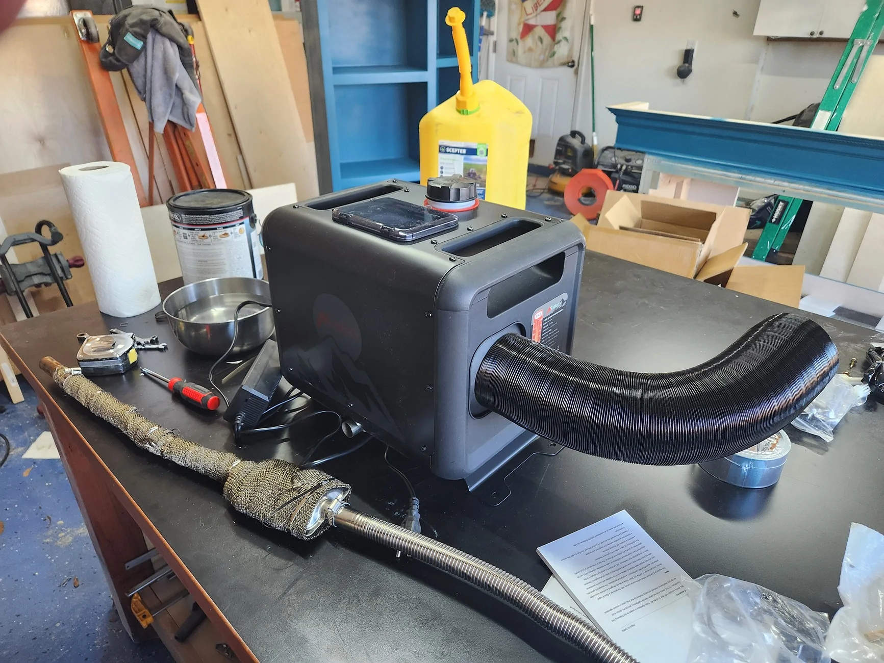

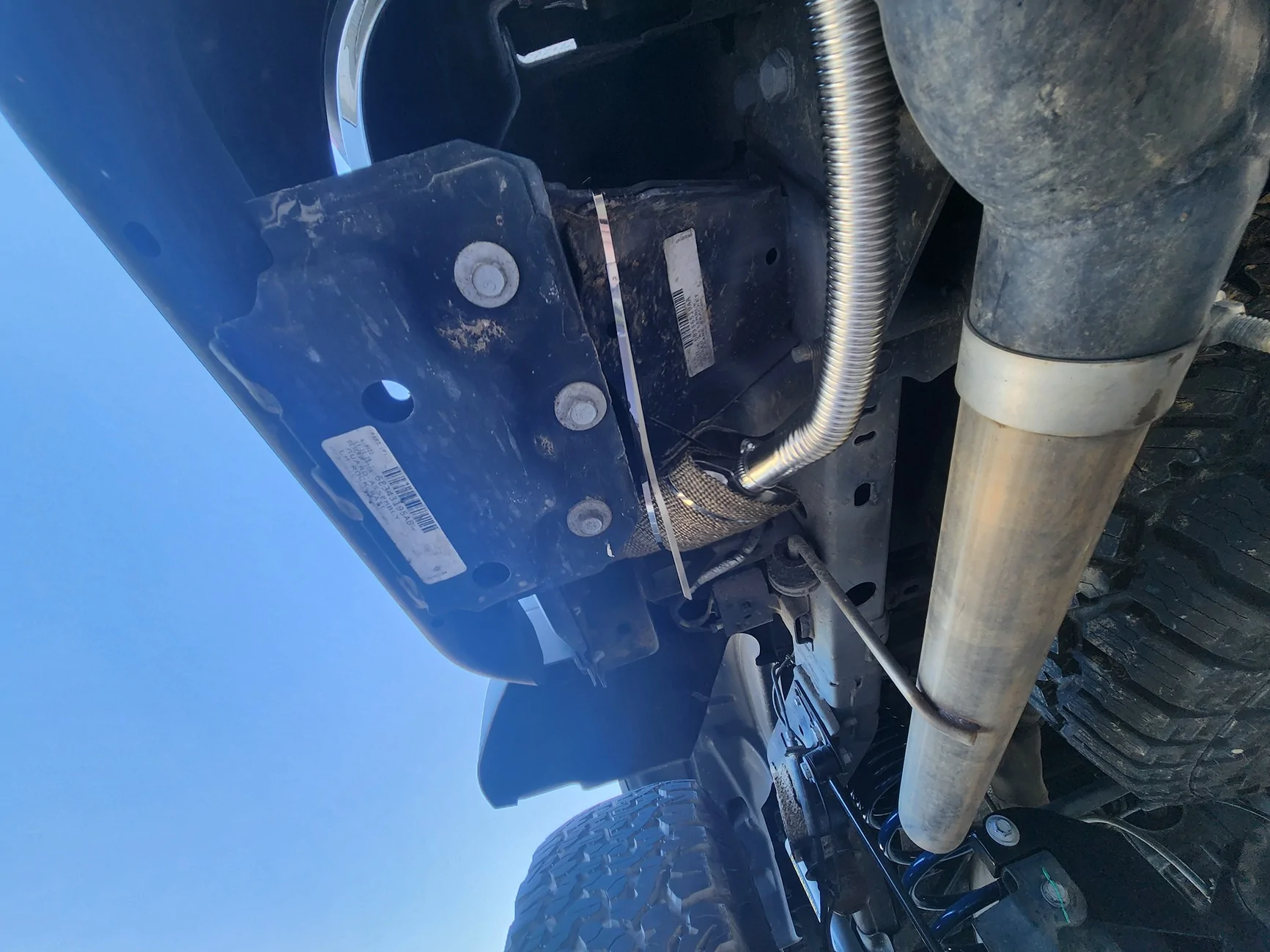

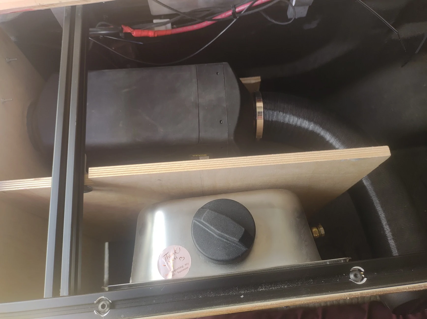

First, receive the heater.
Jeep Gladiator LawDawg's Retirement Overland Build 20251112_161807

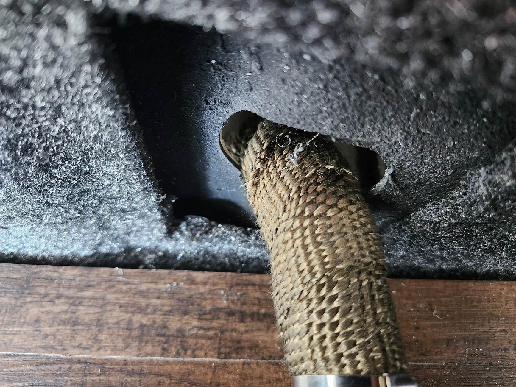

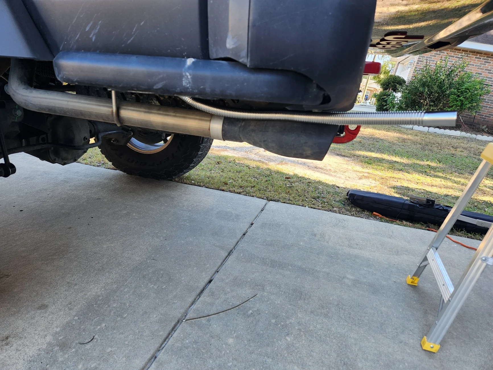

At this point, I've already appropriated the exhaust tube from my other diesel heater and wrapped the section that will go in between the body panels.

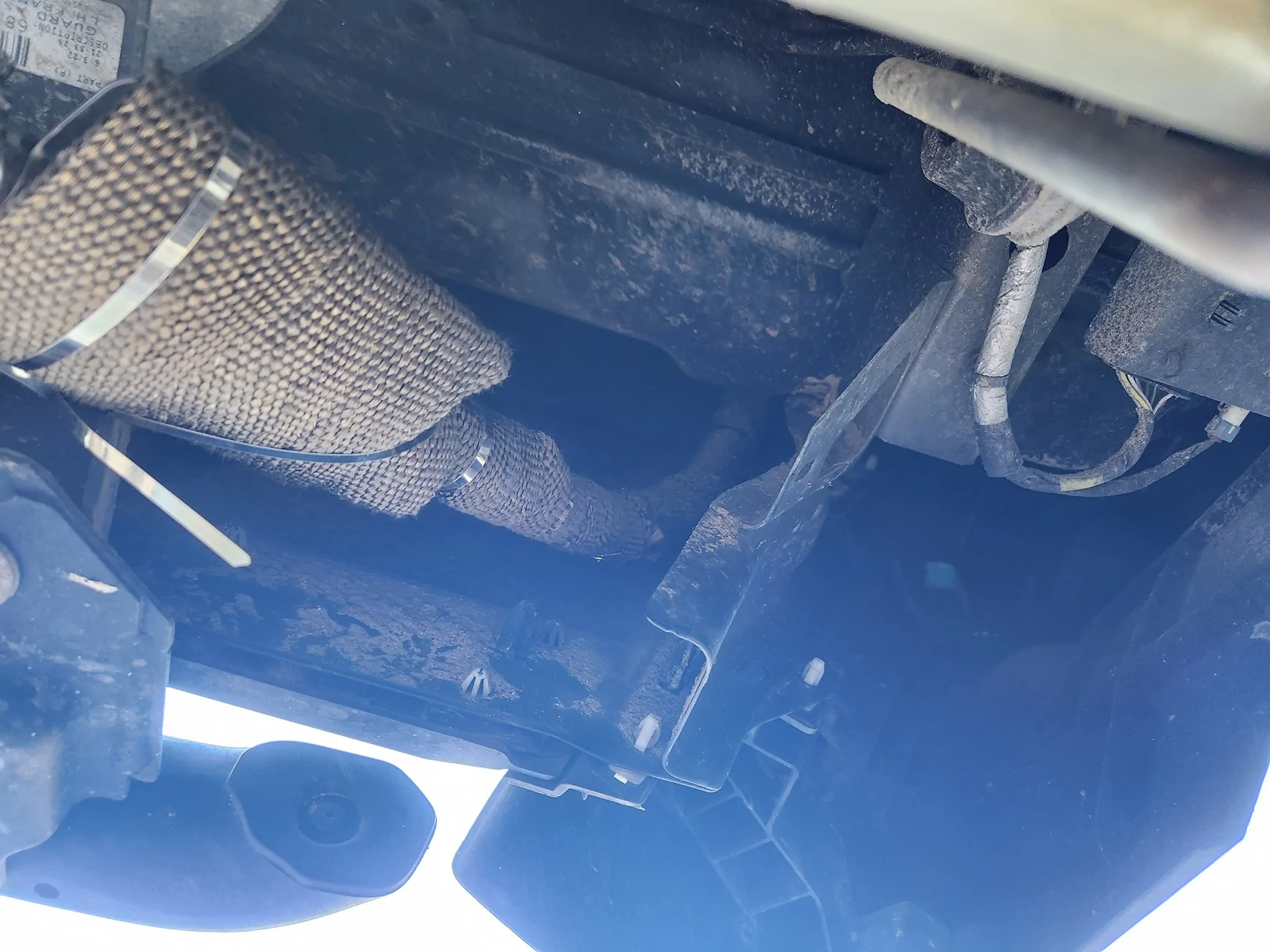

After determining its placement for the future cabinet build, the hole is cut to route the exhaust. Frightening.
Jeep Gladiator LawDawg's Retirement Overland Build 20251114_111750
Then, to see if I permanently damaged my very expensive toy.
Jeep Gladiator LawDawg's Retirement Overland Build 20251114_113701
Perfect. I then set in place the exhaust. I wrapped the joint to prevent an exhaust leak. I'll shortly find and buy some high temp mastic putty and just jamb 10lbs worth in there.
Jeep Gladiator LawDawg's Retirement Overland Build 20251114_120722
Jeep Gladiator LawDawg's Retirement Overland Build 20251114_115625
Jeep Gladiator LawDawg's Retirement Overland Build 20251114_115630
Not a lot of great options. Unfortunately, it was not a simple put in place and walk away.
Jeep Gladiator LawDawg's Retirement Overland Build 20251114_115611
For tonight, a test run with some friends, I'll just remove that second exhaust tube and reinstall at camp. This will be the way until I find a better solution.

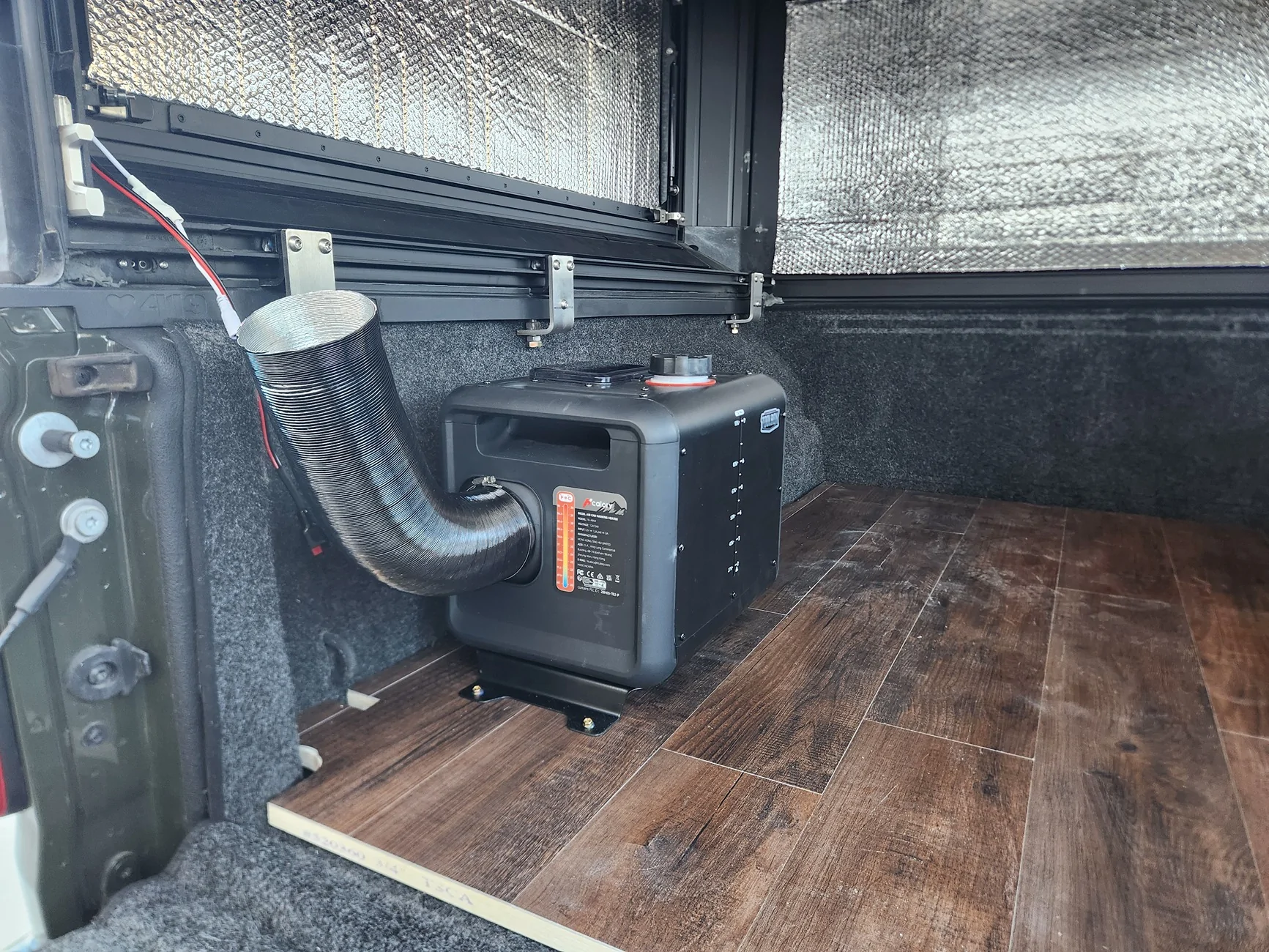

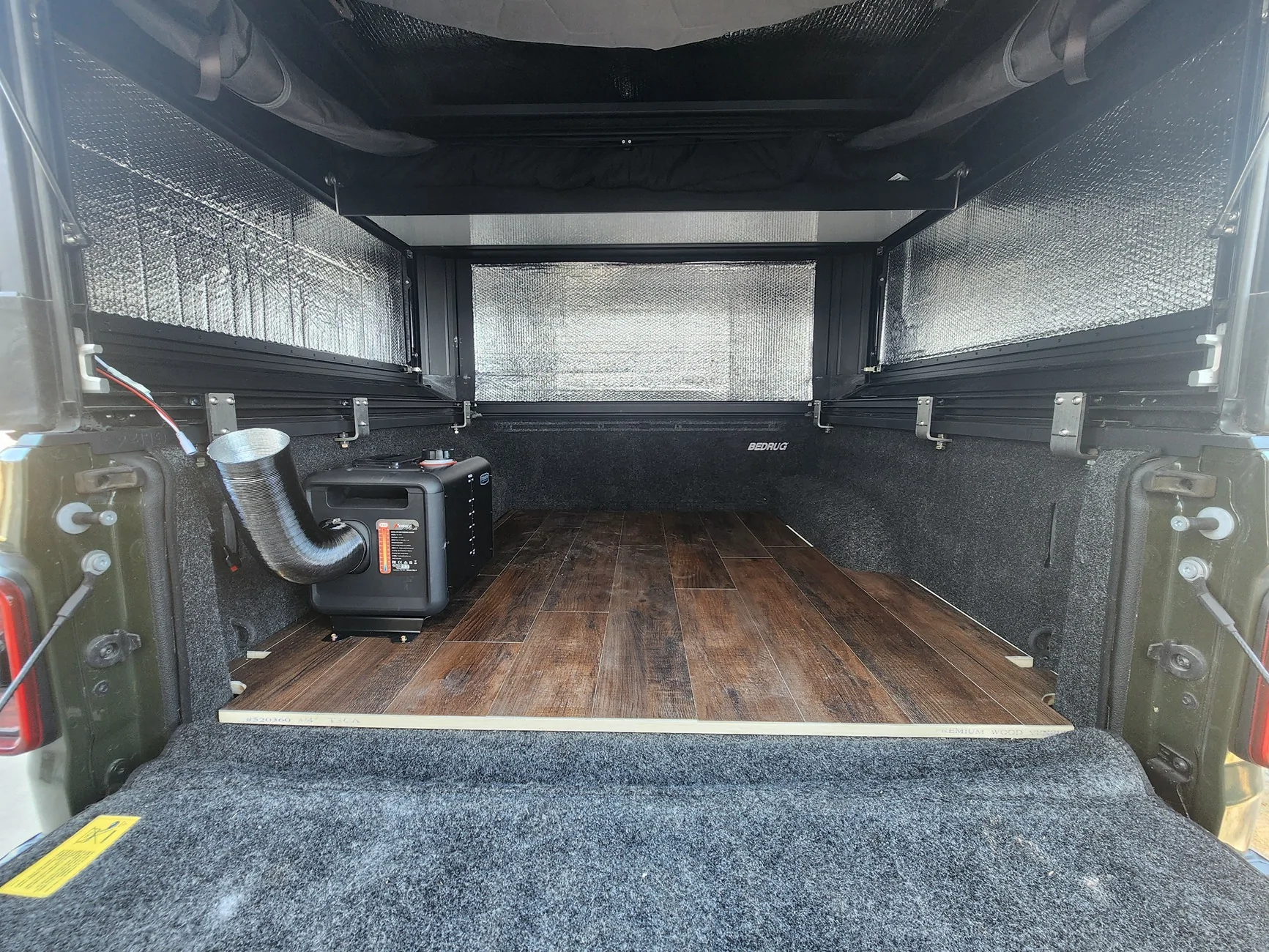

With that complete, it was time to permanently mount the heater itself.
Jeep Gladiator LawDawg's Retirement Overland Build 20251114_115455
This will fit nicely within the bench to be built.

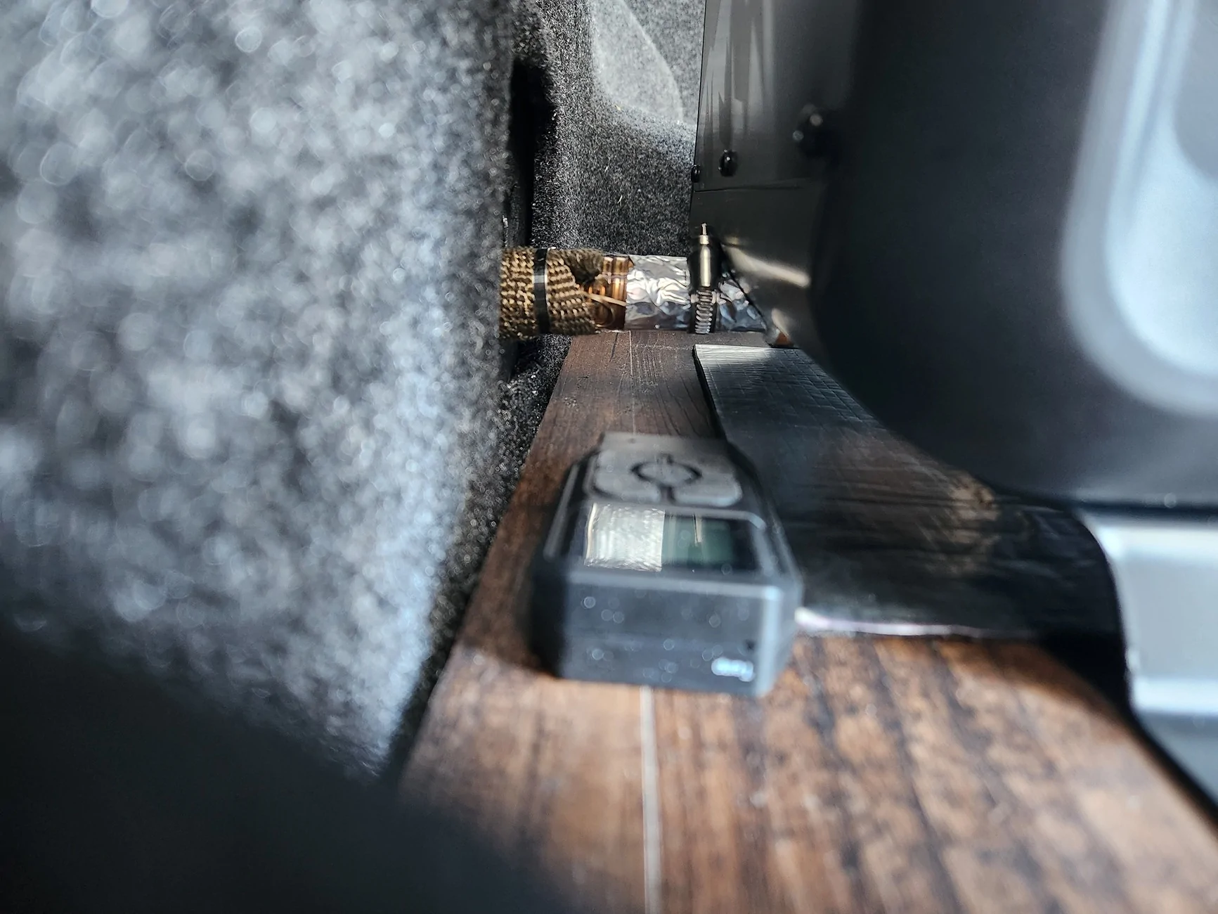

The first test conducted was that of the CO sensing remote. I powered on the heater and placed the remote at the tip of the exhaust. Within fifteen seconds, the unit threw a CO code and shut down. Now that I've determined the CO sensor works, I placed the remote next the exhaust outlet, buttoned it up, turned it on, and waited.
Jeep Gladiator LawDawg's Retirement Overland Build 20251114_121754
I put it on high and it stunk. Once it burns everything off there will be no smell. But, the remote showed 0ppm of CO after about ten minutes of running.

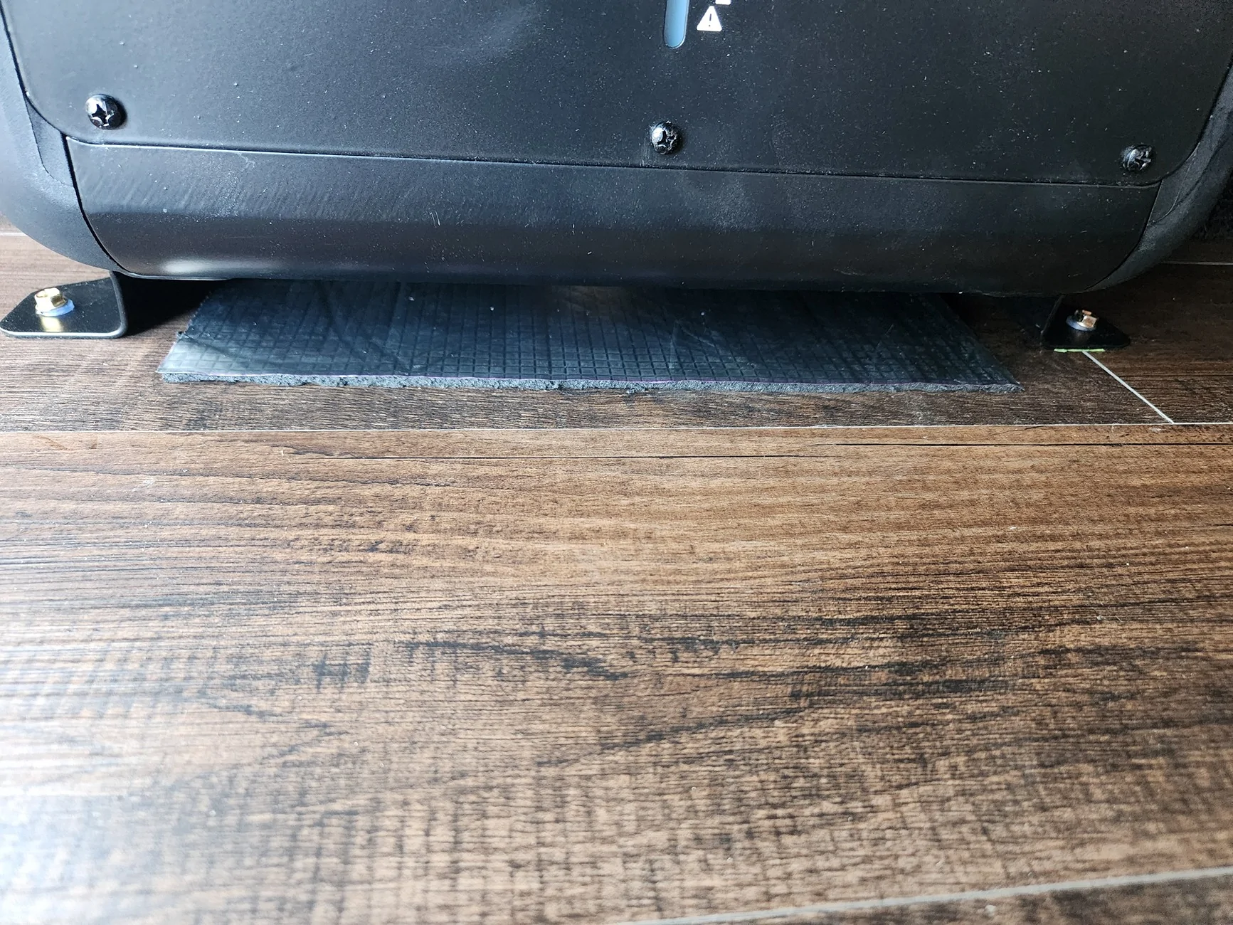

I also put down a heat reflector for you naysayers. And, it didn't even warm up after running.
Jeep Gladiator LawDawg's Retirement Overland Build 20251114_120635
So, there it is. I can now enjoy going out while slowly building it out.
Jeep Gladiator LawDawg's Retirement Overland Build 20251114_115600

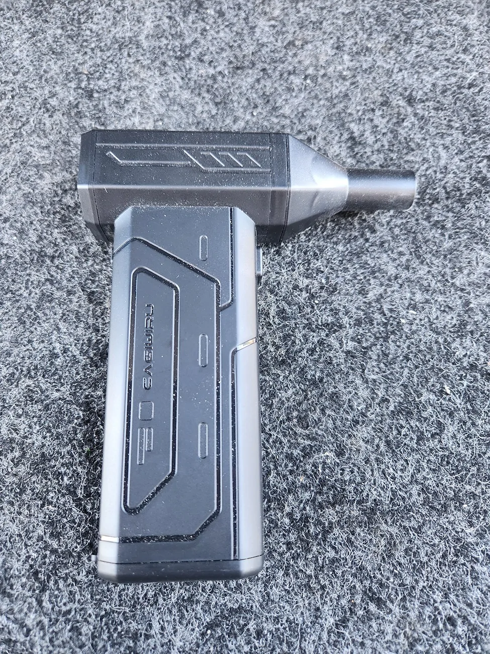

And if you don't have one of these little computer dusters off Amazon, you need to get one. They move a lot of air and are great for blowing out the Jeep.
Jeep Gladiator LawDawg's Retirement Overland Build 20251114_121412
Till next time...
