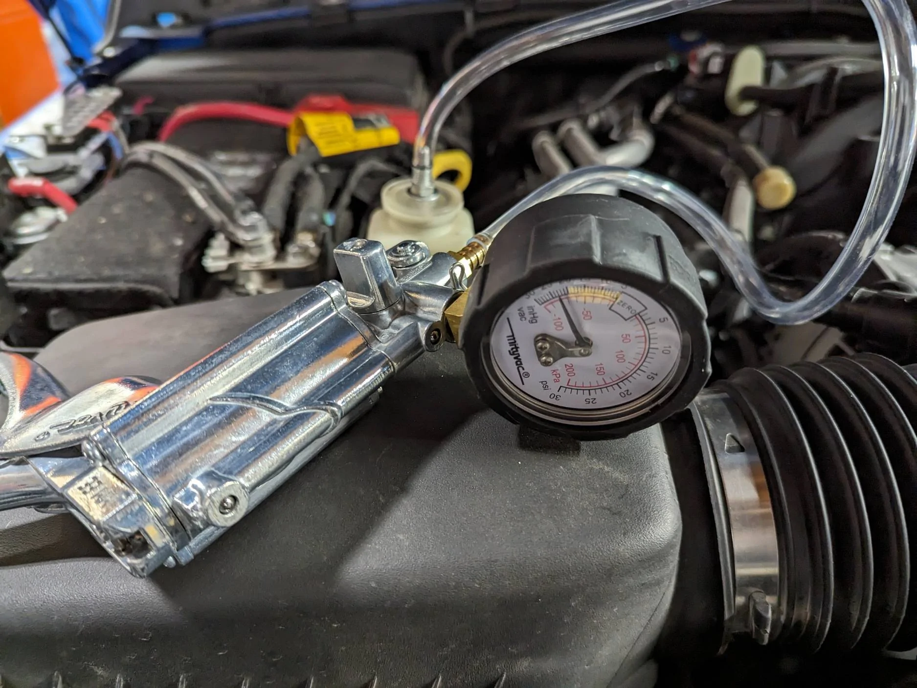

And don't forget to get the MOPAR EHPS fluid. Don't use other generic PS fluid. It's not cheap but frankly, I don't trust other stuff in my expensive steering parts (and quite necessary steering parts!) I'd only use something that meets MOPAR specs but I figure - why bother messing around. You will need fluid.
This is my setup proving my PS system has no air in it - it's how FCA says to bleed the air out after the system has been opened.
