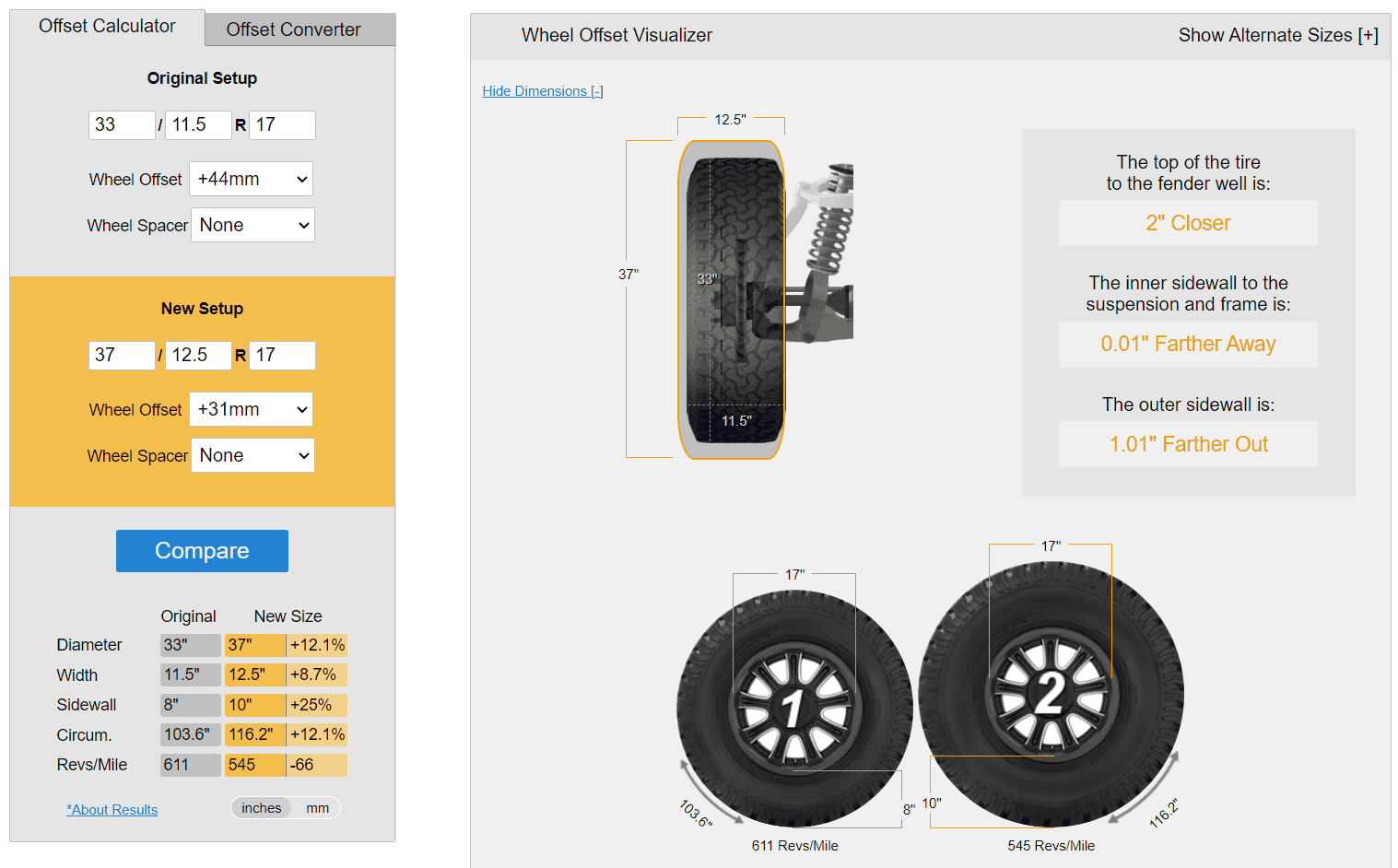

For every one inch of wheel / tire width you add, you want to increase your negative offset by a half inch (13 mm) to stay at or near even.
Stock Rubicon rims are +44 mm and 7.5" wide. Stock tires are 11.5" wide.
Stock vs +31mm and 12.5 wide
Note that all of the added width ends up to the outside, because the offset was reduced accordingly.
