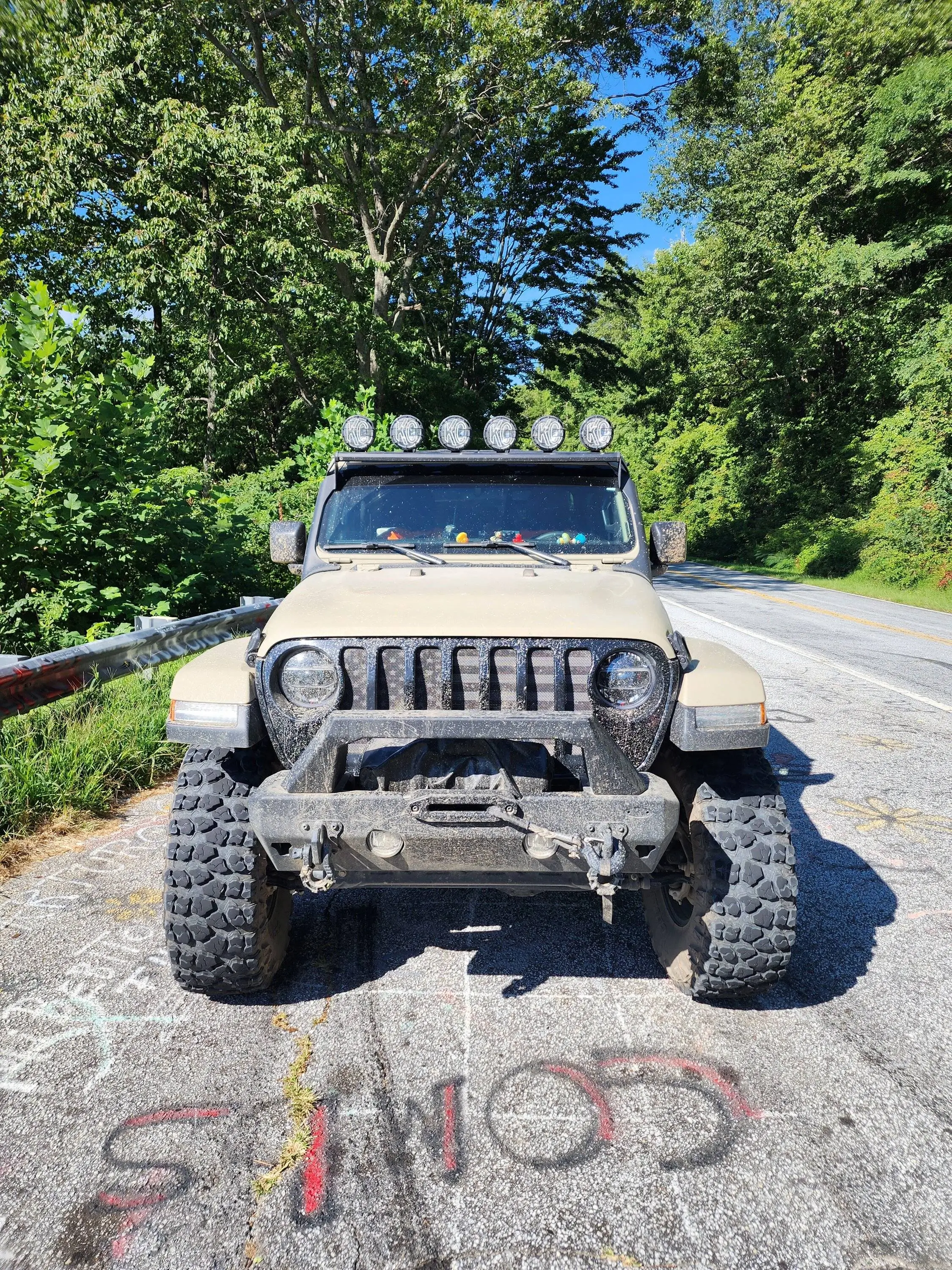

Efg84
Eric
Jul 17, 2021
Leesburg, Ga
2021 Jeep Gladiator Mojave
I have a 2023 Jeep Gladiator Willys Sport with the tow package and i want to replace tire with larger ones. I am thinking 33-12.50-17. I have a level kit and 2 inch spacers on now. Does anyone know if the stock rim width will fit or cause problems with a tire size listed above.
I have a 4" lift with 2" spacers. 37" mounted on stock Willys rims.
Good looking rig! Nice and aggressive! Thanks for sharing!
