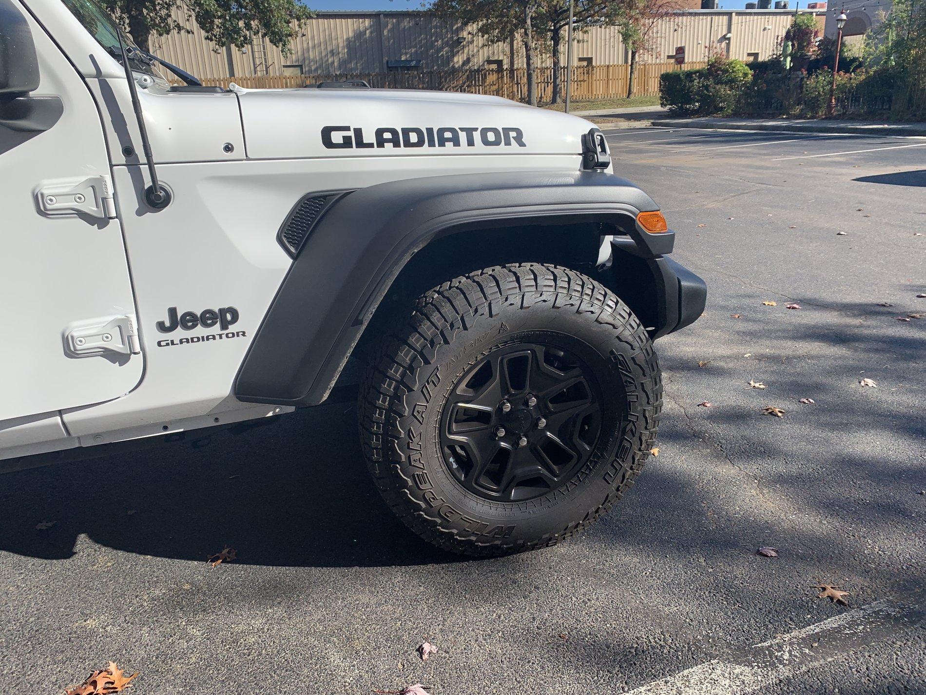

I am running 275/70/18 (33" tire) on 18x9 wheels. The wheel backspace is 4.5". Means the wheel sticks out about 4 inches farther then stock. Stock sport S. on turning the wheel, the tires hit the plastic on the damn between the front bumper and the fender.
Sport S with max tow
Using a lower backspace wheel, you should be able to run 33" without trimming. Maybe 34's.
Disadvantage to 18's - tires are less readily available at a decent price. Stick with 17's. (went with 18's to use on my grand cherokee, but sold it and kept the wheels. really good deal on them)

Thanks for the pic -- looks great! Do these rub at ALL? (lock-to-lock turns? offroad?)
danielspivey
Daniel
Sep 7, 2019
52
1,074
1,162
Central Virginia
2020 MAX TOW MAX TOW MAX TOW, 4.10s w 1583 payload
Thanks, these tires actually handle better and are quieter than the stock tires, and handle better than Michelin’s that came w rubi rims when I bought them. Quiet wise same as michelins.
no rubbing and didn’t have to remove that piece between the bumper and fender.
I run 35 psi and the steering stability is like night and day vs. stock tires and high psi
Note: if you go wider than 285 most tire manufactures will not recommend putting on a stock rim, therefore most shops won’t install. Also I imagine if you went bigger than manufacture suggested and you had an accident or blow out you’d be screwed...

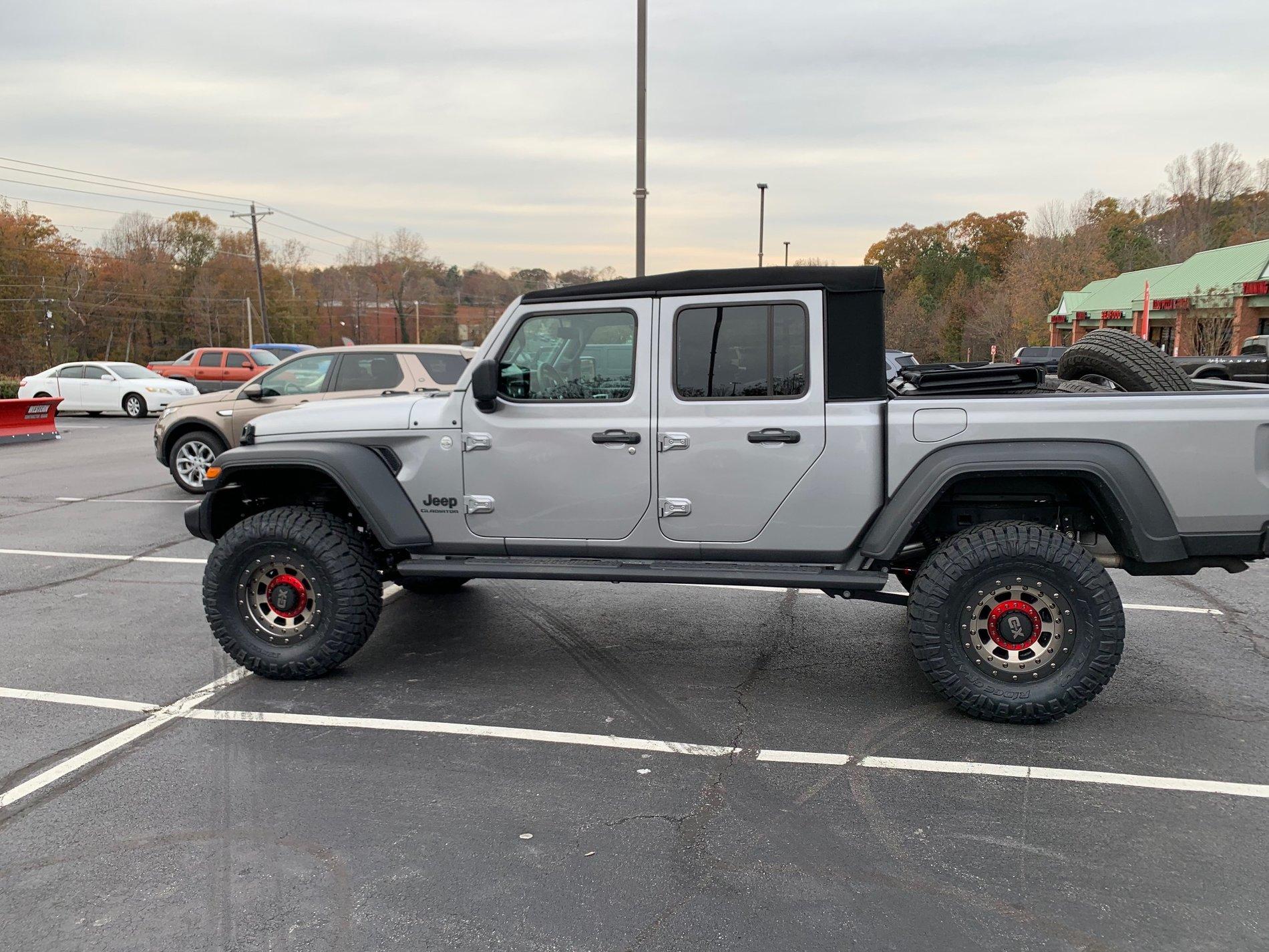

I am running Nitto Ridge Grapplers 35x12.5x17 on KMC XD137 with Offset of -6. They don't rub at all but I do have a 4.5" SkyJacker lift on my Sport. The Ridge Grapplers are expensive but they are a good ride with limited road noise.
