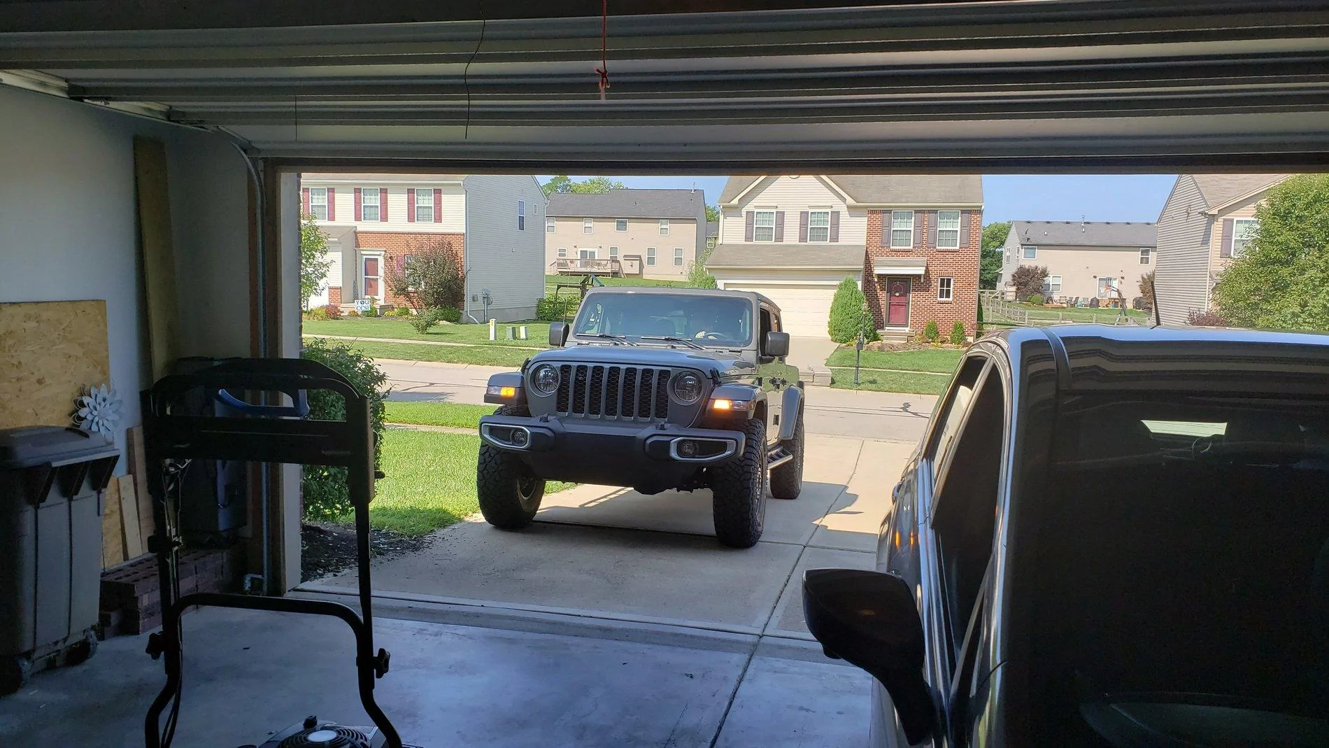

Alot of tire sizes are metric so you have to do some math. On a 285/75/17 tire 285 is width, 75 is the height of half the tires cross section as a percentage. 17 is wheel diameter.
You can figure wheel diameter by taking 285x.75x2+17=tire diameter.
I searched for rims and tires on websites based on size not vehicle. Figure out what you want in terms of tire size and backspacing. I went with stock backspacing for my aftermarket rims to keep the tires from sticking out too much from the fenders. You can browse many wheel configurations on the show and tell threads here and determine what you want for backspacing.
I went with a 17x8.5 rim with a 35x10.5" tire. The 10.5 width of the tire allowed me to run stock backspacing with no rubbing. On a 12.5" width tire you'll want the wheels out more for clearance.

That’s good information. It's stuff I already know, but worth repeating. I really like the look you got there, so did you just do 0mm offset when you say "factory."
