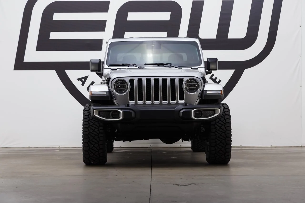

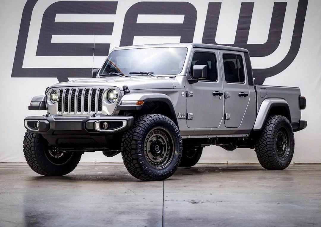

On another thread, I posted:
I couldn't figure out why the tires sidewall looked so small, should have known.
Per EAW:
"2'' LIFT, 35'' NITTO RIDGE GRAPPLERS, 20'' BLACK RHINO HARD ALLOYS"
A close up pic on their site shows these as 35x12.5r20
I removed the link as it's now dead, appears to be sold.
Glad my Black Rhino's are 17s.:like:

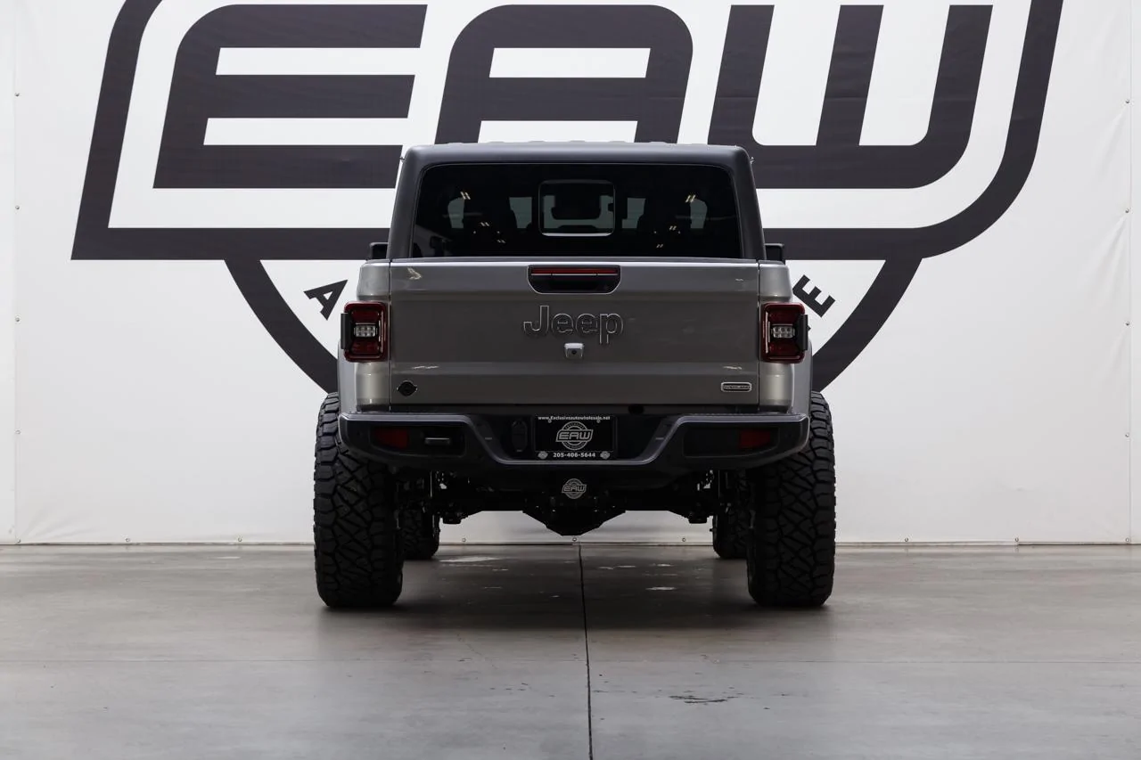

Are any of you worried about the rear driver side tire potentially hitting the exhaust? When I checked a few out the pipe was clearly visible. Made me wonder if putting 35's on would be a good idea or not, the tire would be damn close to the pipe, and the heat transfer may be too much.
I was hoping someone has already done this but I haven't been able to find anyone yet.
My Gladiator is ordered so i'm hoping I can get an answer before it comes in so I can have my 35's ready haha

There are pictures of 35s mounted in the spare tire slot under the bed.

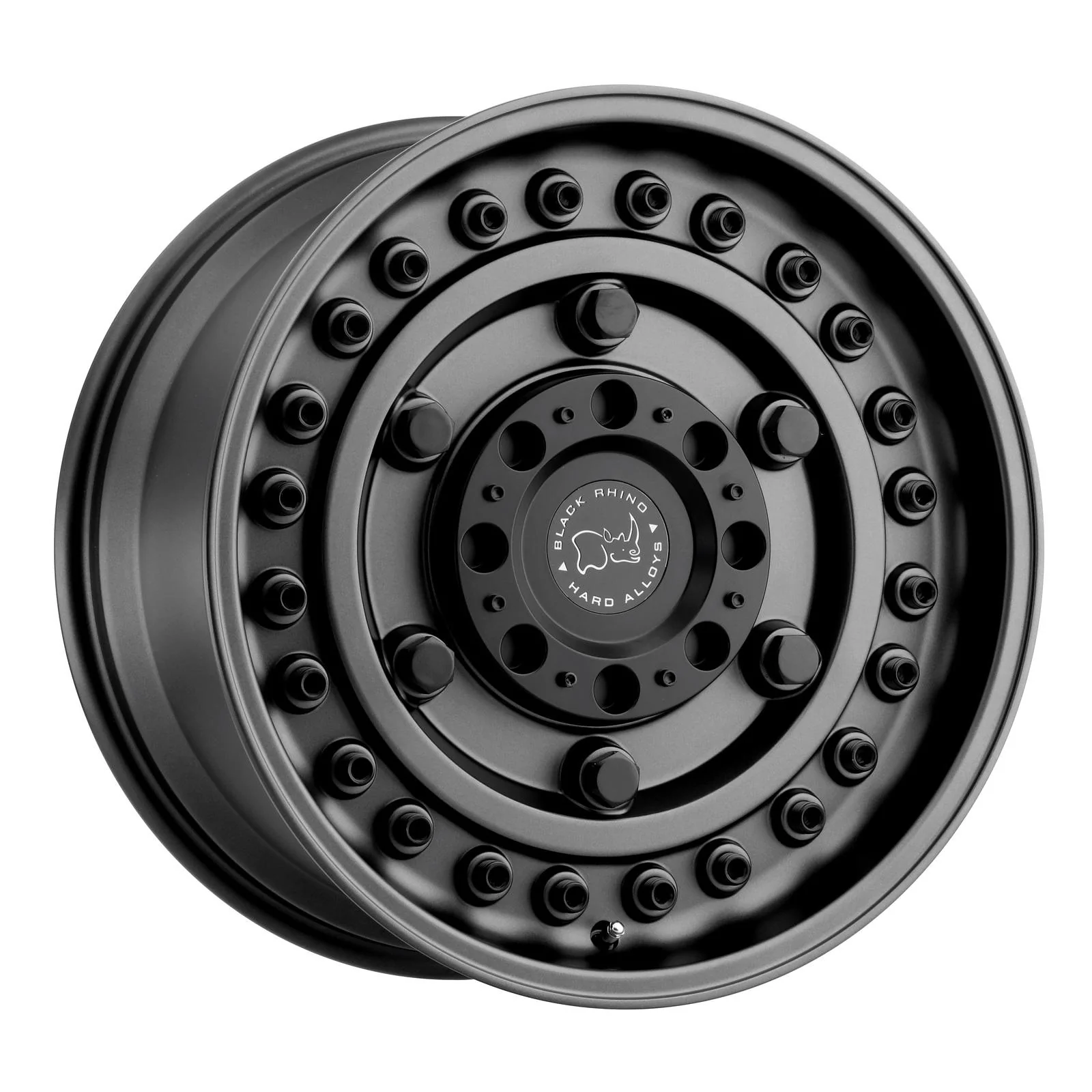

Black Rhino wheels are confusing to say the least.....I love the Abrams, but in the 17" wheel the "lip" is only about 2.5" deep. On the 18" and 20" wheel, the lip is 4" deep. I have NO CLUE as to how they do this since on that wheel (Abrams) they are ALL 9.5" wide, with a 4.54" backspace and an 18mm offset. I think the deeper lip on these wheel looks awesome, but the 2.5" wheel looses some of its appeal, and since I already bought the 35" Cepek EXP's i'm kinda locked in
