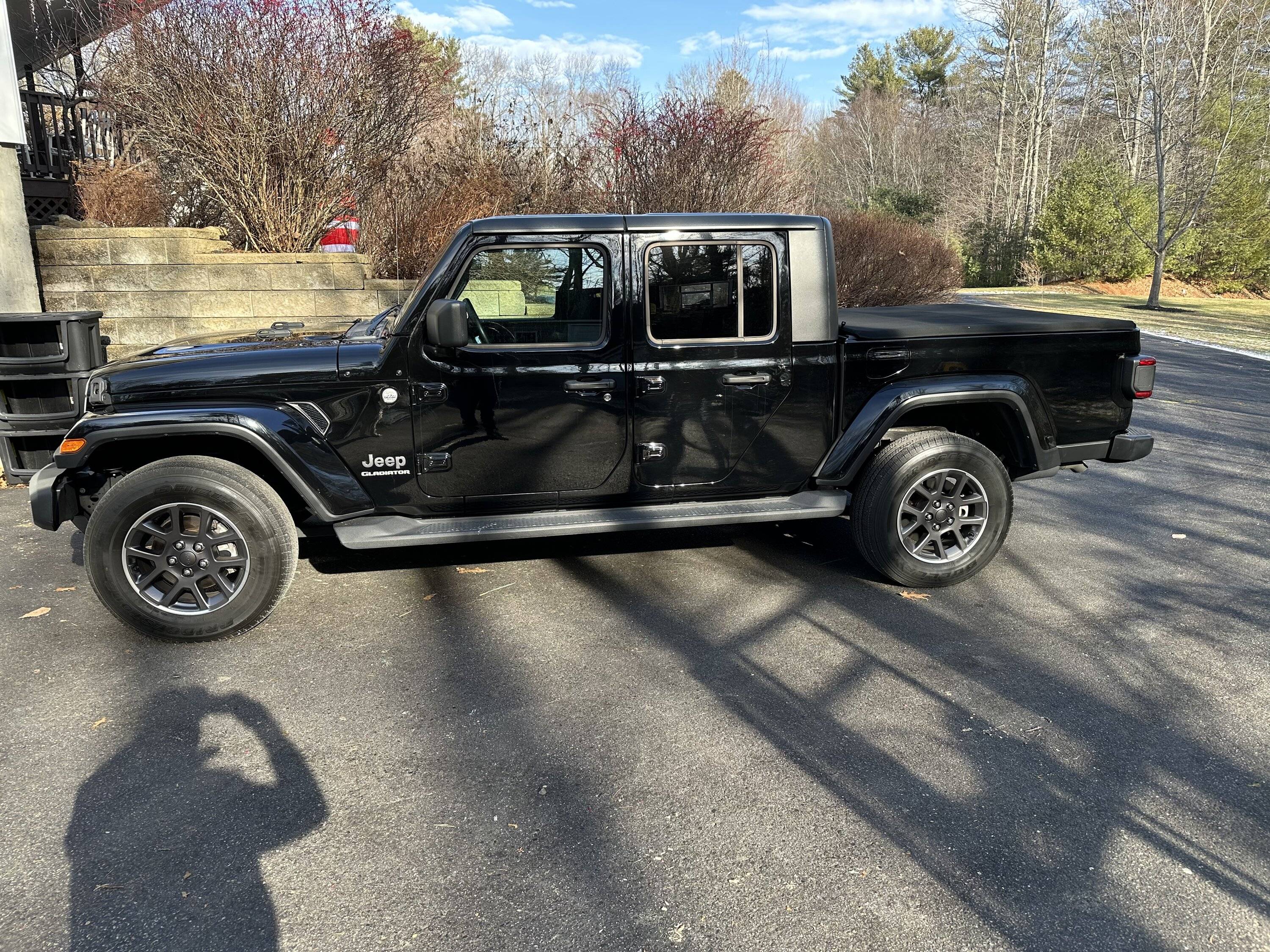

I just bought a 2020 Gladiator overland on Wednesday and need help with tire advice. I had aftermarket 20in rims on my Jeep Grand Cherokee that I traded in and want to reuse them on this truck. I would like to get the largest tire that can fit on the new 20in wheels without rubbing. I tried to research offset and called tire shops but no help so far. Does anyone have any advice on what tire could fit on the new wheel without any other modifications? The 20in wheel info is attached. Thanks all!!!

I think stock Gladiator wheels are +44mm and 7 1/2" wide. Switching to wheels that are +38mm and 8 1/2" will change the backspacing from 5.98" to 6.25". For an 8 1/2" wheel, you'll need to go to a +30 offset to maintain stock clearance on a stock suspension. Bigger tires and suspension kits would require more research on proper wheels.
