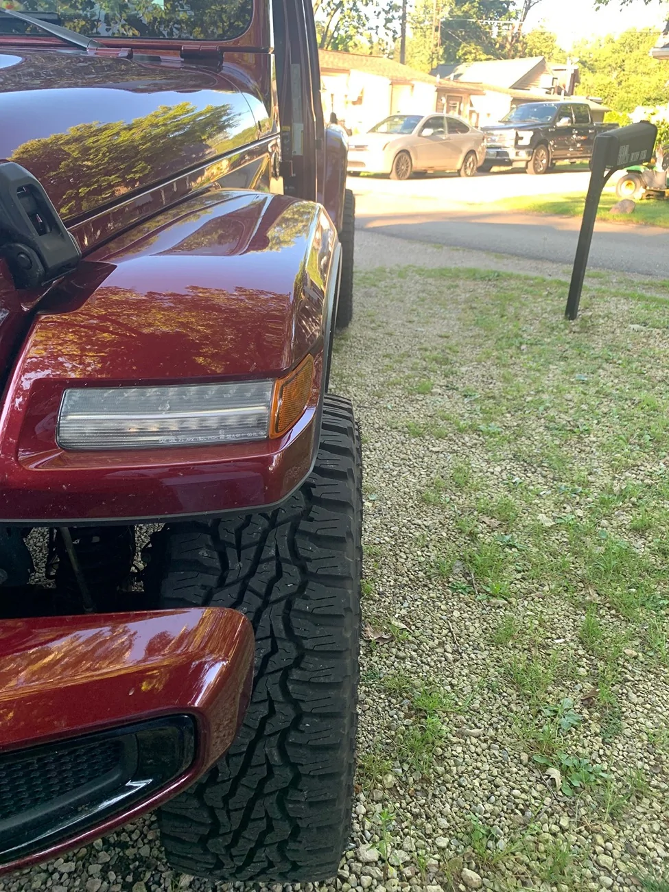

-18 will stick out a little more than 1-2".
I have +6 and 12.50 wide tires and mine are about 2" past the flare.
Oh man. I’ll have to look at the offset calculator today. I’m fine with a little poke, but don’t want to go too far. I appreciate the image to show it as well. Thank you.

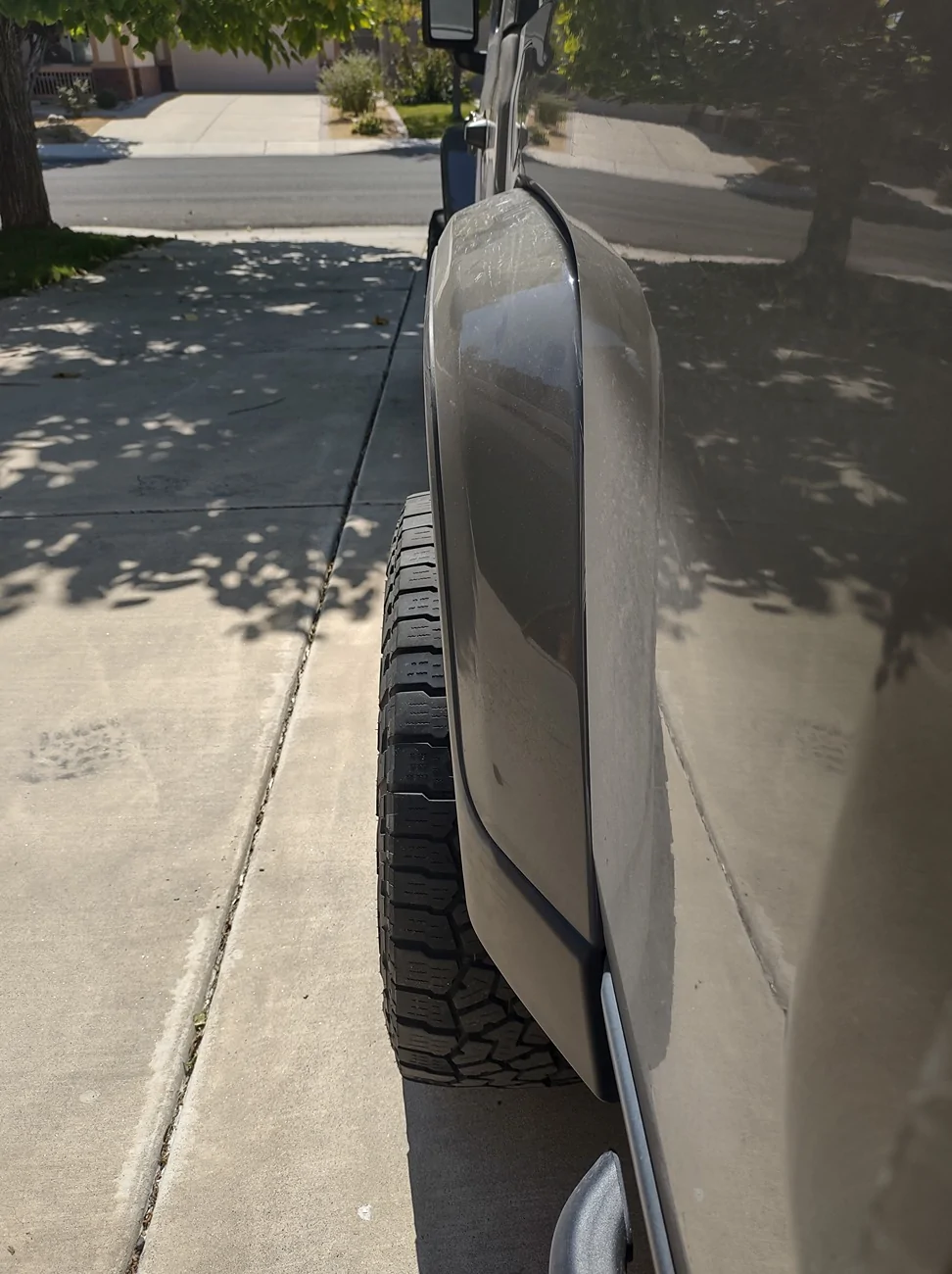

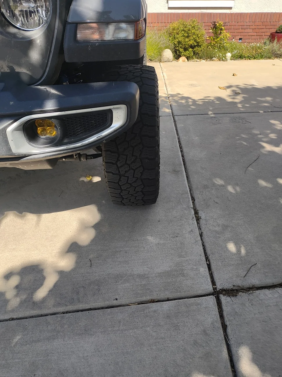

-6 Icon Rebound pros Rubicon take off tires
Jeep Gladiator About to join the club - wheel offset question IMG_20230919_134926353_HDR
Jeep Gladiator About to join the club - wheel offset question IMG_20230919_134859447_HDR
