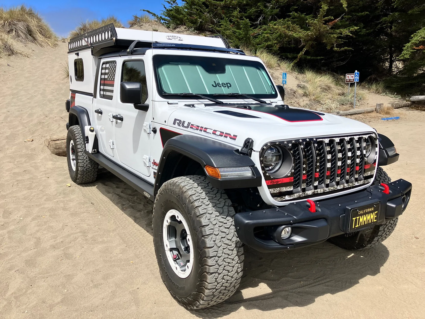

And she sits pretty level considering how much crap I carry!

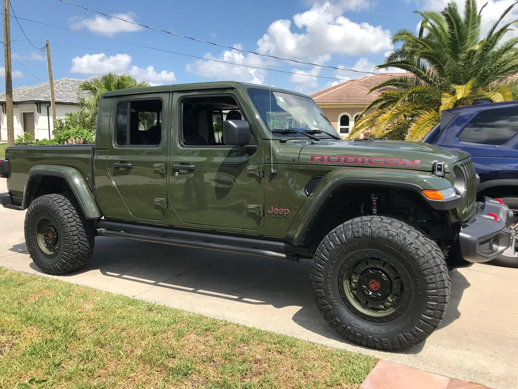

I’m running Black Rhino Abrams 17x9.5 -18mm offset wheels with Nitto Ridge Grapplers 35x17x12.50 on my 2022 Rubicon. There is @3 and 1/2“ of poke beyond the Rubicon flares.
what suspension do you have going on? Any other upgrades that affect that stance?
CVrubi
Jan 4, 2024
Florida
2022 Gladiator Runicon
I have a Rough Country 2 and 1/2“ spacer lift with bump stop and extender in the front and a 1 and 3/8” ICON spacer lift with bump stop and extender in the rear. I feel this even‘s the stance very well. I went with spacers because I wanted to keep the stock Rubicon shocks. To better the steering my Jeep mechanic installed a Metalcloak sector shaft brace, Metalcloak upper front control arms, Rock Jock 1 and 5/8” tie rod, Fox ATS steering stabilizer, and he adjusted the steering box and did an alignment. This made a huge difference in the steering with larger tires.

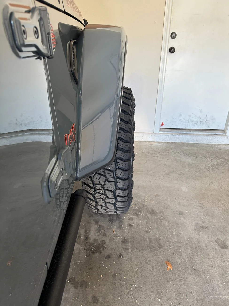

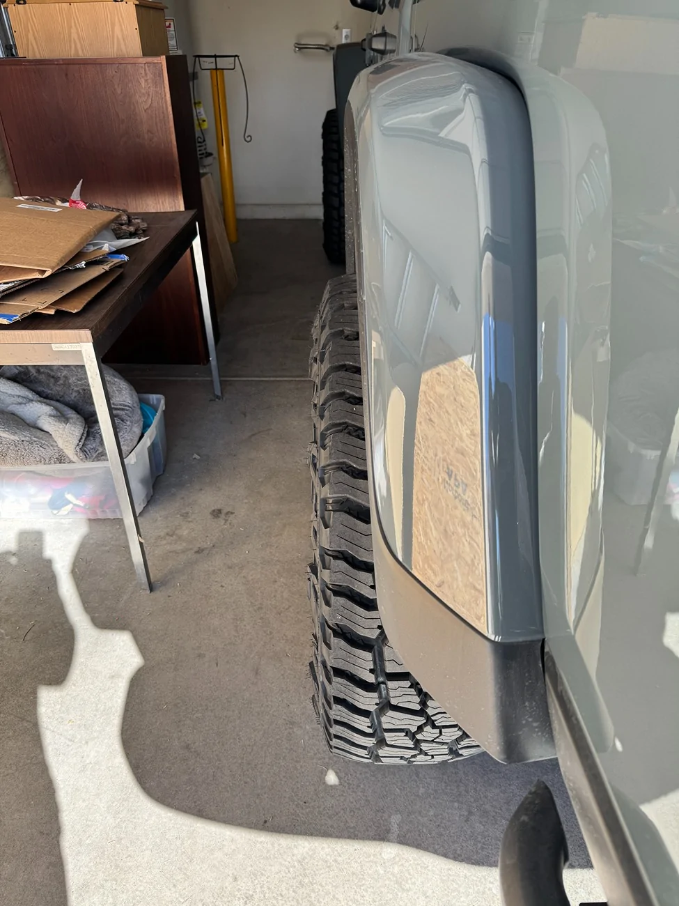

Mojave with 2.5" lift, 37x12.50 on 17x8.5" - 0 offset. -18 will move the center of tread outboard by 18mm or 3/4".
