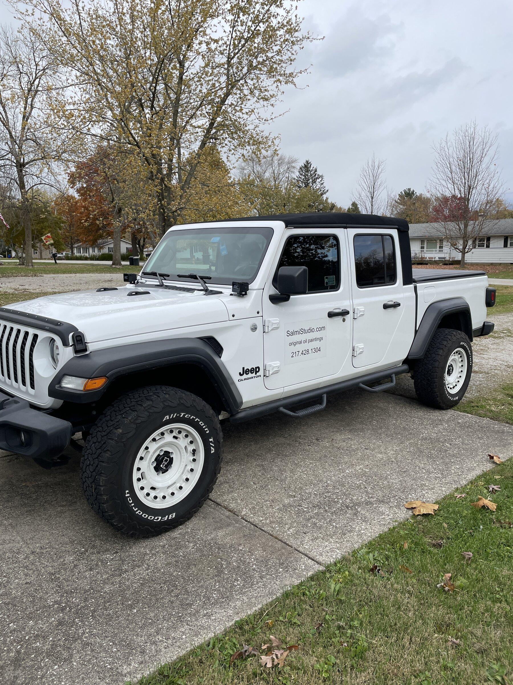

so someone mentioned that the Rubicon wheels have a different offset than a Sport S. Does that mean rims and tires from a Rubicon won't fit on a Sport S?
I'm not sure if the Rubi wheels are a different offset, I thought they were the same. The Mojave wheels have a different offset for sure. Rubicon wheels will bolt onto a Sport S or overland without issue (except maybe the plastic air dam if you have it). Many people on here have done it and I'm one of them.

Thank you! Did you have to take the air dam off so they don't rub?
No problem! I have colored flares so I never had the air dam, but I believe I've seen members say before they removed it when moving to Rubicon takeoffs

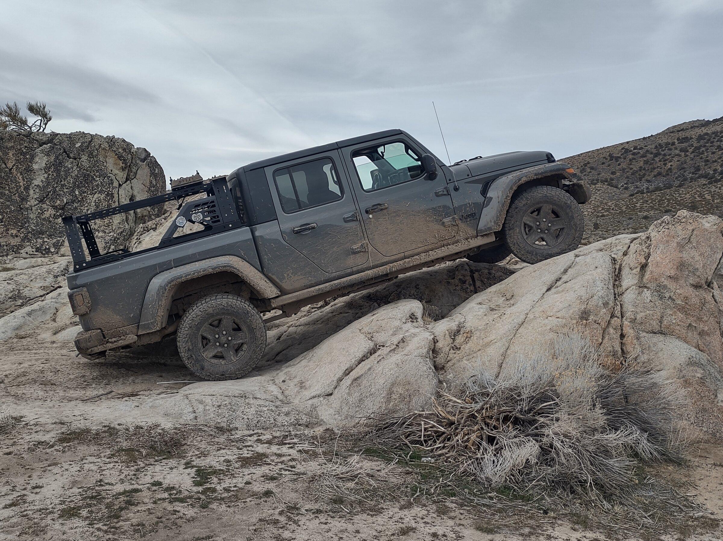

maybe it was just me, but the wildpeaks 33s i put on my sport rubbed on my sway bar. i did wheel like my life depended on it, so theres that.
