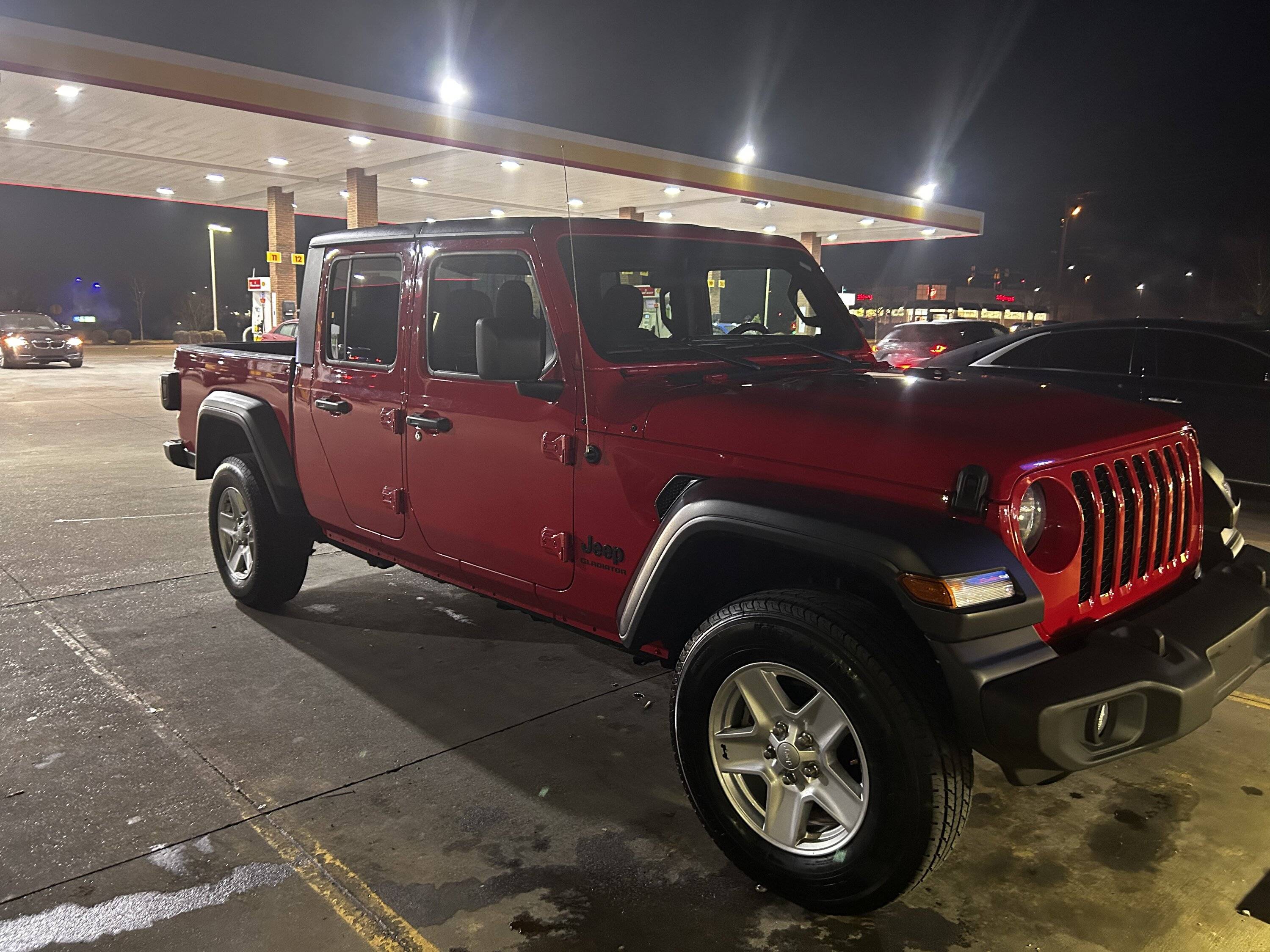

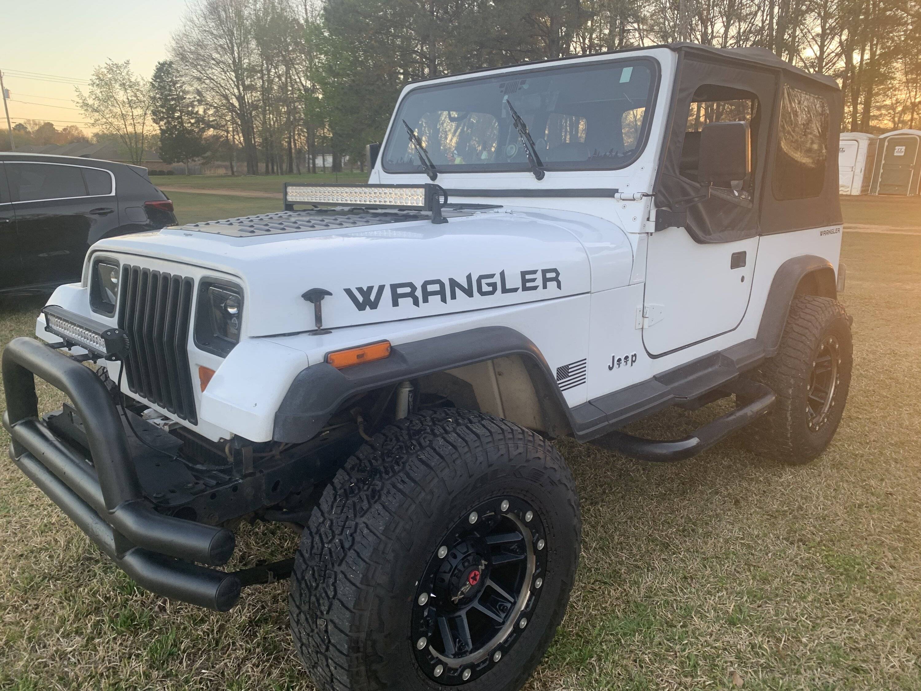

Just picked up a Gladdy Sport S New Years Eve coming from a beefy YJ. I’m wanting to make the stocker into a rocker and have a nice set of Falken Wildpeaks (33x11.50) on Worx wheels on the YJ. Will they fit in the Gladiator without a lift or level? Going to do that eventually but I’d like to pull them off the YJ before I sell it. I’ve found some nice Rubicon wheels locally but I’d rather go bigger than the stock tire size. Thanks!

The tires on your YJ are going to be dang close to the factory rubicon tires which fit just fine on any model JT
Your good to go!

I think everyone's missing the obvious. The wheels won't fit, as the bolt pattern is 5 x 4 1/2" on YJ, 5 x 5" on JT. Also, keep in mind your new JT's wheels are 17" in diameter, smaller wheels might not clear the brakes and/or suspension.
I should have specified, the rims are universal and are also 17”.
