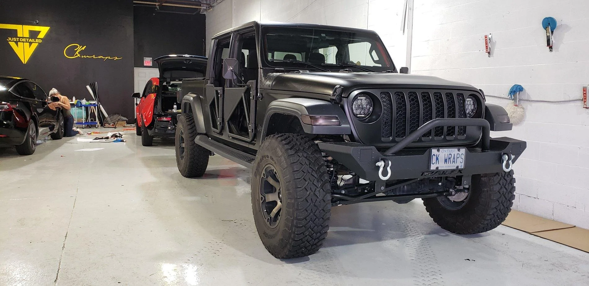

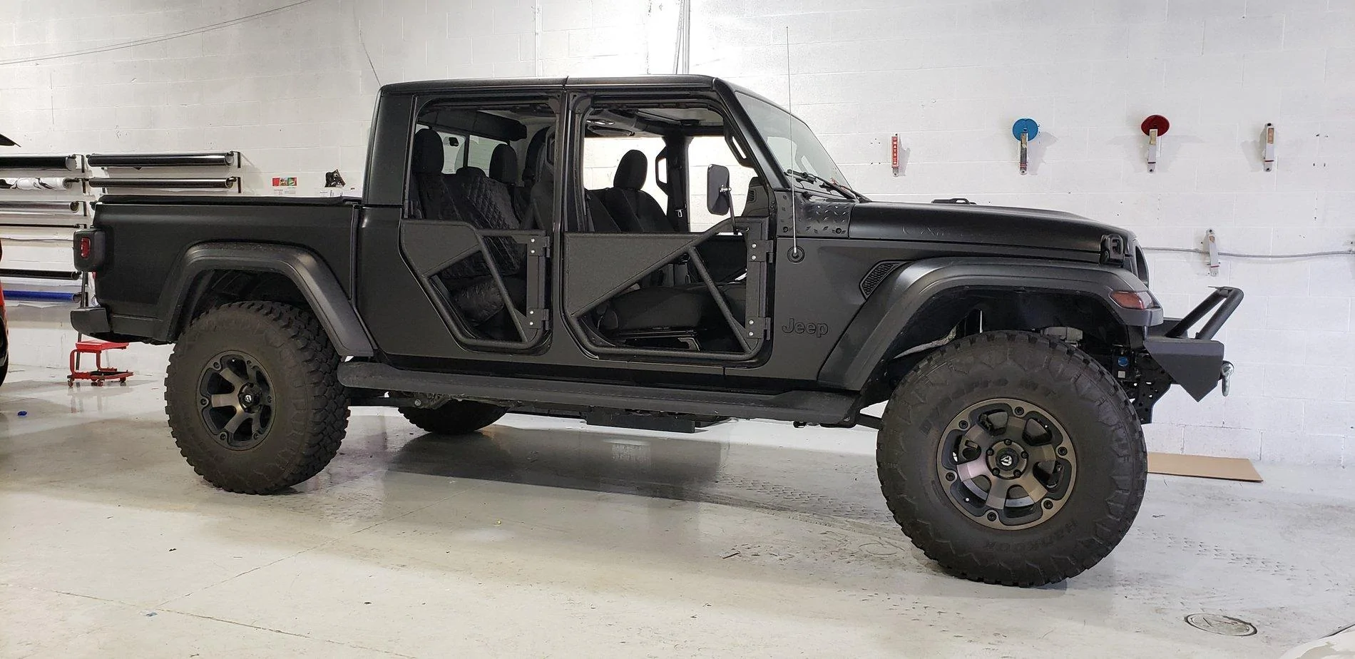

Got some new parts on. TrailFx front bumper and half doors. Warn 12s Zeon winch coming next week and a full new wrap
