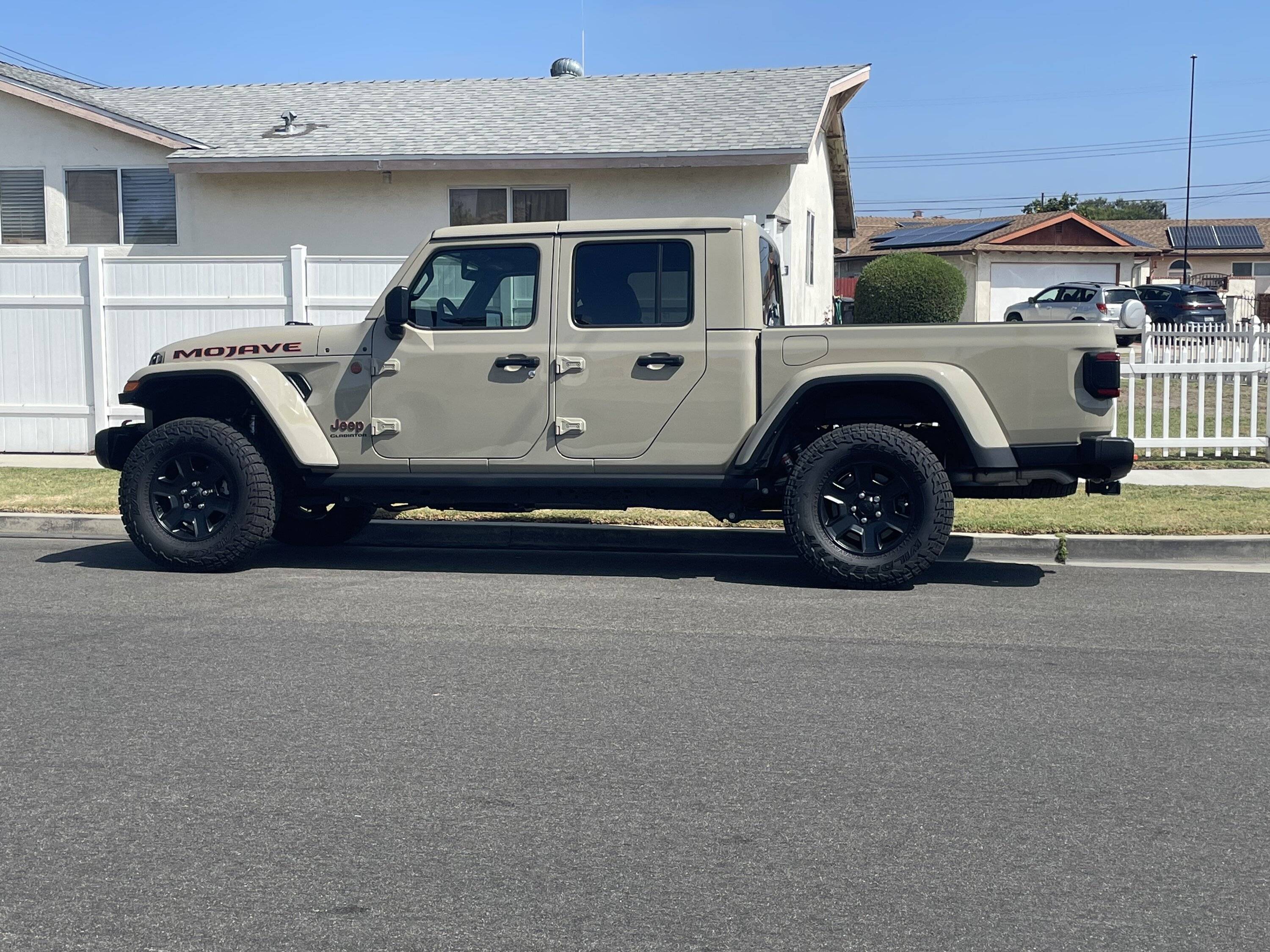

I purchased my Mojave used with about 18k miles. The original owner had 37x13.50R17’s on the original wheels running Synergy wheel spacers and an additional 1” lift up front. It honestly didn’t drive too bad for such a wide tire. No rubbing with normal driving but I never had the chance to take it off road. I barely saw 7/8 gears except for really flat and under 50mph.
I eventually got nervous running such a wide tire on the stock rims and installed Icon Rebound Pro’s and an AEV 2” Mojave lift. I also re-geared to 5.38’s and am much happier overall with the setup. It will hold 8th gear all day long and is snappier than a stock Mojave. MPG’s also went up by 2 mpg.
The pic below is when the stock wheels were set up with the 37’s.
Jeep Gladiator 37’s on stock Mojave wheels? IMG_3226
