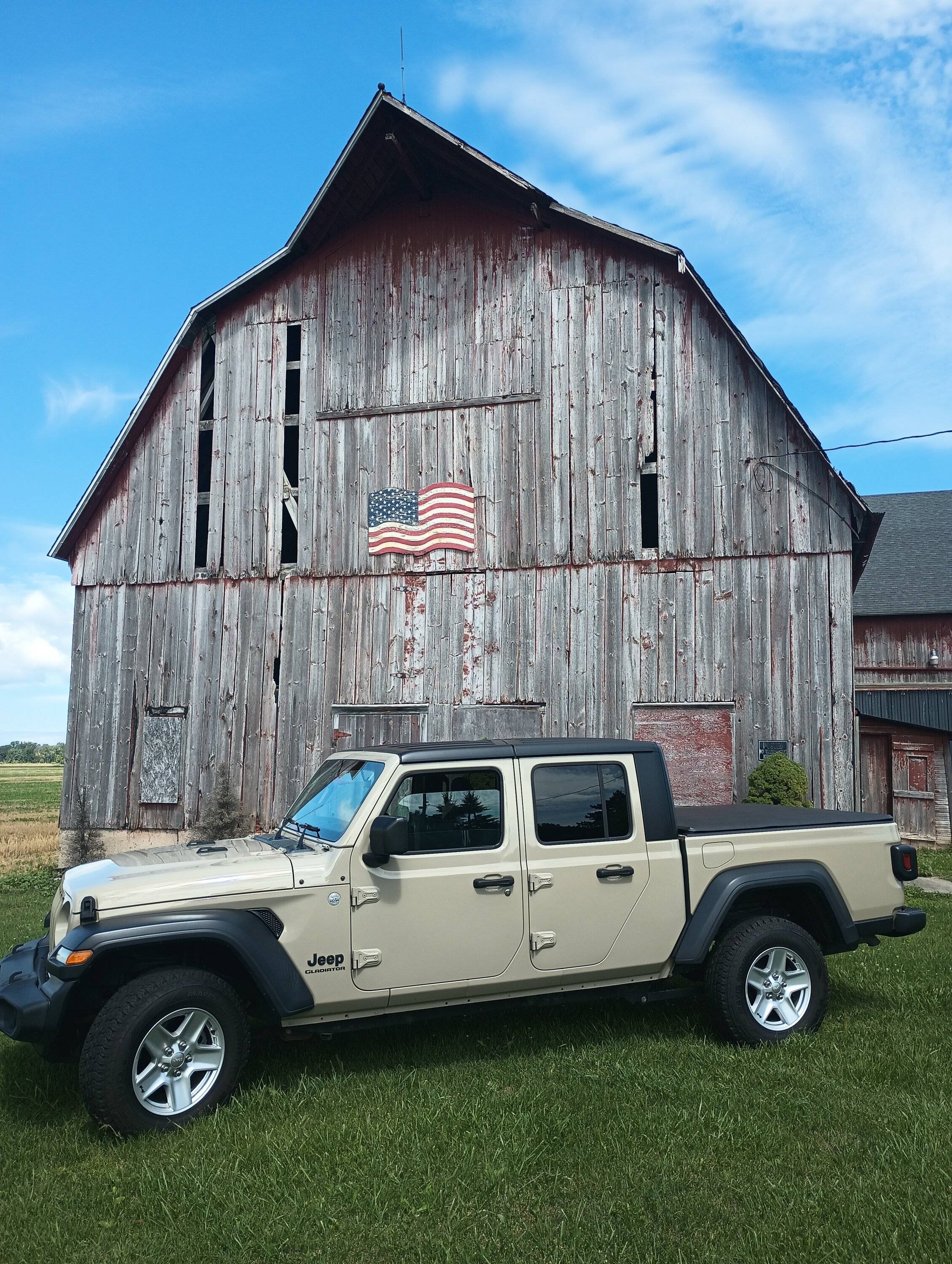

I know this question has been asked to death. I tried searching before I ask. I've got a stock 2020sport. Can I put 37s on my stock rims with a 3.5 in lift with springs and shocks. I just learned after parts were ordered, that there is a significant difference between the gladiator models as far as fenders go. Am I gonna need anything else besides the regearing?

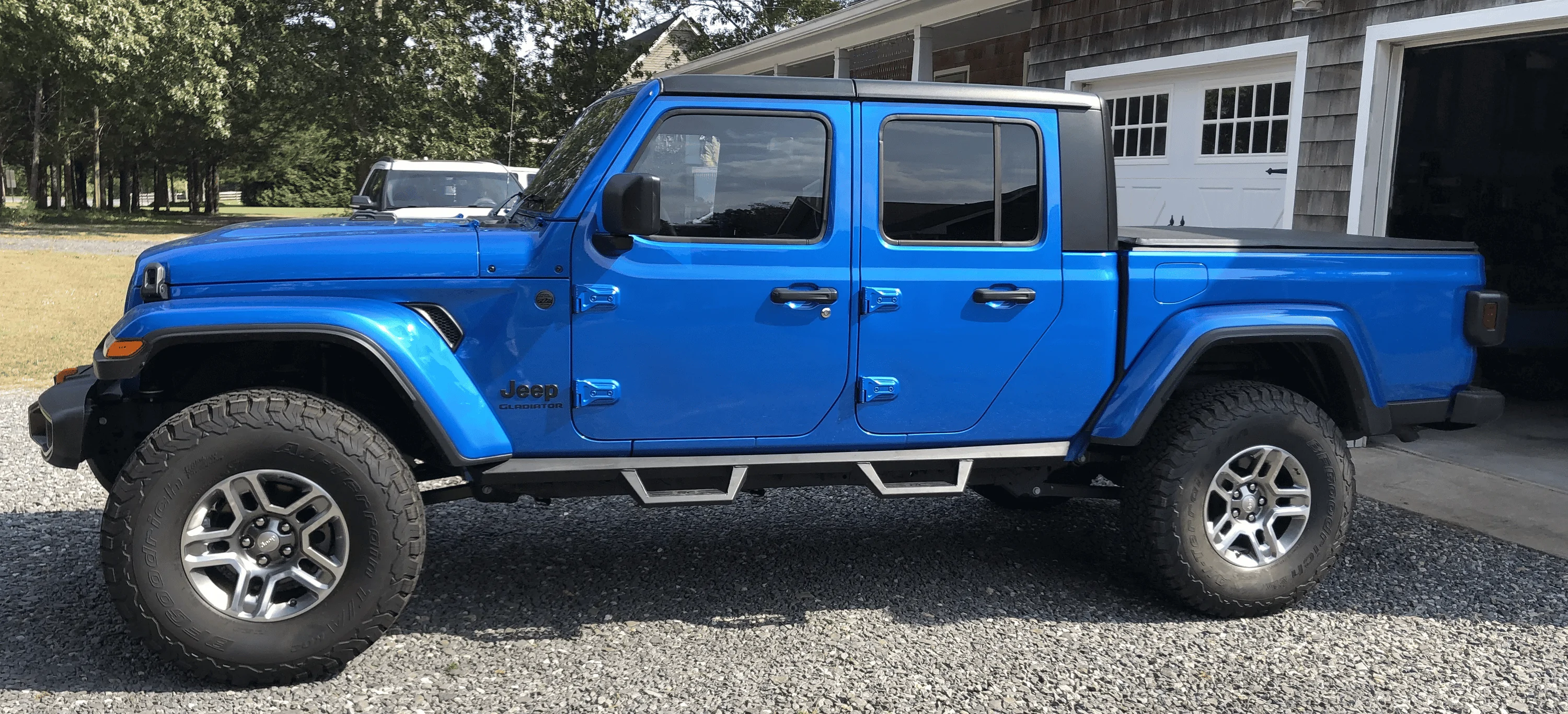

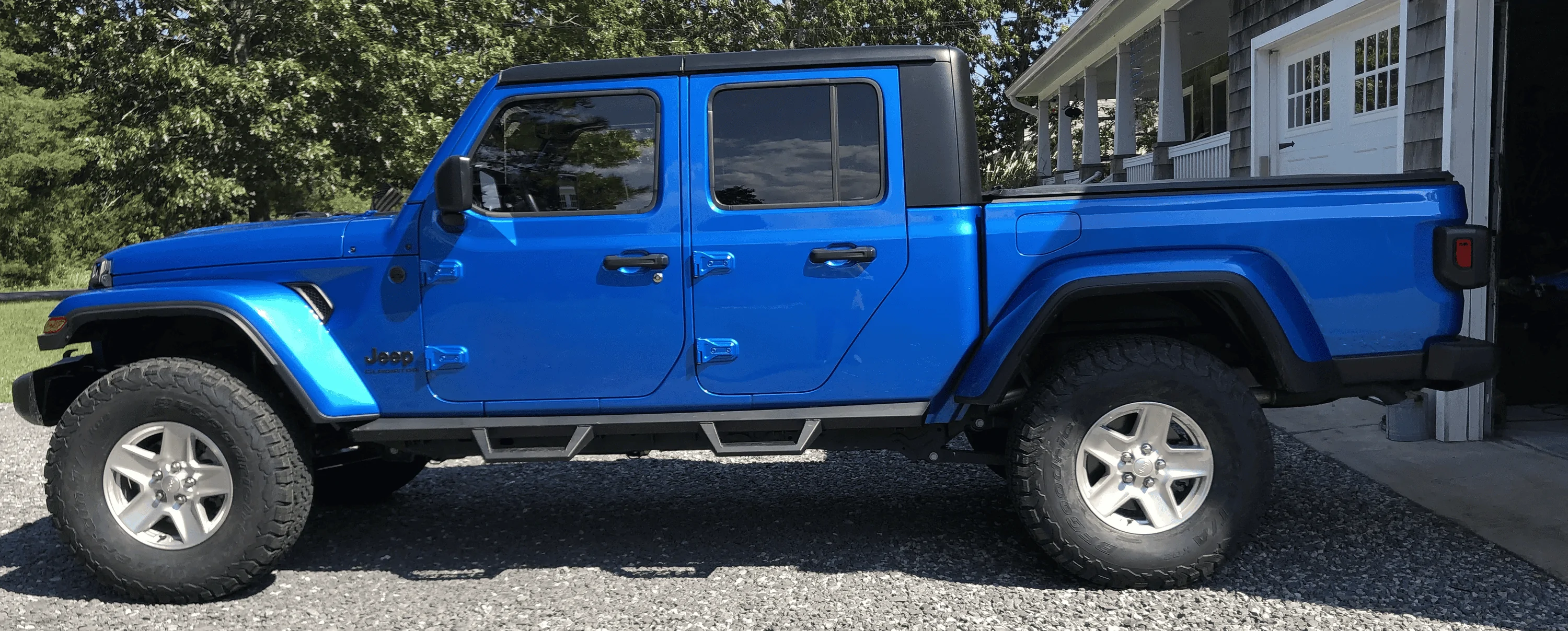

Spider Traxx spacer are fine . I have them on a Rubicon TJ now for about 15 years because I wanted to use the OE wheels . I just do not reccomend them on a aftermarket wheel because of the amount of Back spacing on the aftermarket wheels . I ran my 37s on my oe SportS wheels a couple weeks until I resolved and issue with a defective set of aftermarket wheels . I just don't care for the Hub cap appearance some stock wheels give and12.50 on a 7.5 wheel is not recommended by any tire manufacturer I have seen .
