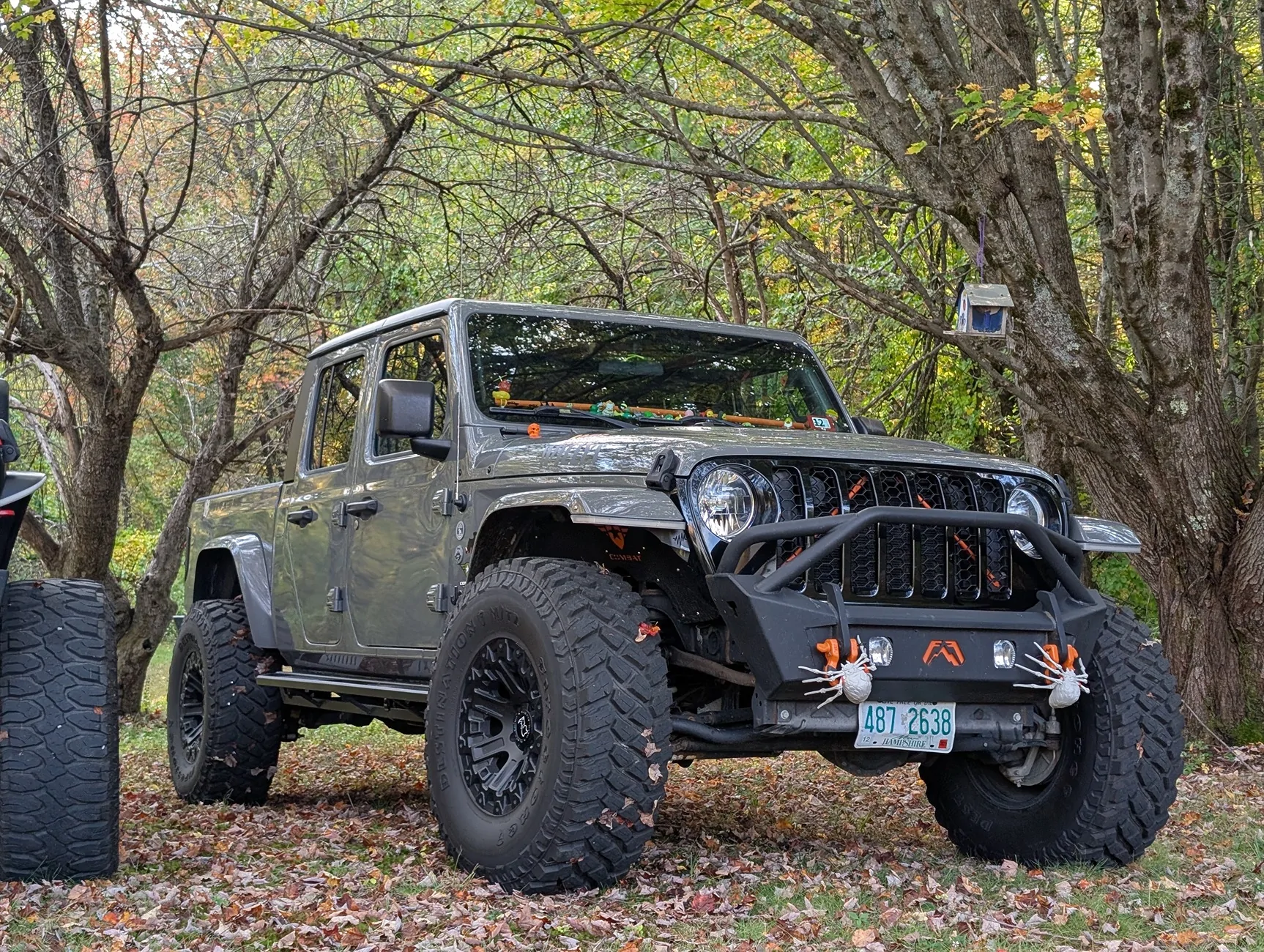

Looking at a Jeep gladiator sport that is already done up with 37s. How bad is it on the stock gears? Any other issues to worry about
Been on 37's for about half a year. 3.73 gears. At first I had no speedo calibration tool with my old 34's, I quickly knew I needed one once I had my 37" Firestone destination m/t's installed. Didn't see 7 or 8th gear on the highway and lots of gear searching from the transmission. I installed a flashcal + and everything was back to normal. Actually it rolls better, more smooth and comfortable. I'm very happy, feels like a truck finally.
