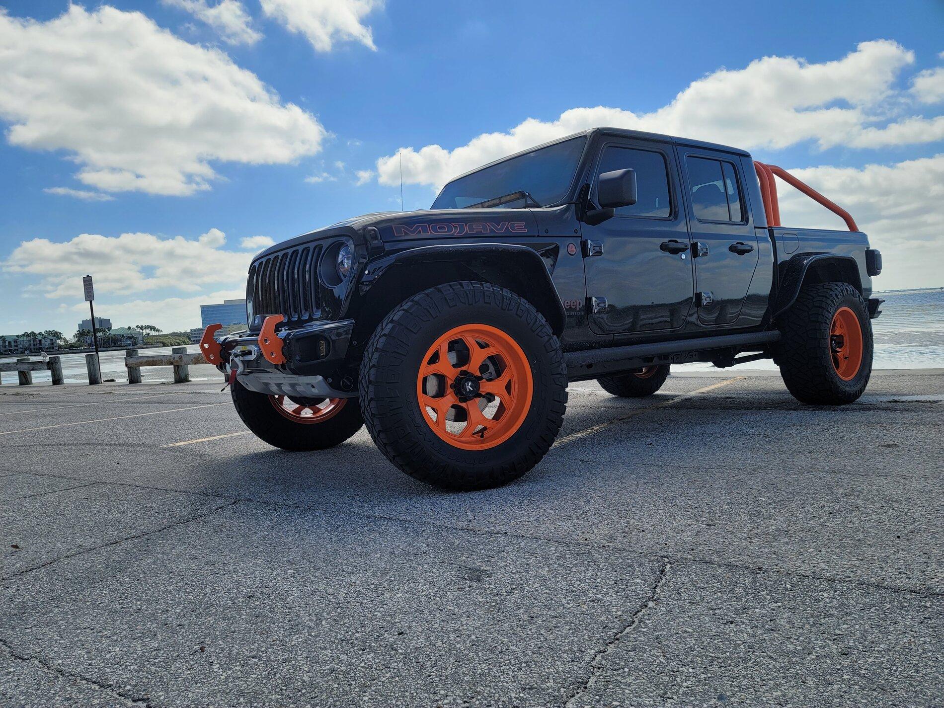

on my '23 Mojave I ran it on 37x13.5s until I installed the lift, no rubbing or nothing

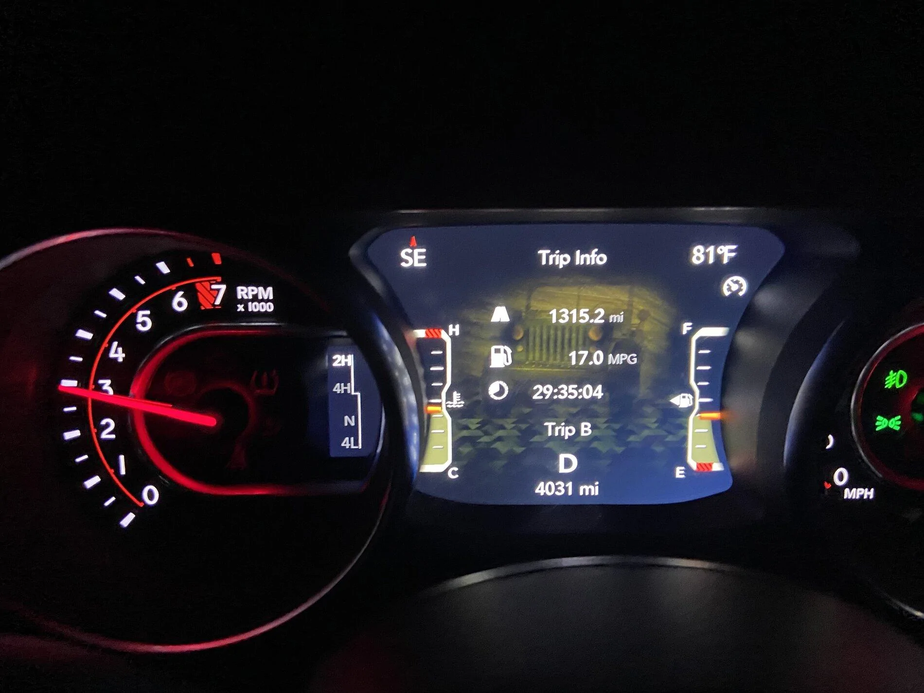

I was hitting 8th last night at 80 mph and was at 2200 RPMs with my 37s that's not bad on my 2018 Rubicon with 410s is it ? 2018 JL Rubicon

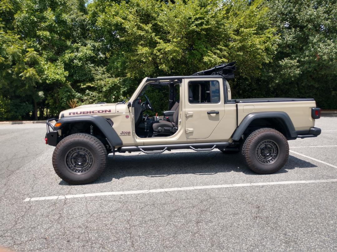

Still on the stock 4.10s with 37s since the truck had 1100 miles. At 35k now. Still see 8th gear, tows just fine even up hills. Even an overloaded 8200lb trailer was no problem. The idea that a regear is going to be game changing is just false in my experience. Our 2019 jlur we regeared from 4.10s to 5.38s on 38s. It wasn't better at anything. It got into 8th gear a lot more often... like any speed over 40mph. Not bad...if it was a 10 speed. There's no reason to be in the 2nd overdrive with no more shifts by half the legal speed limit or west. Gained 1mpg around town, lost 2-3 on the highway. For our use that's a massive hit as our AZ property is 600 miles from the house. 99% of that is freeway at 80-85mph. Losing a huge chunk of fuel economy under the use where we burn the vast majority of our fuel every year is not good. Being a Rubicon the 4-1 transfer case offered plenty of crawl ratio before the regear. Gears that low made 1st gear almost useless in 4LO outside of the most technical obstacles. And the measured 0-60 didn't improve either. Another guy on the JL forum tested his 0-60 before and after with the dragy and had the same rest. 1/10th quicker 0-60 with the only gain being very slight off the line boost in 1st gear. The entire graphed runs above that were identical. People think they gain power back and the truck is quicker because it's running through the gears quicker. The most under whelmiing mod I've ever spent $3k on in any vehicle. If you want to gain power back you're better off with a tune for less than 1/3rd the cost. If your really want to gain power spend 2x the cost and get a supercharger. Gears offer very little that you can't gain with a simple downshift and the auto does that...automatically.
