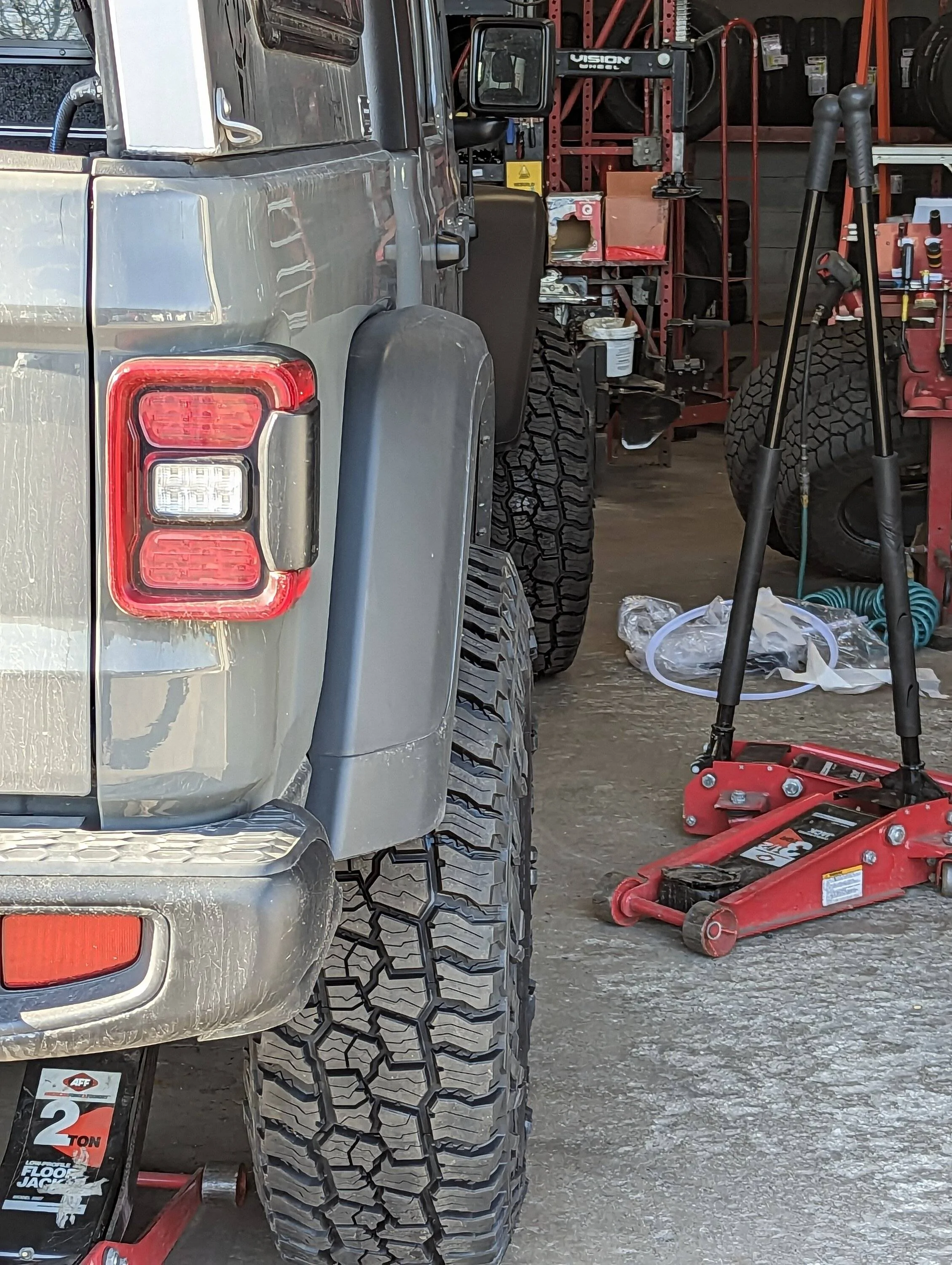

I am running a 3 in heavy duty AEV diesel lift, 37 nito recons with fuel wheels
What’s the wheel specs? Any side pictures showing how wide they stick out?

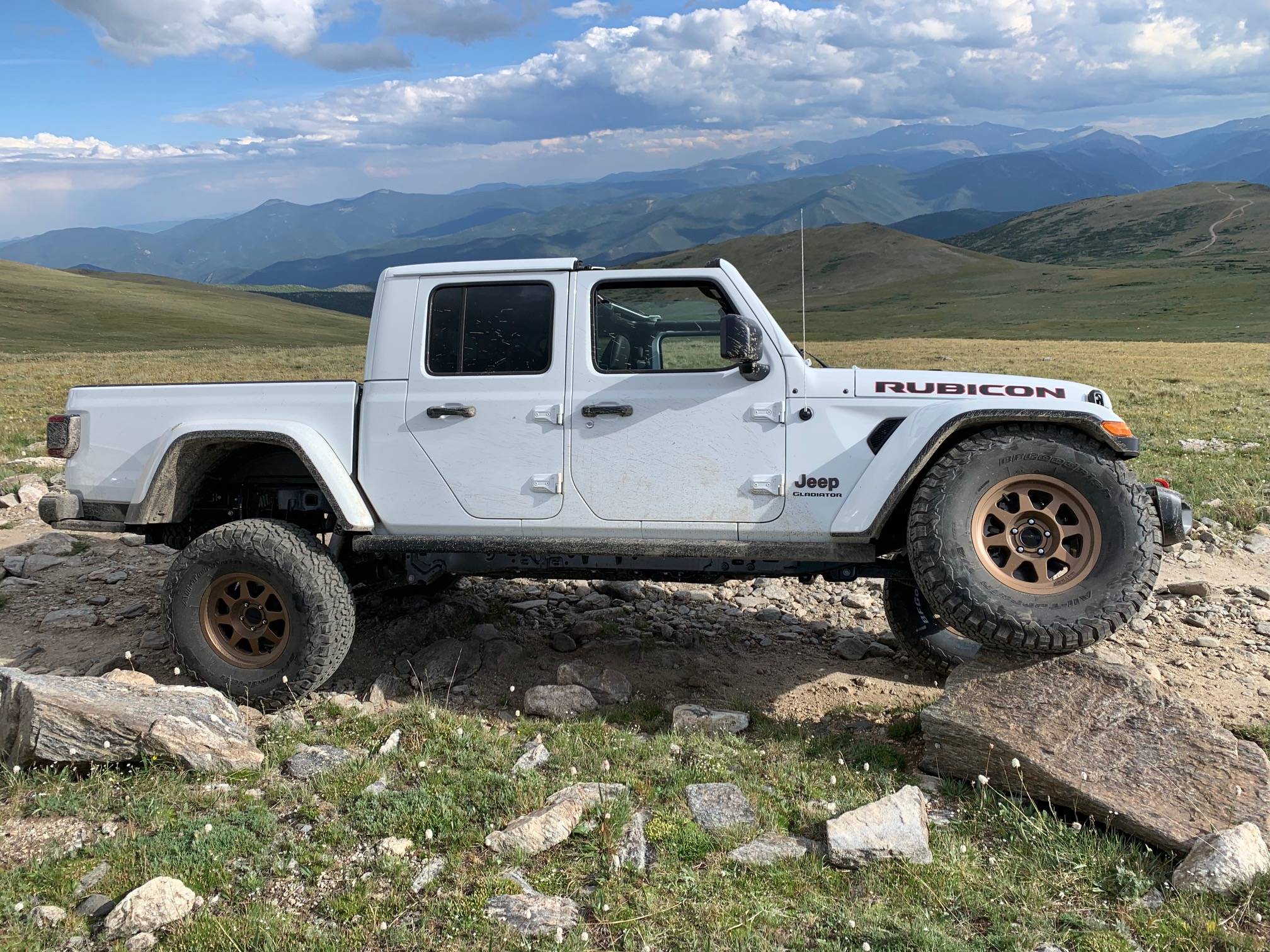

Rebel offroad built the suspension and I can't find out what my wheel specs are yet. They do stick out an inch from the rubicon fenders. I saw the factory fender flairs on the extreme recon. Mopar website had them for $56. After I installed them, I heard guys are putting two sets of front flairs on

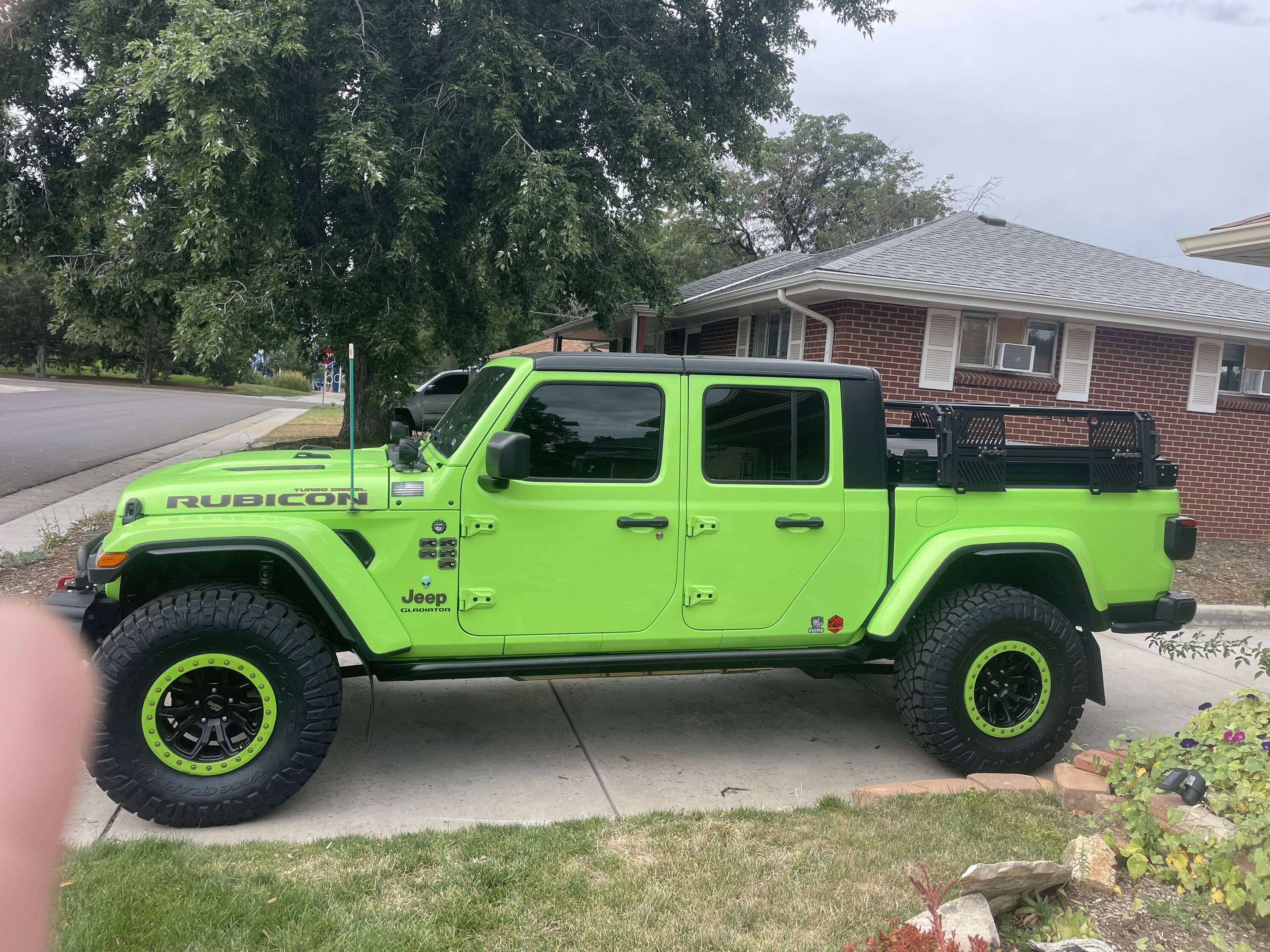

Soon it will be time for me to get 37's. My understanding is that spare tire well can only accommodate 36", but many 37's are actually 36". Any recommendations in favor of particular tire models in this category? (AT, not MT)
I have 37s with the Clayton Offroad Overland plus 2.5" diesel lift which accomodates a BFG TA KO2/37 x 12.5 x 17 tire with stock steal spare wheel. Im also on Method 703 Bead Grip wheels-- 0 offset, with I think 3.75" of BS...

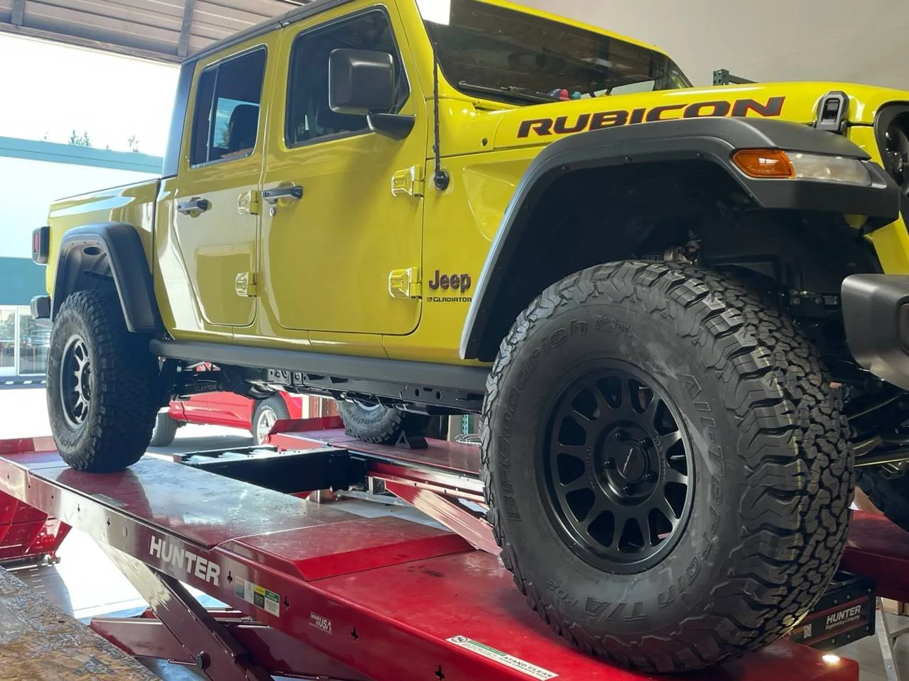

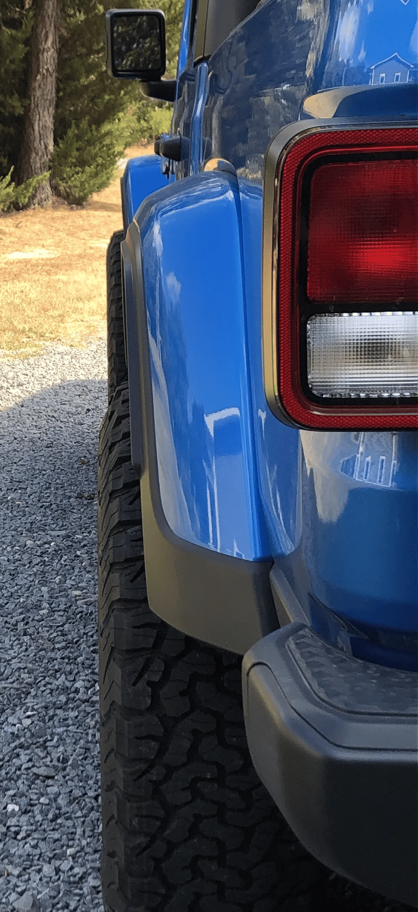

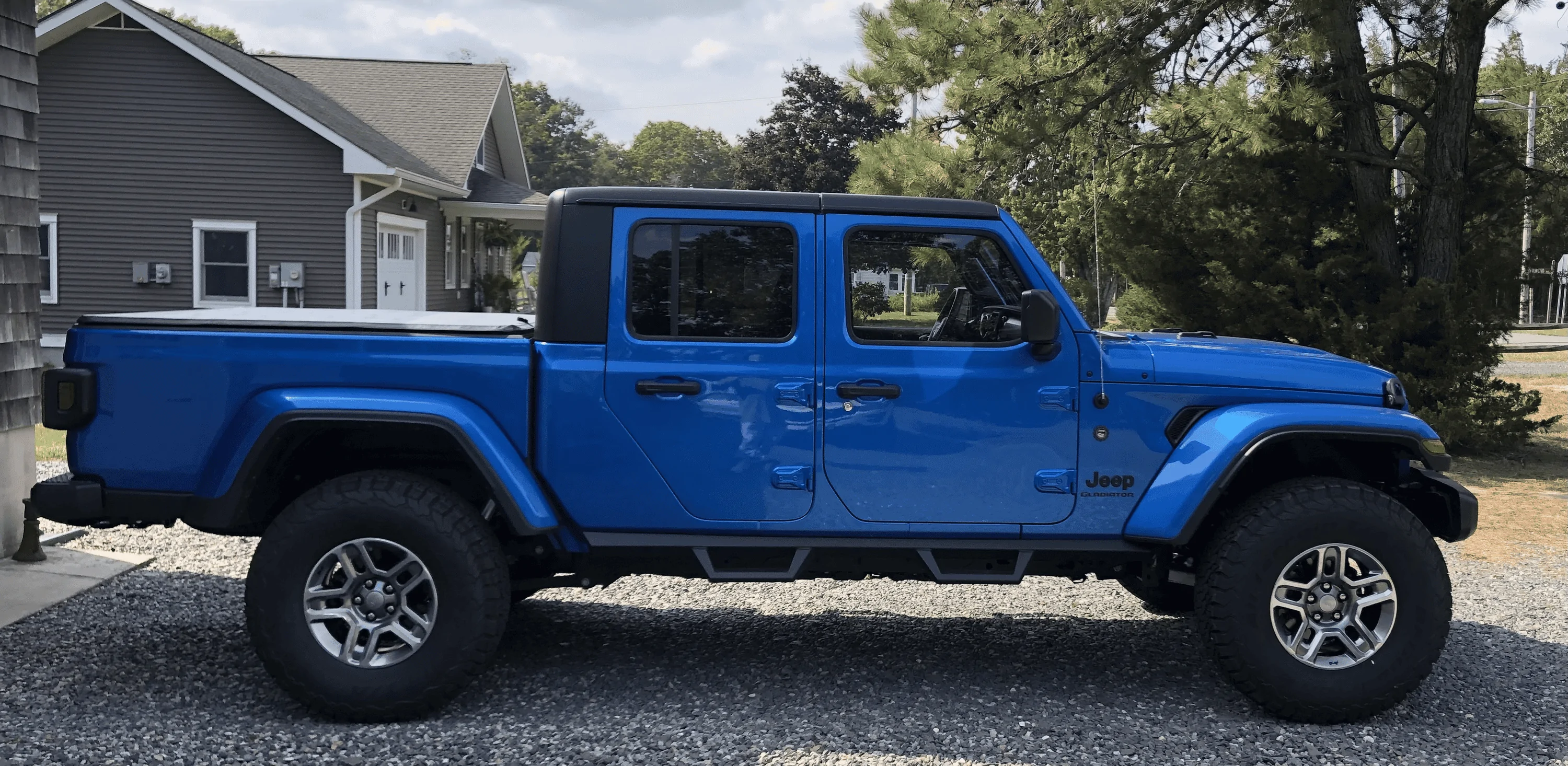

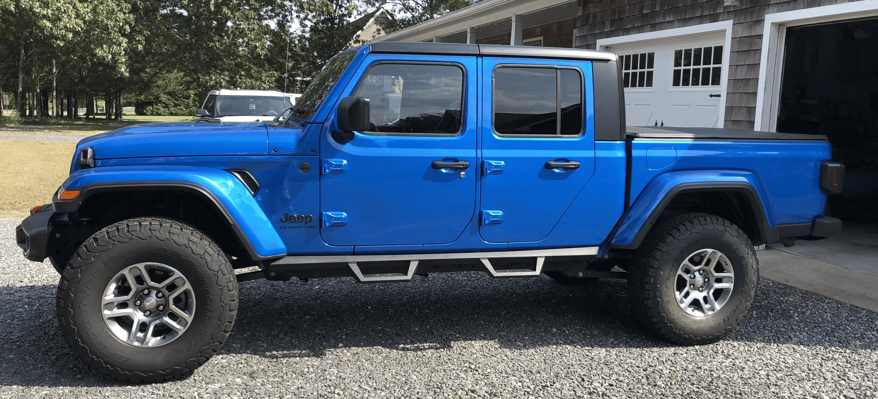

Overland with the narrower axles and flares. I went with the JK's +4 AEV Borah. About same footprint as Rubi with +25. Pics below showing the pokes

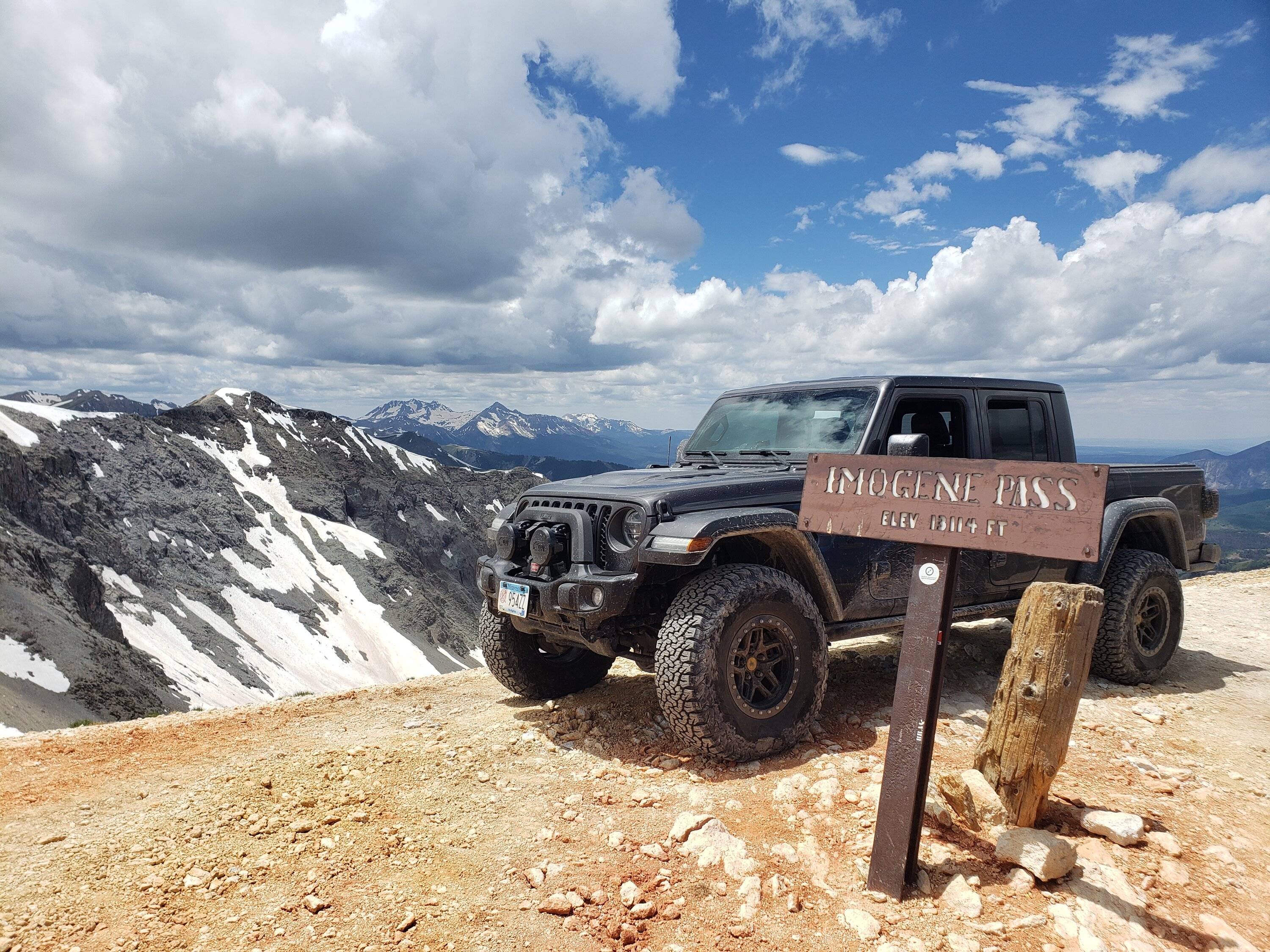

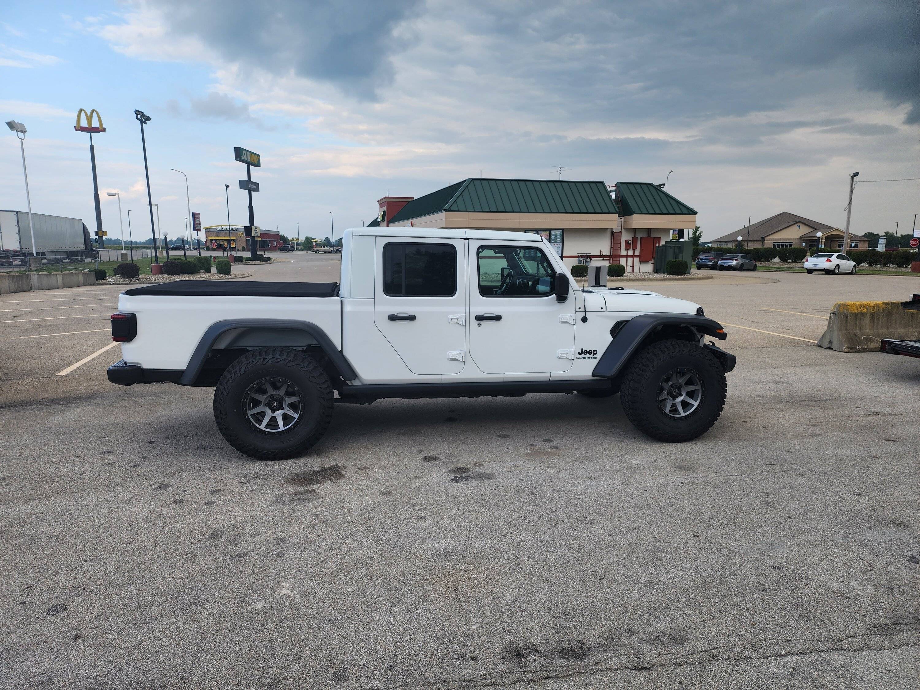

17”. And I was wrong on the offset, they’re -6mm.

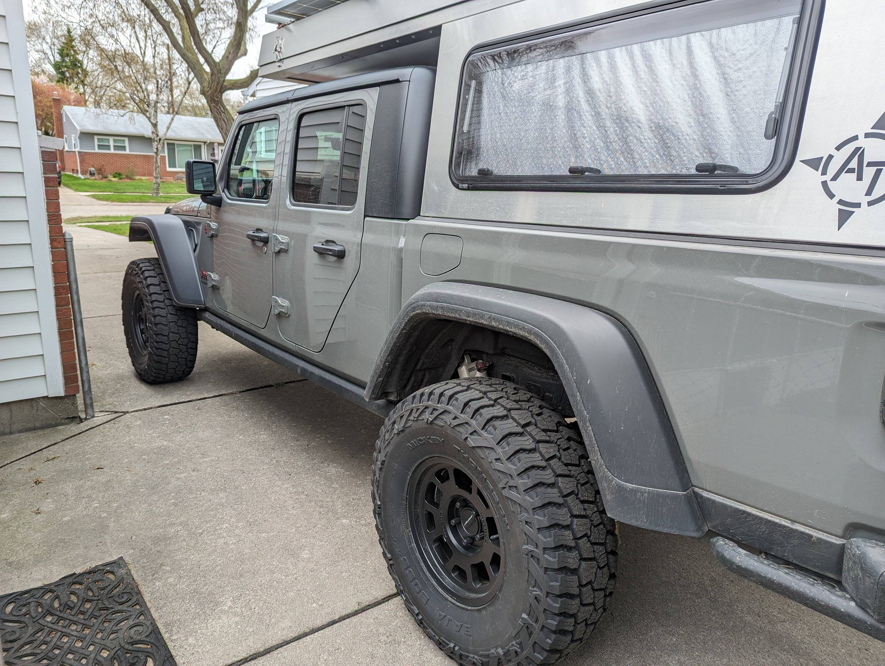

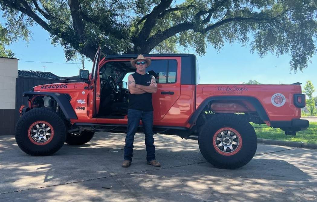

Running Gear Off Road satin bronze 17x8.5 wheels wrapped in Gladiator Xcomp AT 37/13.5R17's
Jeep Gladiator Guys with 37s what wheels are you running? iris
