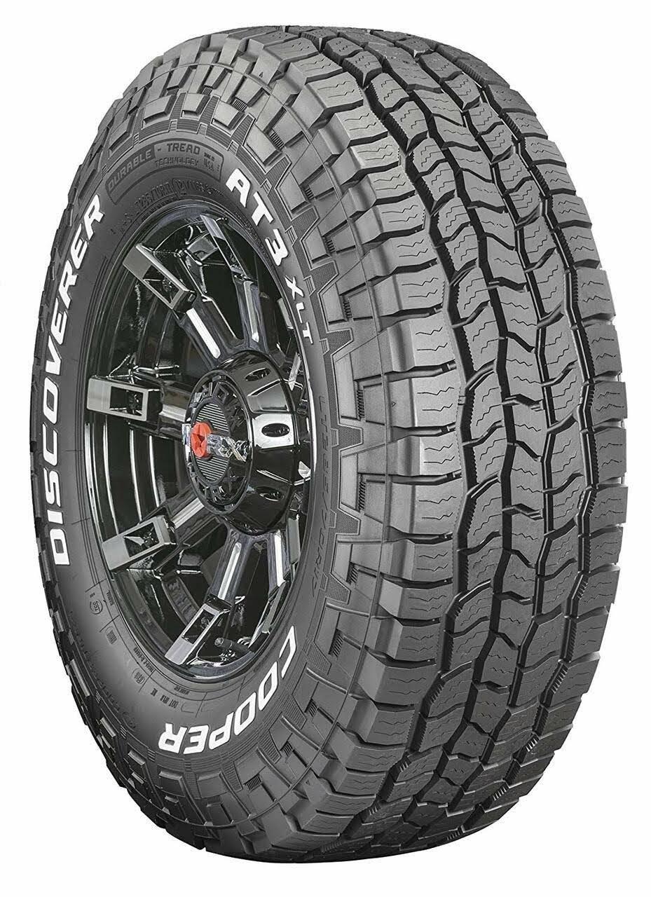

Its not tire tire problem per say if it pulls toward road crown. Maybe the taller tire or open tread pattern could make it more or less sensitive that a shorter less aggressive tire. If you mainly drive crowned 2 lane roads and slow lane on the highway.........You could have an alignment shop bump the caster up a little on the right side, but be warned it will pull harder left when in the fast lane and road is crowned to the center.
You could also relocate the steering stablizer and install an IFP unit which will push the steering linkage to the left. It will have a similar effect to offsetting the caster.

I ended up just staying with the pros. I’m still getting a slight pull to the right or left depending on the pitch of the road. I’m dealing with it because the off-road performance has been great. But when it comes time to replace them I’ll probably go with something else. Mine are 12.50 wide, another poster said the 13.50 are performing well and I talked with a guy this weekend running 37x13.50’s on a JL that said he had no pulling issues. Maybe 13.50’s are the sweet spot with this tire.
