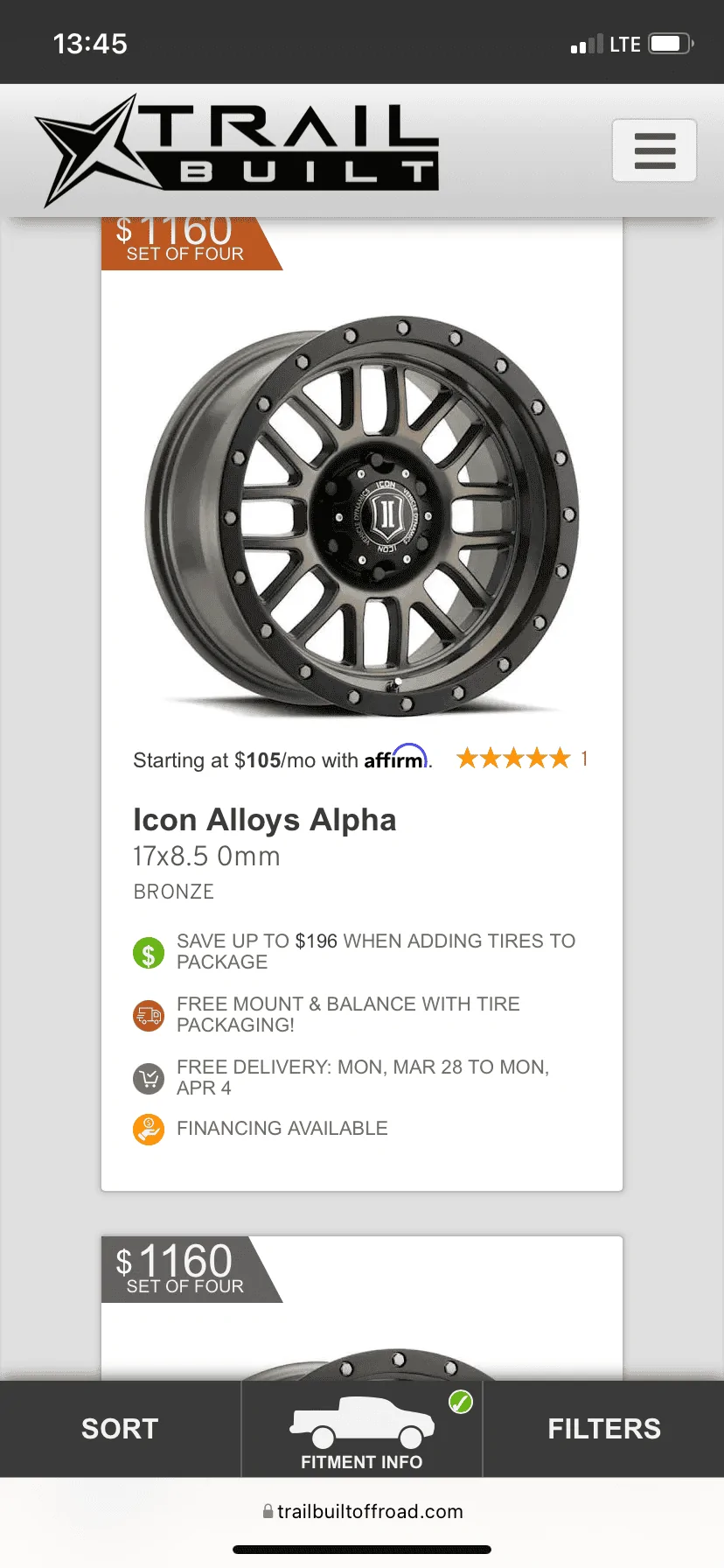

Is that the math? If you have a Rubicon and install the Mopar 2" lift it gets you 4". Is that over say a Sport. I ask because I ordered 315/70-17 Kanati Trail Hogs and Ion 17X9 wheels with a 0 offset. I assume that will work. Now they have to finish building my damn Rubicon. I realize that the stock wheels are over +40 offset, but I wanted to get more articulation in that direction. I've struggled with my Tacoma (for sale) even with 31s and no lift. I don't know what the offset on the TRDPro wheels are (sorry for digressing).

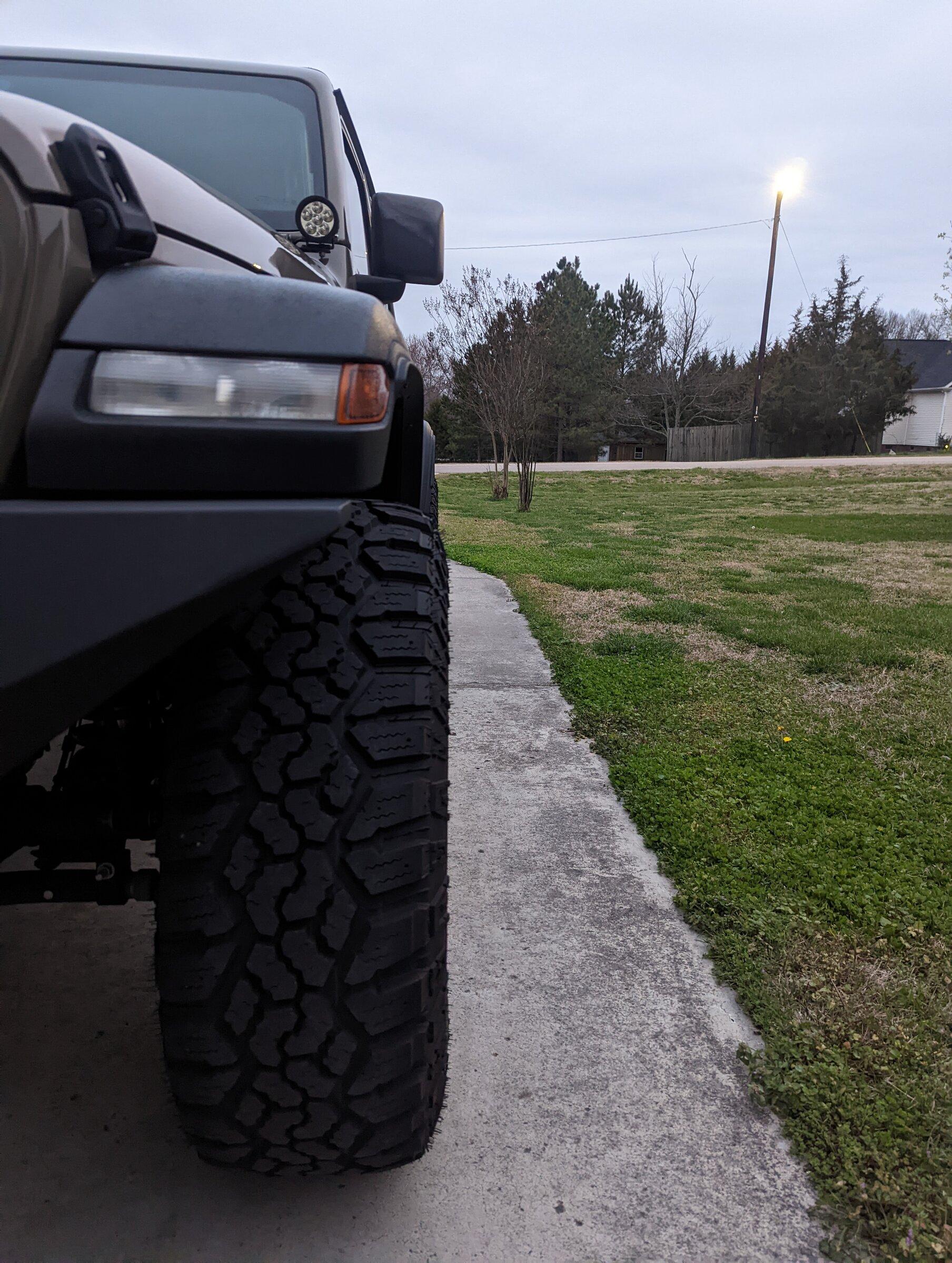

I'm running 37 12.5 17 Kanati Trail hogs, absolutely love them. Mine are on stock 17x7.5 wheels, they sit just slightly outside the fenders. I'm thinking the 315 70 17's will have slightly more poke because my 315 70 17 BFG KO2s stuck out a little farther than my 37's do now.

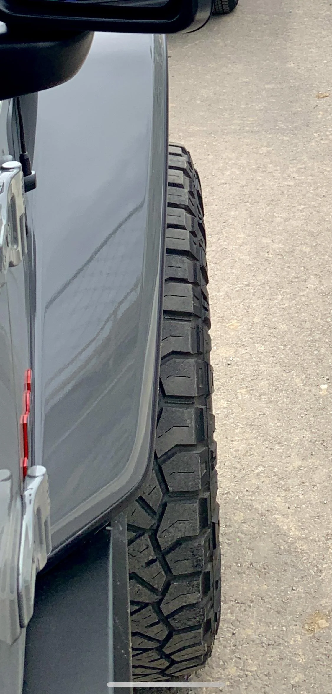

This is a Nitto 37x12.50r17 on a 8.5” +4 wheel. It’s almost about a tread block out from the fender with the Nittos. This may vary with different tires.
Technically in New Mexico they give you 1" outside, so I'm hoping to be just outside with 315s.
What is your offset?
I could be wrong but yes over a sport. The Rubicon has at least 2” over the sport IIRC and believe the 2” lift is with respect to a Rubicon model. Have seen reports that lift on a sport is much more than 2”.

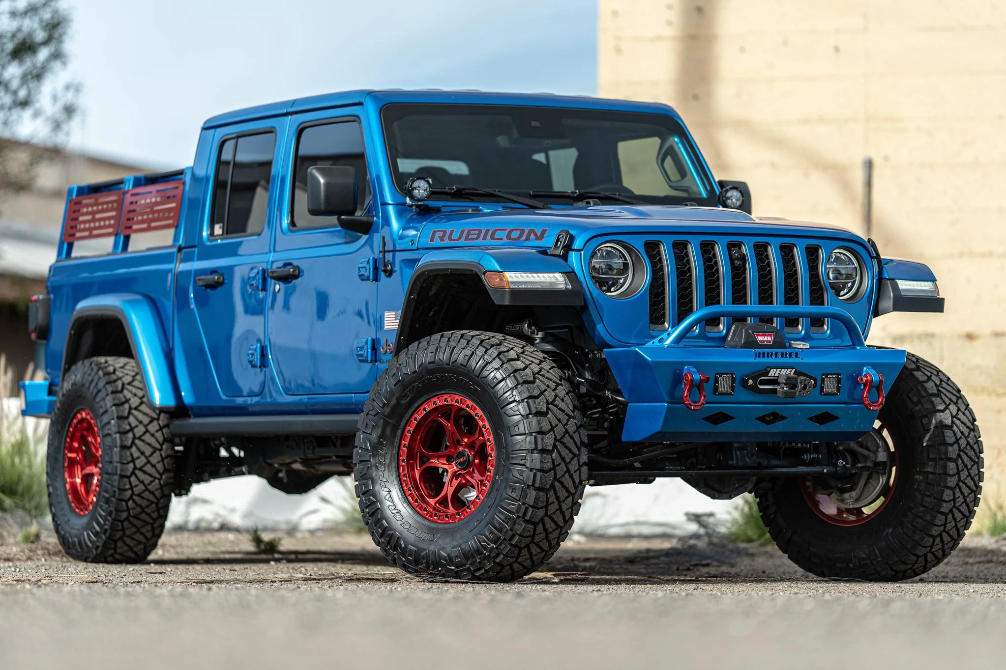

Jeep Gladiator For those of you running 37s Rebel Photo Shoot 1
Deleted member 28696
I have 37 x 12.50 x 20s offset is +.01 with about 1/2” poke. My lift is a 3.00” on a Rubicon JTR. Nitto trail grapplers M/T.

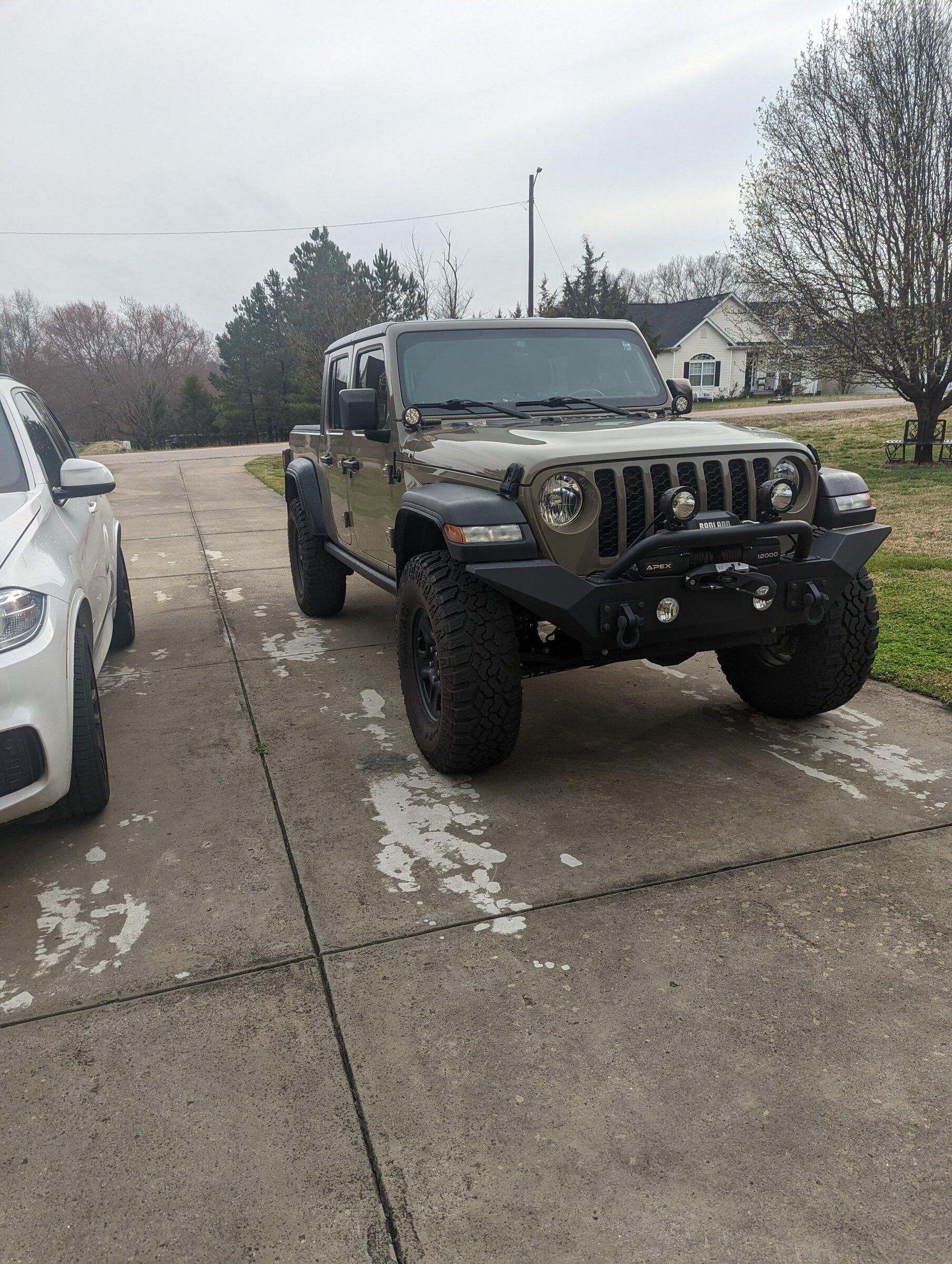

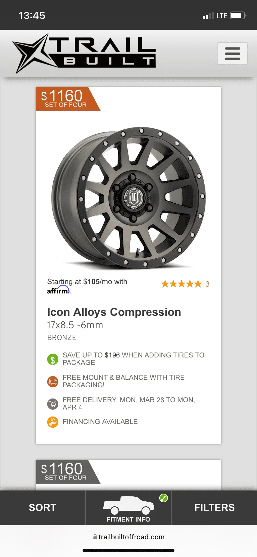

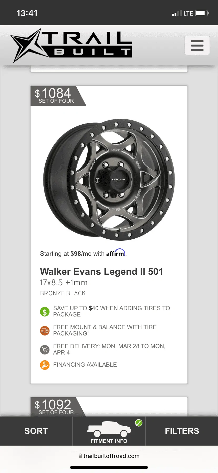

Well goin 17” by 8.5” with zero offset with 37” by 13.5 gladiator A/T, just can’t decide which wheel I like most lol.
I like the first set the Walker Evans best, my personal preference. Never heard of them but they look nice.

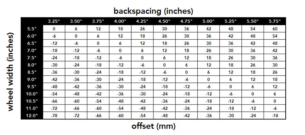

How much difference: 0 offset on a 8.5" versus a 9". Is there a formula for that?

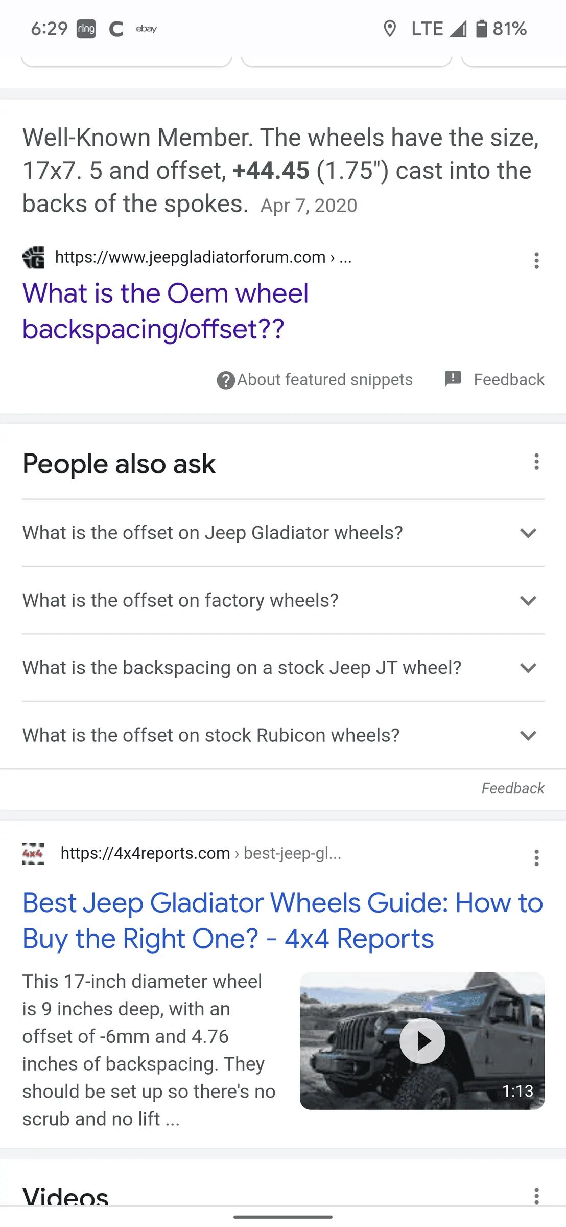

I believe I got this from Discount Tire's website, but from a backspacing perspective according to this 8.5" with 0 offset is equivalent backspacing to 9" with -6 offset.
If this assumption is wrong, please let me know because I'm struggling with the same issue. I can't find many wheels I like for my truck with the specs that fit without being obnoxious (sticking way out).
I'm having the @Clayton Off Road 2.5" lift installed this week and I've read that they require 4.5 backspacing to run 37x12.5's on a Rubi. I'm currently looking at Black Rhino 9.5" with -18mm offset for that reason, but I don't really want them poking out that far and I can't find a 8.5" wheel I really like.
