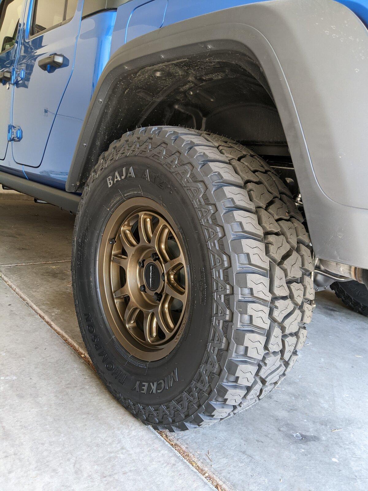

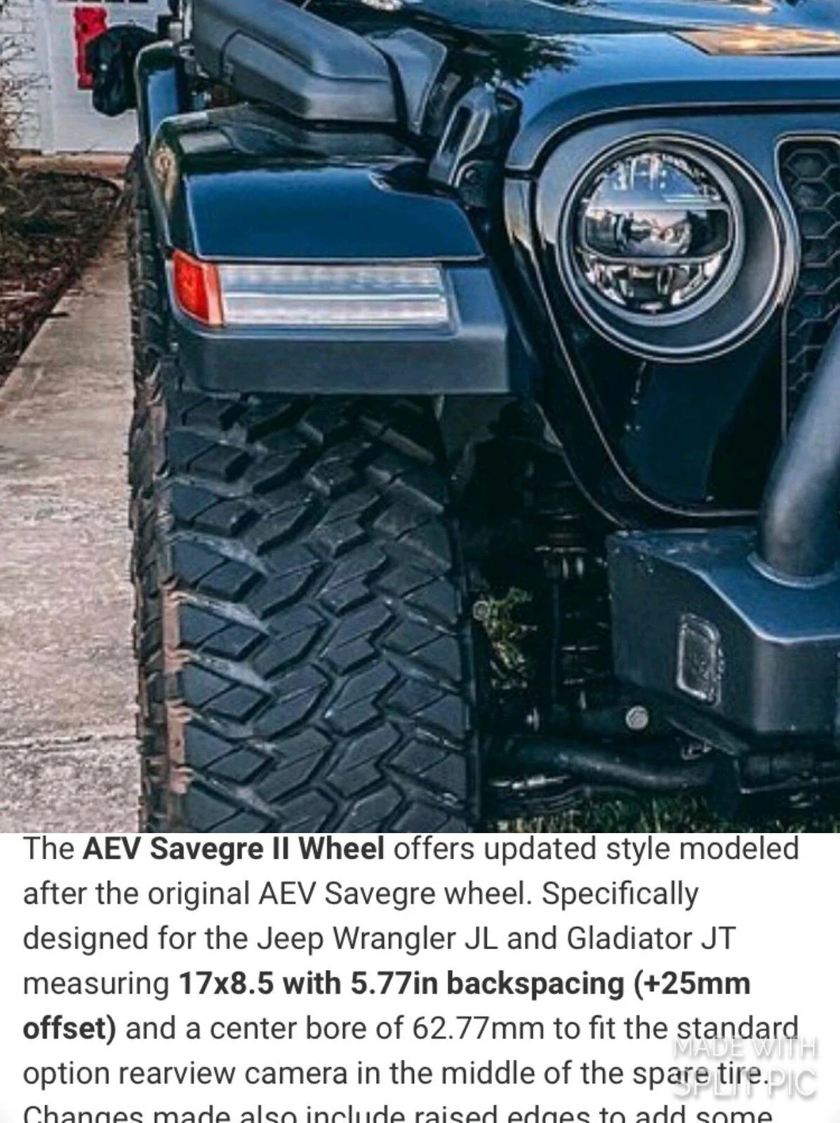

I’m keeping this pic in my back pocket because I live in a tire coverage requirement state and the wheels I transplanted from my JK stick out quite a bit on the JT.
The pic shows a 12.5 on an AEV wheel. This seems to be a good combo to keep the tire under the flare but not have rubbing issues while turning.

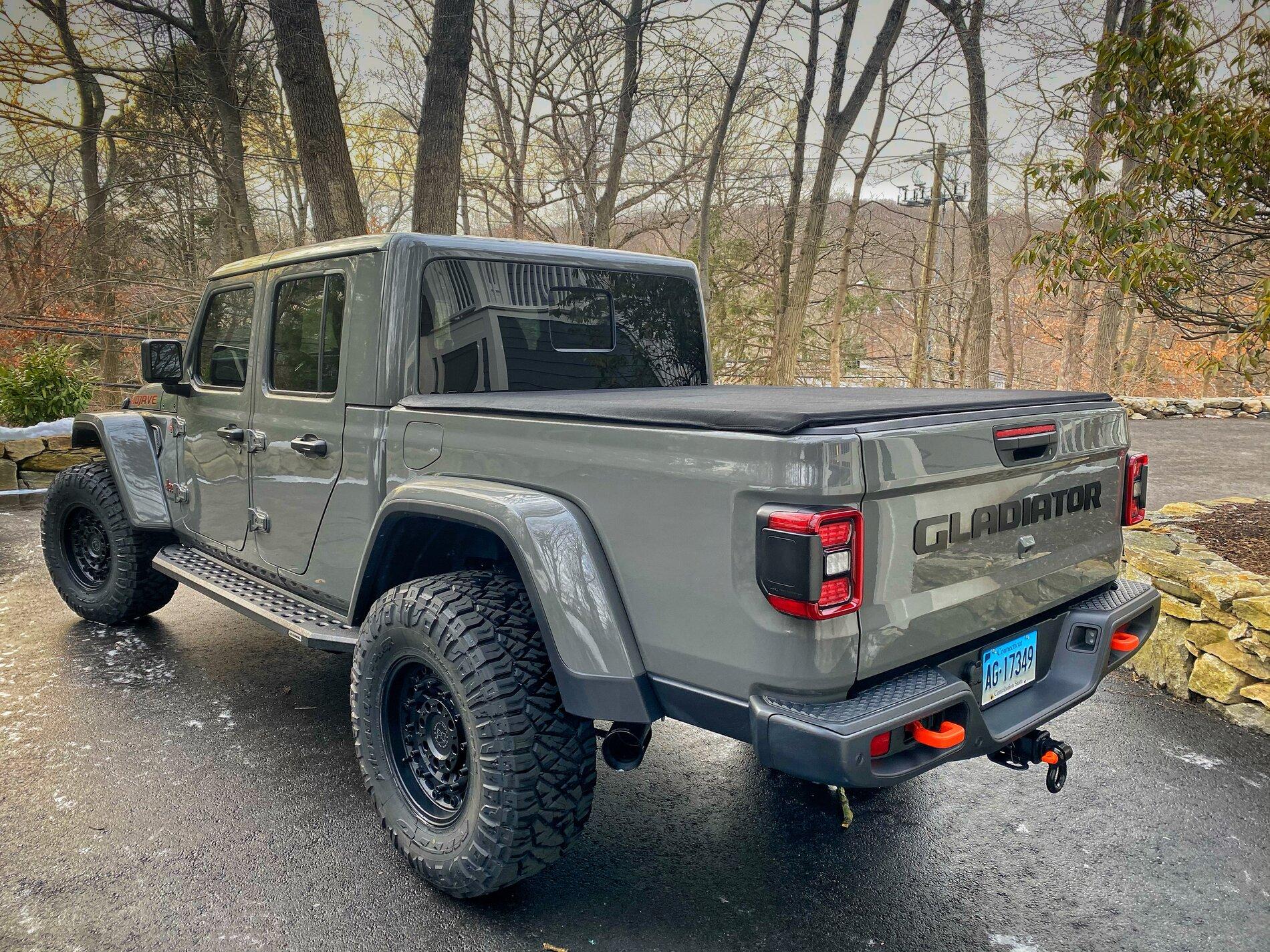

JfishKing
Dec 3, 2020
90
86
Stamford, CT
2021 Gladiator Mojave, 2016 JKU Sahara
