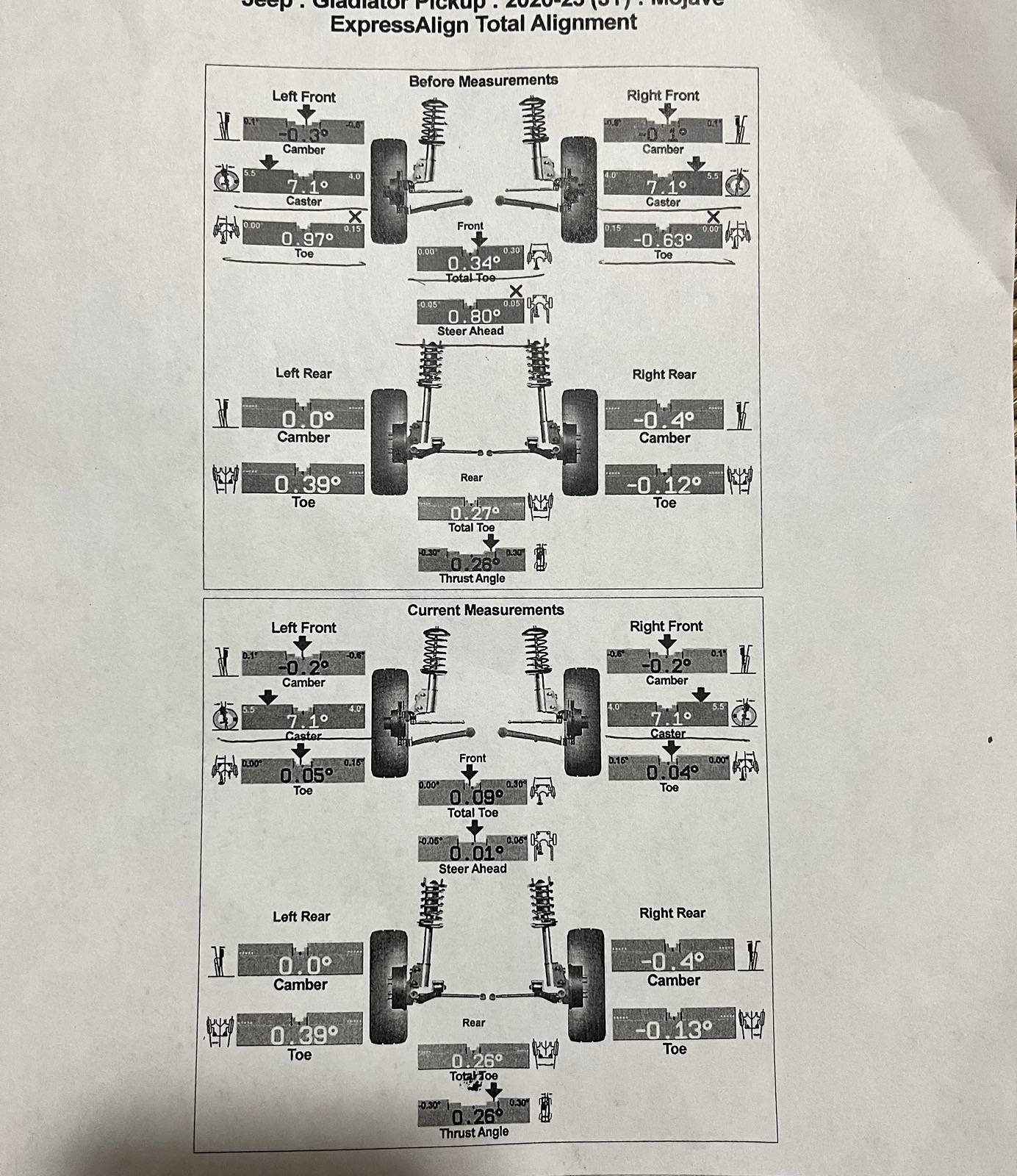

Gotta get under there adjust your drag link out a bit. Or u might be ready for a longer aftermarket one. Depends on ur lift. Jeeps only have 2 points of adjustment for alignment unless u got aftermarket adjustable arms. Stock u only get toe and track. Toe is adjusted my the tire rod driver side. Track also driver side on the drag link. I stopped getting alignments down when I figured this out. These are simple adjustments that can be made in the garage with no rack. Just a tape measure and few test drives.
I’ve already adjusted the drag link which helped center the steering wheel, but it still wants to cant right without any driver input.
I’ve also got the geo brackets installed, my caster is right at 7. It doesn’t really bother me that much and it doesn’t seem too severe but it’s definitely there. Just worried about any extra tire wear because they are brand new.
How heavily are your roads graded? A lot of 2 lanes have quite the grade for runoff. And solid axle will fall into that grade regardless of how good your alignment is.
Yeah a lot of them have some obvious grade, but even on pretty neutral ones it still seems to like the right side.
I still need to repin the ABS sensor on the driver side that got snapped during the lift install. I want to do that before I start adjusting a bunch of stuff to see if it makes any impact.
When you did your lift. Did u loosen the LCAs?

I assume so. I didn’t actually do it myself, the guy who rebuilt my shocks did because he did it for real cheap. Maybe that was a mistake lol.
So the stock LCAs aren’t adjustable. But they need to be tightened with truck on the ground on its wheel. Plus there’s enough slack in the bolts that they can be 1/8 or more off from each other. Ie you can be pushing one side further forward than the other. I had to redo mine cus the passenger side was too forward on the frame side. And it pulled left no matter what. I got heavy rachet straps and pulled the axle as tight as possible against both arms and then retightened them. Drives straight now. If you have adjustable LCAs u can just throw it on an alignment rack and adjust the arms until caster is perfectly equal on both sides. Mine had half a degree between both, after redoing it it’s .04 off.
My caster measures the same on both sides
