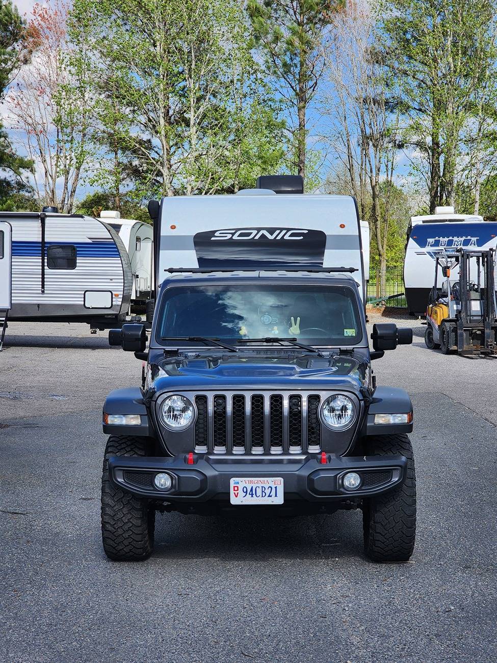

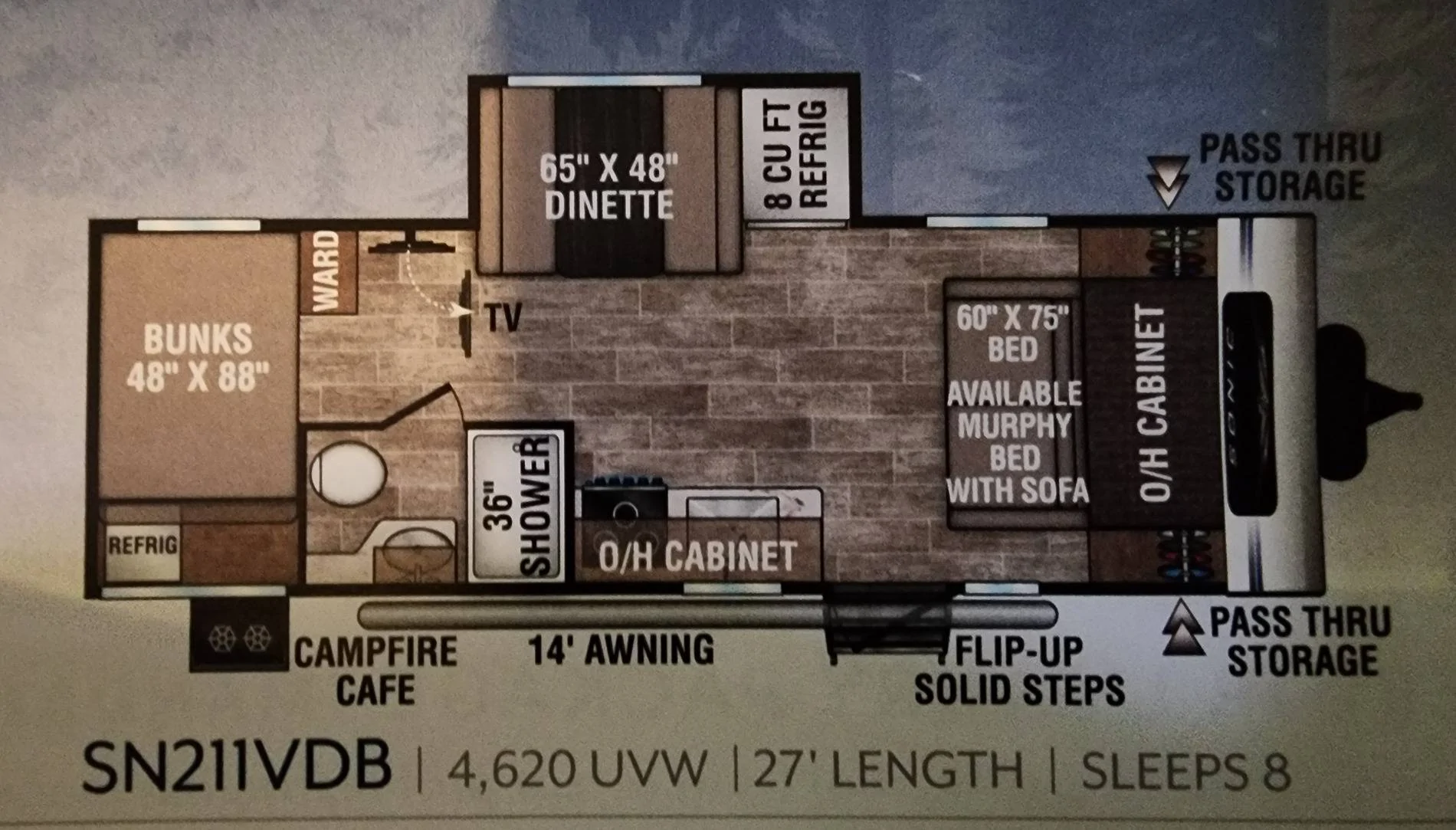

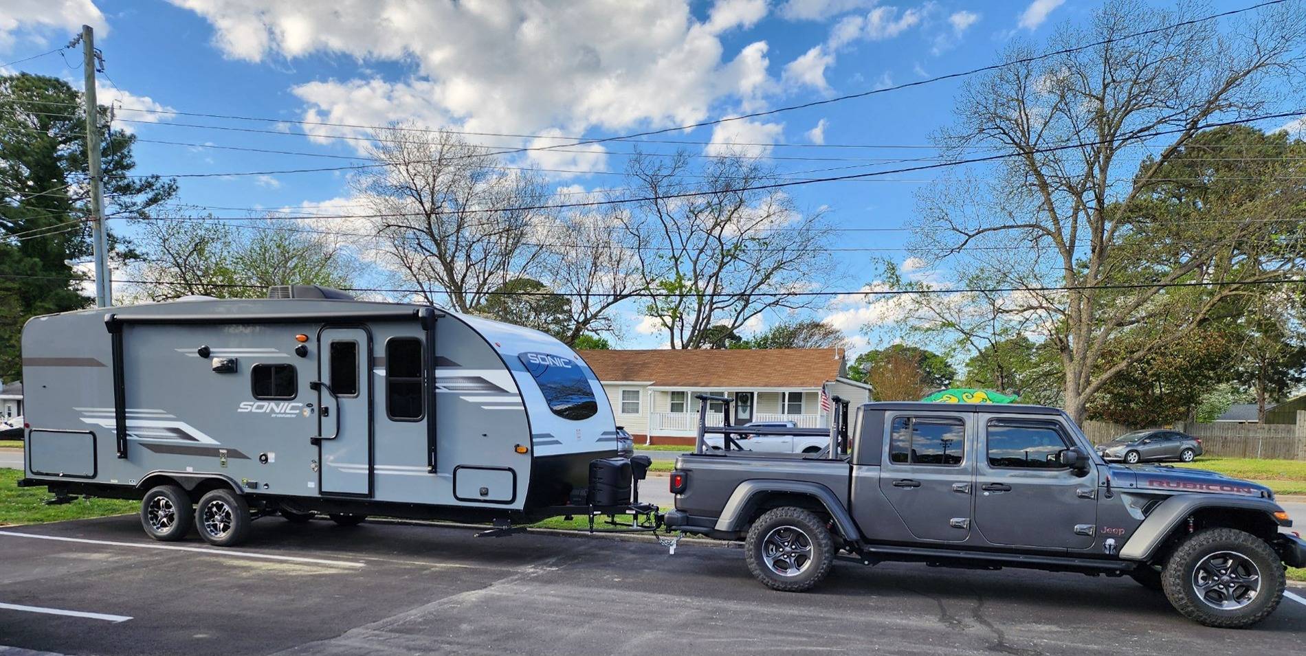

The TT tongue weight is 560lb according to the tag on the inside of the trailer door. I use a Curt WDH with sway control and a RedArc trailer brake setup.

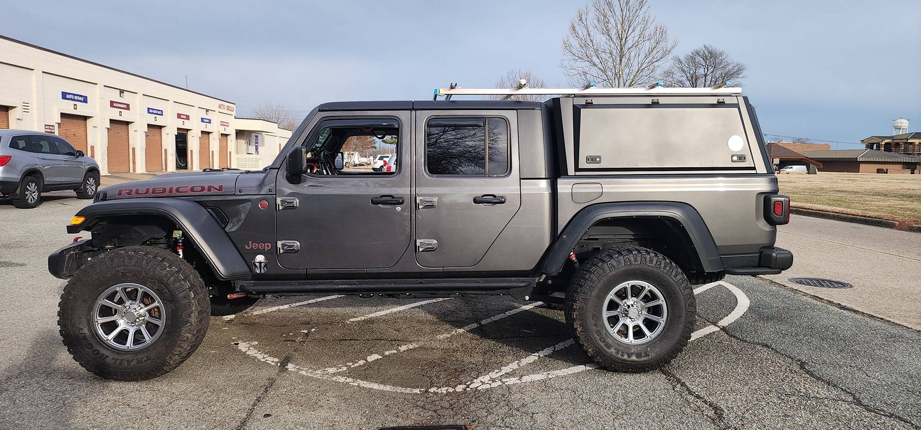

I towed with the cap on one time back last December when we retrieved that TT from the repair shop after they fixed the leaking Stargazer front window (4 months after we dropped it off) under warranty.
We towed it about 60 miles to the storage lot without issue. We never tow it with the water tanks full. We only load about 250lb worth of gear and clothes in the trailer for our trips.
Max CCC for the JTRD is 975, I weigh 225, wife 115, and 24yr old daughter only weighs 90lb. That cap is about 300lbs according to OVS.
I still need to scale everything, but the Gladiator pulls it well without issue. I also upgraded to the powerstop Rotors and pads for HD towing and braking performance. I will probably do the calipers next.

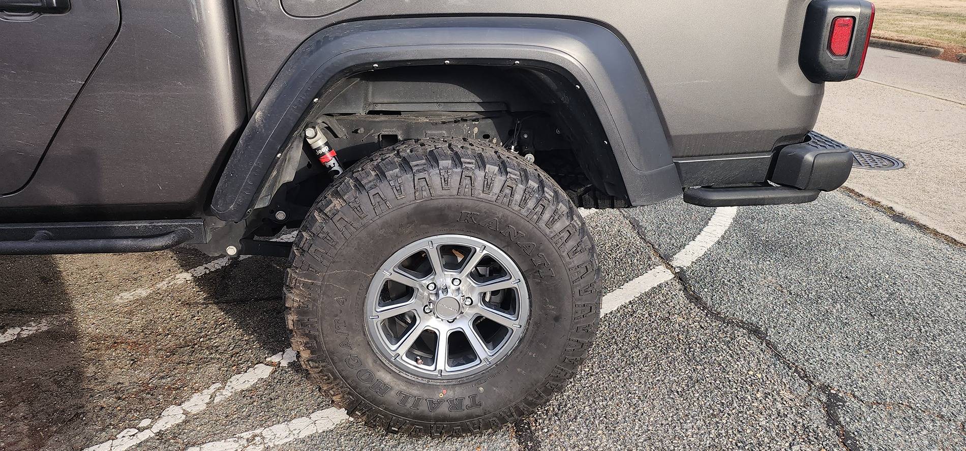

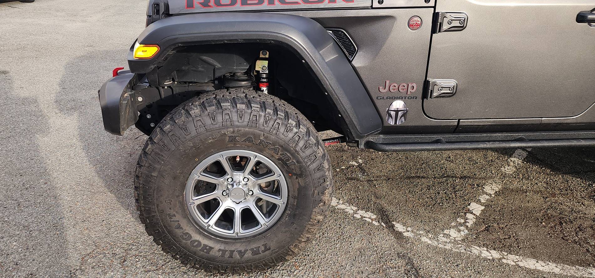

37s no lift is doable on pavement only. No issues at all, truck drove fine on pavement. The moment it gets off camber, they'll rub minimally in the inside fenderwells towardsthe rear. At that point you could potentially trim some fenderwell. I didn't want to do that. And besides I already had most the pieces to my Frankenlift.
I added my lift a week later...
I've recently started to get the bumpsteer/death wobble at approx 40mph, so I went ahead and bought the MetalCloak Adjustable front track bar and their geobrackets. Which I will be installing this weekend. There's no other issues with it except at that speed. It drives straight as an arrow.
If you lift above 2.5" front and rear trackbars are a must to recenter the axles. I have the AEV SC springs 2.5"s with the 1" TereFlex spacer in front and 3/4" Daystar in the rear with airbags, plus the 37s. So, I also added the RockJock driveshaft spacer as well for the driveline angles. Plus the MetalCloak bumpstops kits and their Enduro springs.
I imagine the bumpsteer might be even worse if I didn't put the TereFlex Sport lower control arms in already. They're for 2.5 to 3" lift, that's why I broke down to get the MC geobrackets. Next up will be the sector brace, steering Stabilizer Relocation kit, Draglink and Tierods by MC, their Baller ball joints, and maybe a PSC steering assist kit.
I'm also looking at the MC alignment plates, so I can do my own alignment.
Baby steps... as time and money allows. Built not Bought!
Pro-Tip... upgrade your Trackbar bolts to Grade 8 Zinc plated/galvanized(gold) 9/16 Shoulder Bolts at 3" length, and nylock nuts, with washers. They're wider than factory and eliminate slack in the bushing sleeves. The factory bolts will wander and elongate the mounting holes. Napa sells them.
