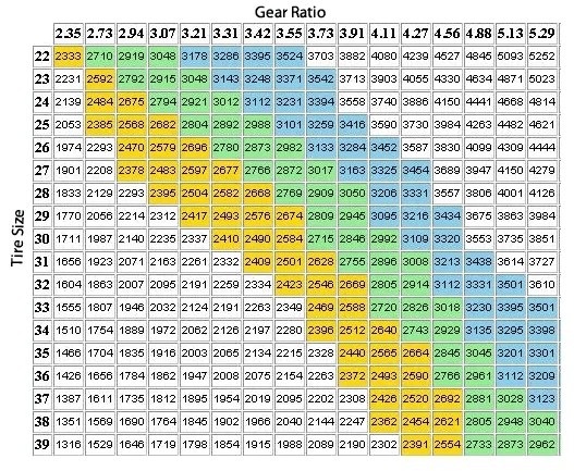

Find someone with the tires you want to run that has done a regear and drive their rig. Especially if their build is similar to yours.
Lots of charts out there.
https://www.exodus4x4.com/jeep-regear.html
Quadratec:
Jeep Gladiator Gladiator sport 37s no lift!? 1650737065788
Yeah I hear ya. I suppose if one isn't towing and doesn't give a darn about gas mileage that is that. I know the thread is about running with no lift but once you have a lift on there with some higher clearance flares and proper spacing, doesn't seem like too much of an issue for mainly light off-road and mostly on road use. What re-gear would you recommend?
