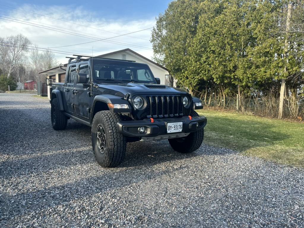

Jeep Gladiator No Lift and 37s? 1729536562664-6
My Mojave before the spacers and bumper etc.. 37's went on with about 600 miles on the odometer.
