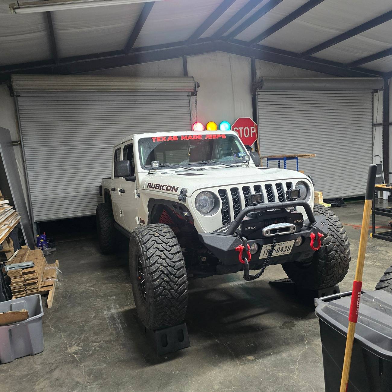

'22 JTR on 37" Toyo Open Country MT w/17" rim. In this shot she had stock springs in the rear w/ RockKrawler 2.25 RRD shocks, front end got a 1.5" RockKrawler level. Springs, ADJ. LCA and the same 2.25 RRD. No complaints with this set up, although I am currently in my shop changing it all up again lol

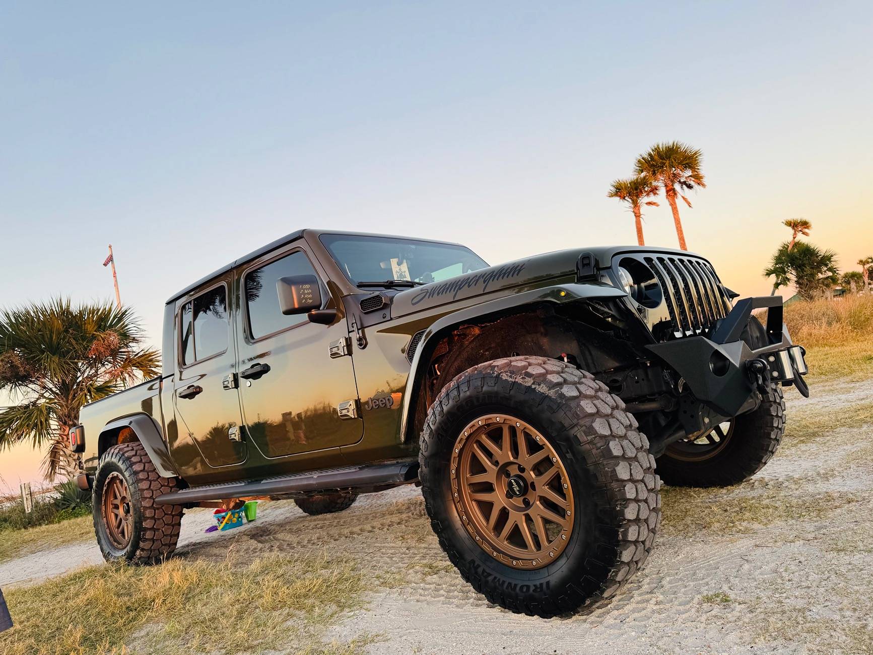

Jeep Gladiator No Lift and 37s? IMG_7015
2.5” Rc spacer in front. 37 1250 20s. No rubbing I did do the “fender chop”. It’s a Willy’s though. My daystar 3/4 rear spacer should be here today. But I’m just putting it on for loaded weight sag.
