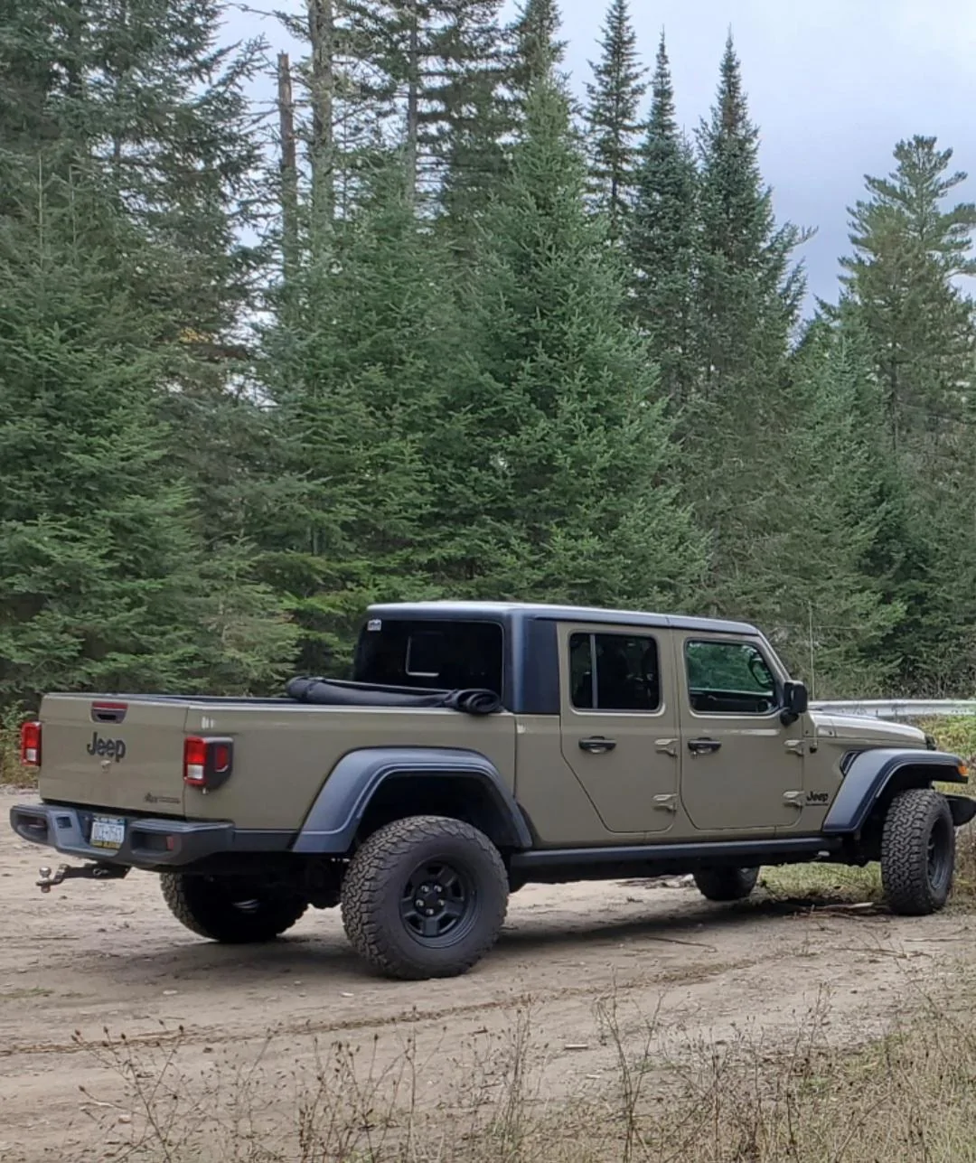

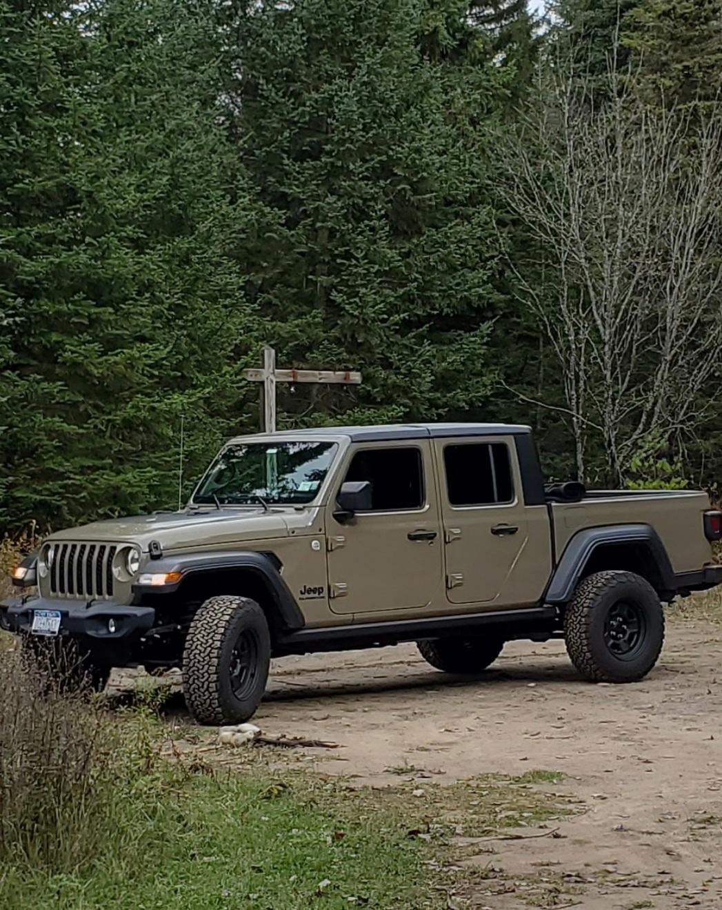

I have BFG 37x12.5 on my stock Rubicon wheels. Now that it's lifted, my steering stabilizer is the limiting factor, steering stops are as far out as they can go without pulling the stabilizer past its travel length. I have plenty of room.
Prior to the lift, I definitely had rub, but only on the lower control arms at full turn, and adjusted the steering stops to compensate: no spacers needed (or wanted)
