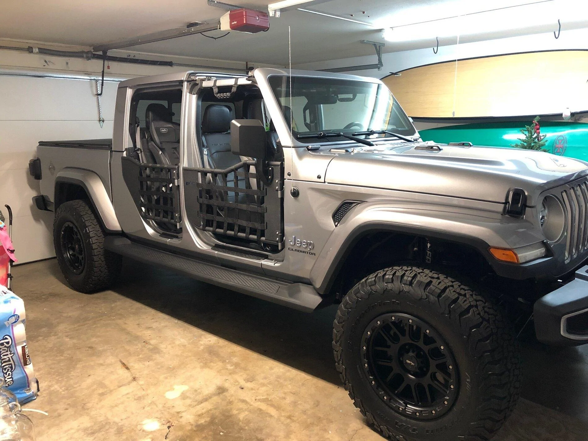

I have a 2.5" lift with 35's. I'm not sure how well 37's would fit

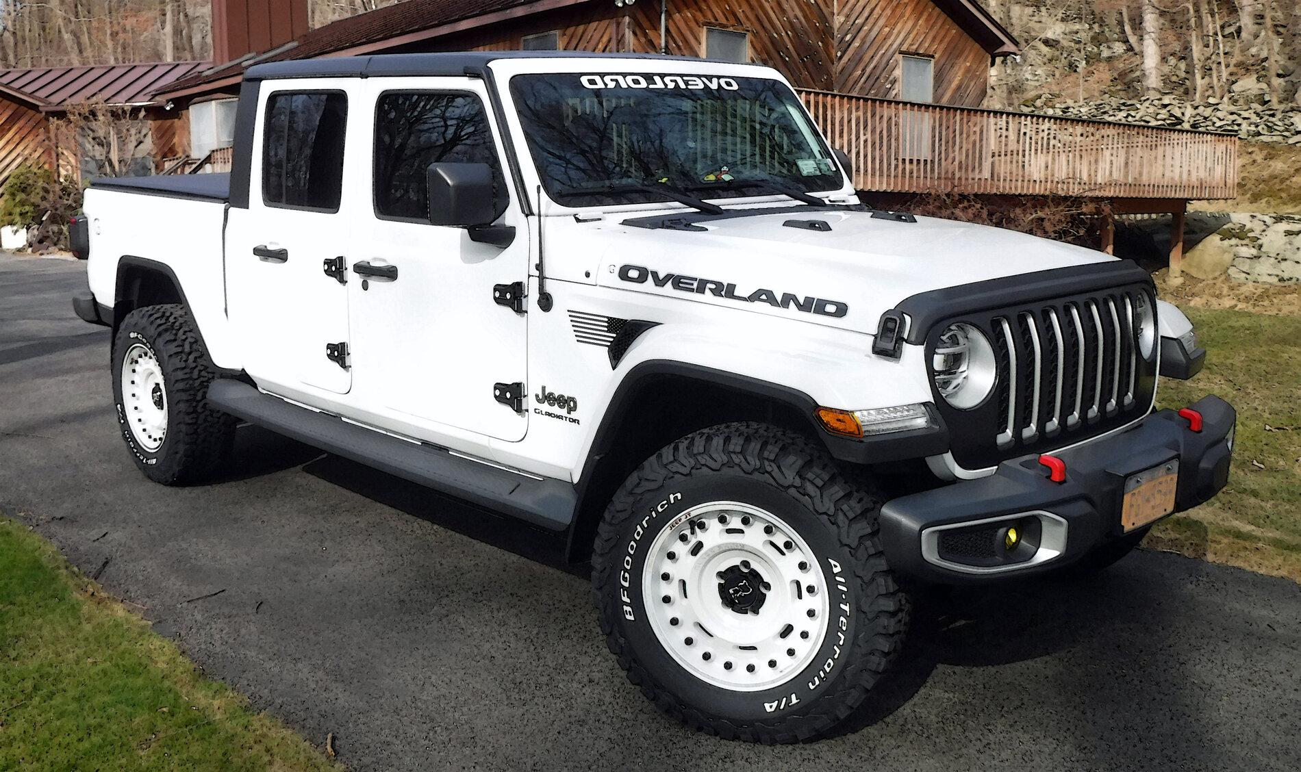

I tow often so a lift complicates things.
I went with 285-65-18 KO2s on Black Rhino rims.
No lift, no spacers, no re gear.
Keepin' it simple.
No rub, rides schweet!
Trails and light off roadin' no issues.

That’s the avenue I’d like to go, did you have to go with new shocks too?
do you think 33”s would fit withnout rub with no leveling kit?
Nope - it comes with shock extensions; see here. Seeing as the OEM tire is 32", I can't imagine another inch making that much of a difference - in fact, I think I've seen a few Overland owners on this board order theirs with 33s. I mostly did it to eliminate the rake, but once I saw how much clearance I had (and seeing what other Overland owners on this board had done with theirs), 35s fit nicely.
