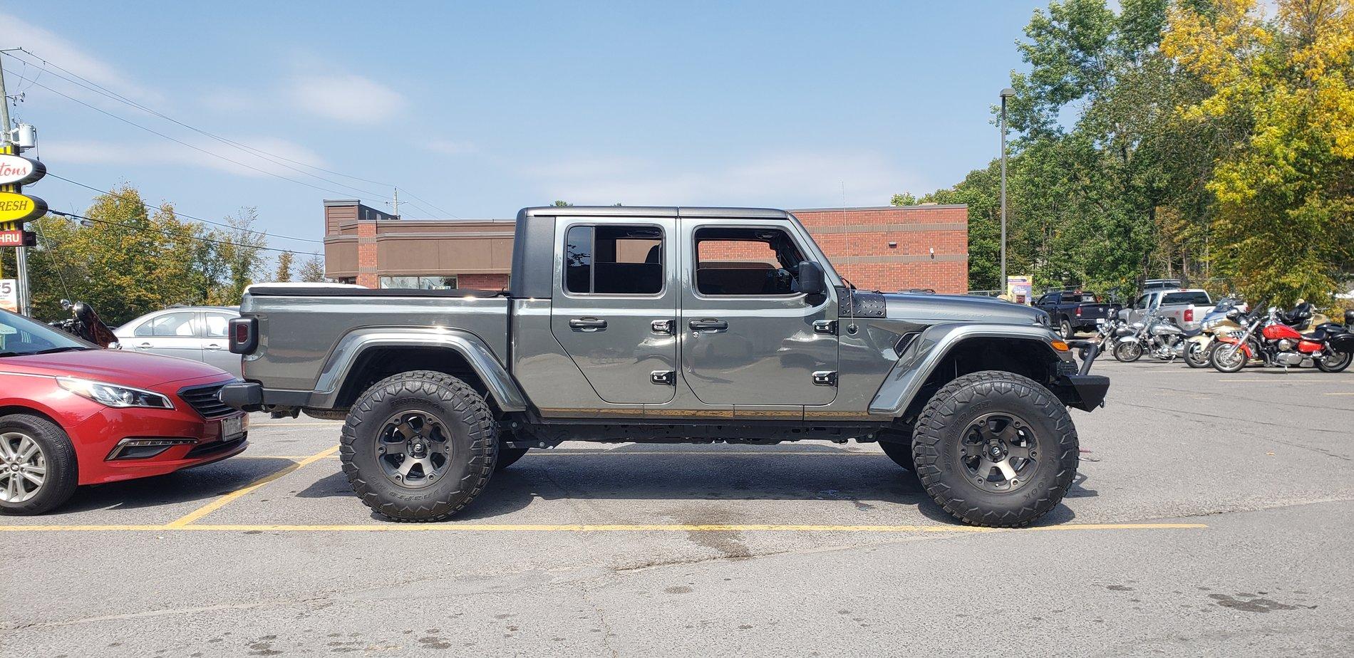

I installed 37's yesterday before receiving the 3.5" lift. Was totally ready to do some modifications but in the end it didn't need much. I removed the panel that goes just below the front indicator lights (actually like the look better now) and trimmed the front splash guards on each side about 1.5". I wanted to show and let people know that the Jeep rides and drives great without the lift. No rubbing with regular driving and very minor rubbing when I took it on the trail. It would only graze the fenders slightly when I pushed it. It'll sit much better once the lift goes on next week.
The wheels I'm running are Fuel Beast 17x10 -18
The tires are Dynapro M/T 37x12.5
Stock height Gladiator Sport

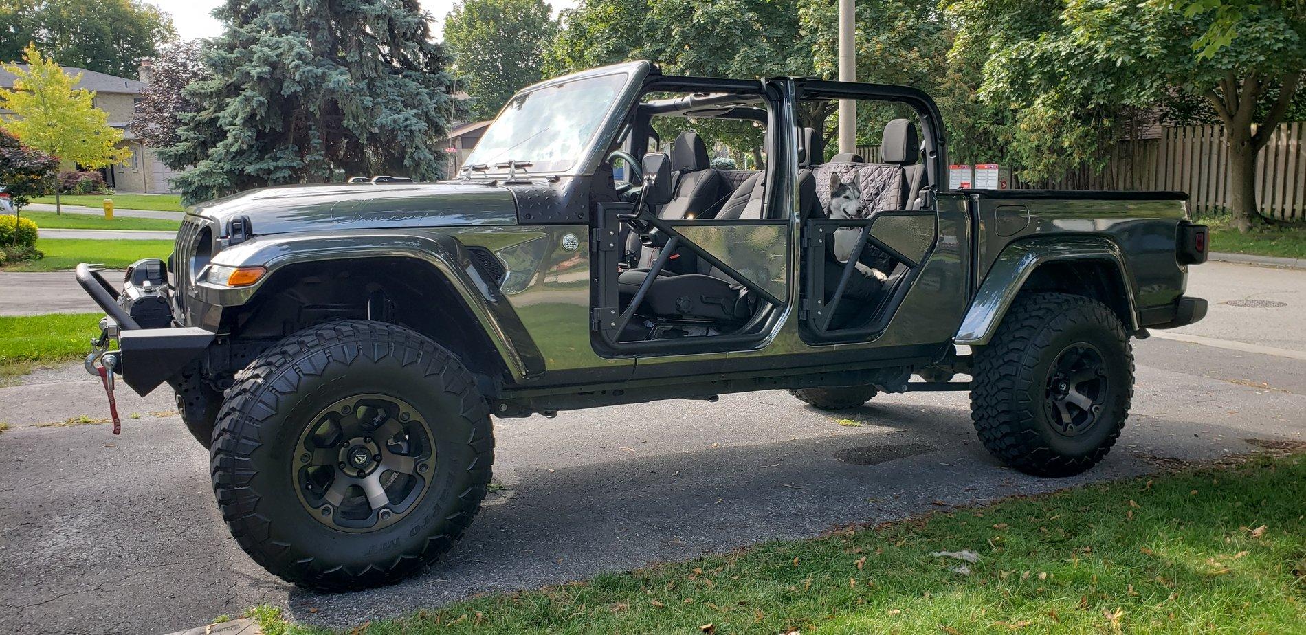

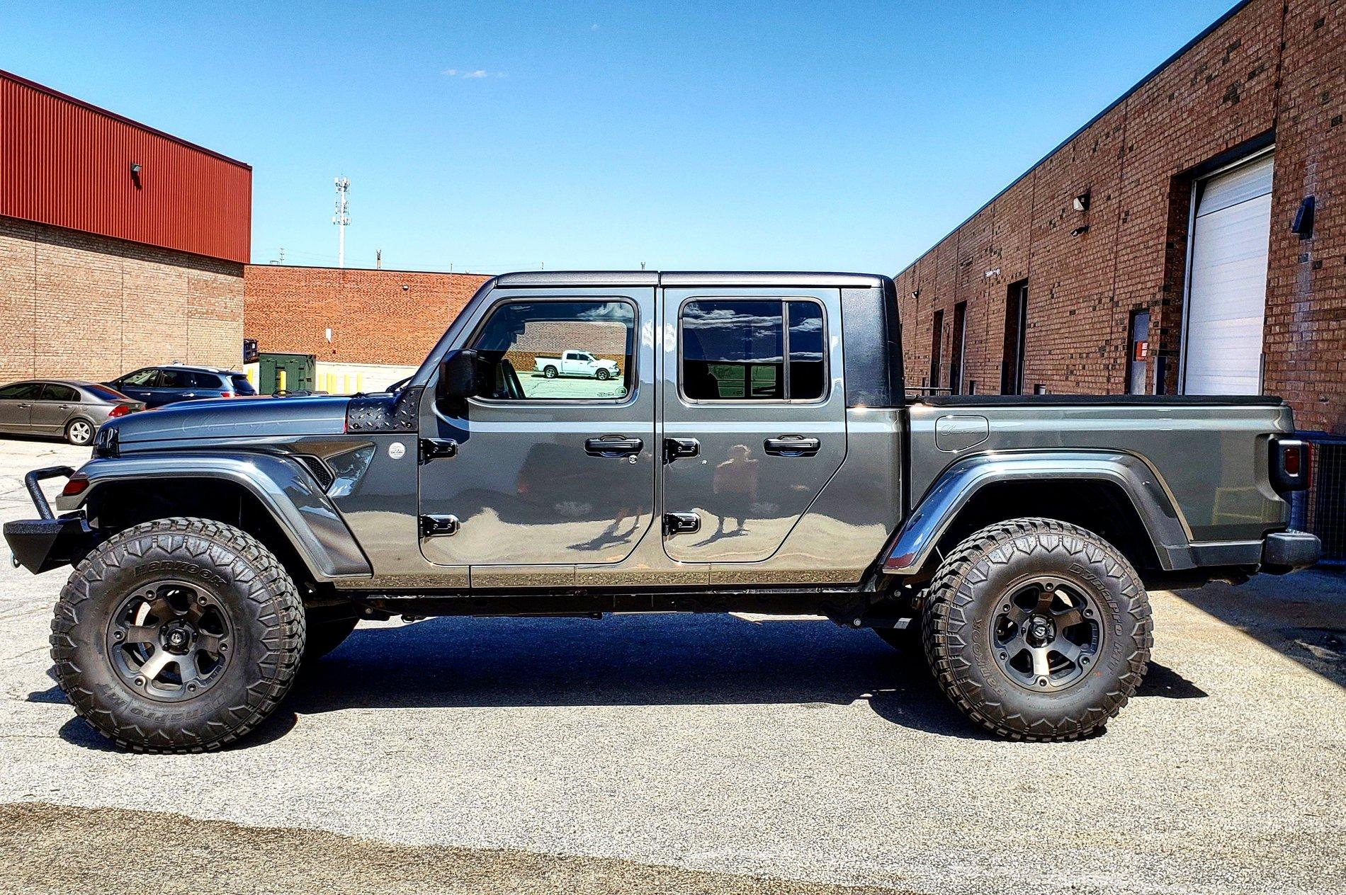

Rewrapped the Gladiator last week in Titanium Chrome. Once it takes a beating I'll install matte paint protection film over top to hide all the scratches and give the finish a new frozen look

Your latest wrap modification really took your JT to a new level!

Love everything about this rig! The black wrap is gorgeous.
What would it cost to wrap just the hardtop?

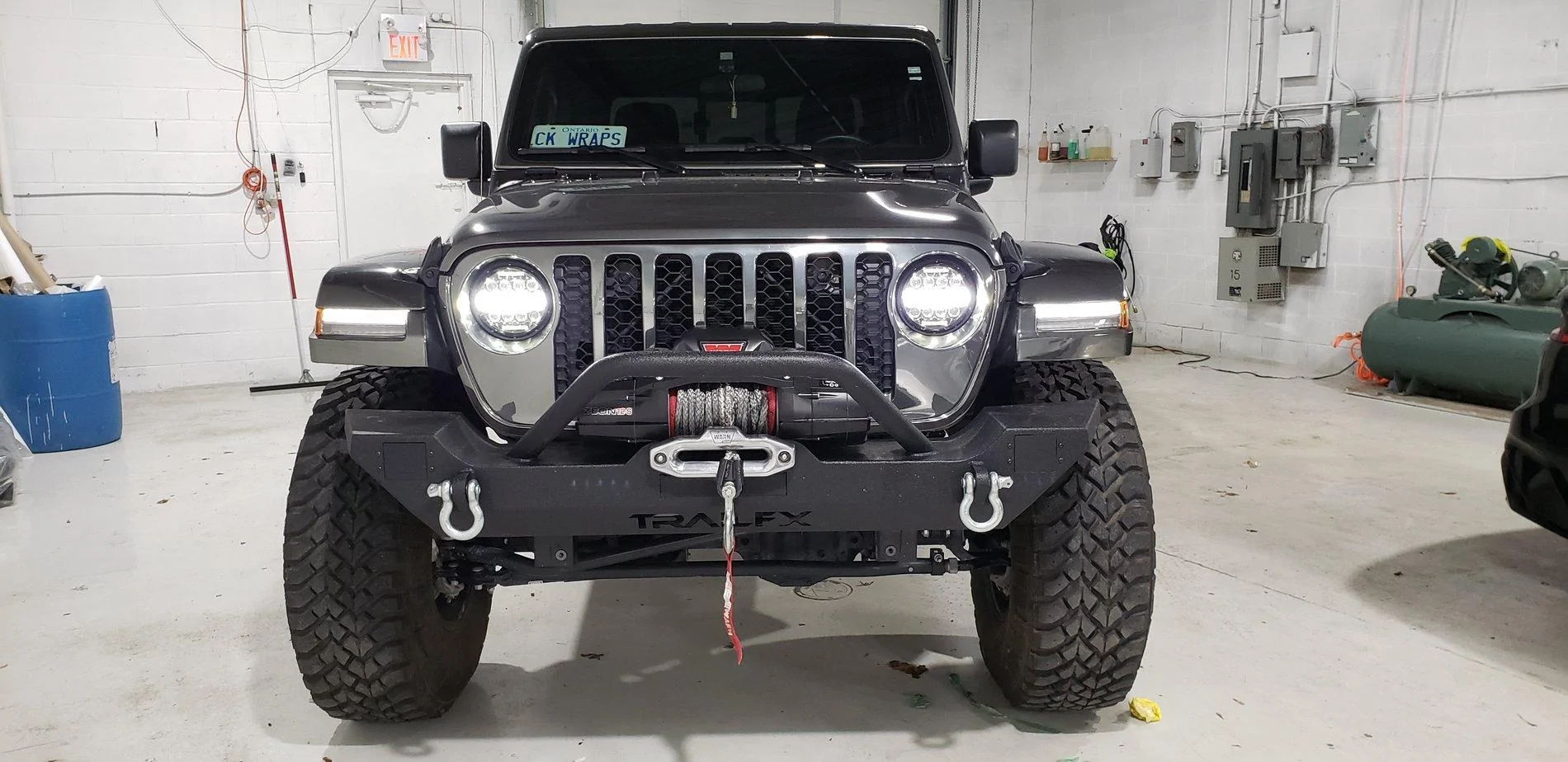

Installed Rubicon fenders with led lights
Man that's a awesome looking Gladiator. I want to add the Rubicon fenders to my Max Tow because it has wider axles and adding aftermarket rims really push the tires way out. Could you please tell me how much more coverage outward of the tires did you get when the fenders were added.. Also did the rear fenders also give you 2 more inches of height like the front.

The front and rear have 2" more tire clearance but I didn't notice any extra tire coverage. The flares don't appear to be any wider than what we originally had / have
