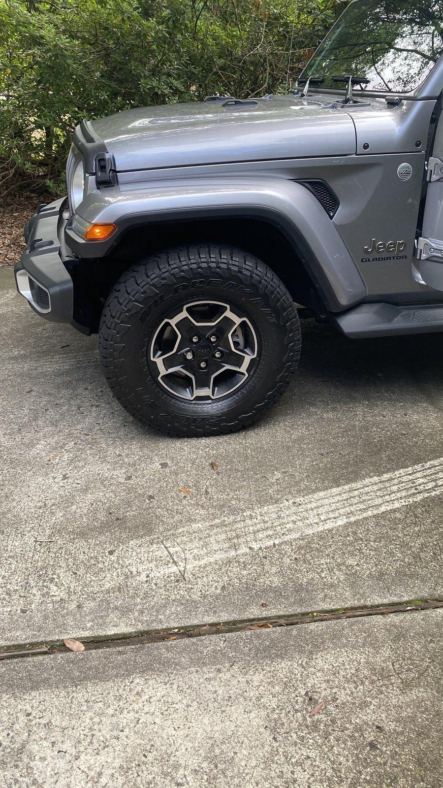

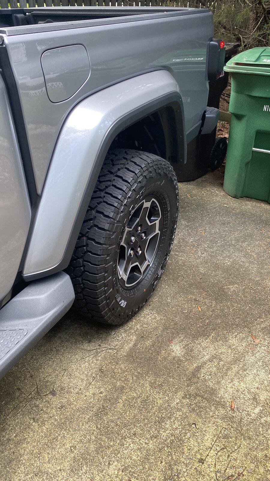

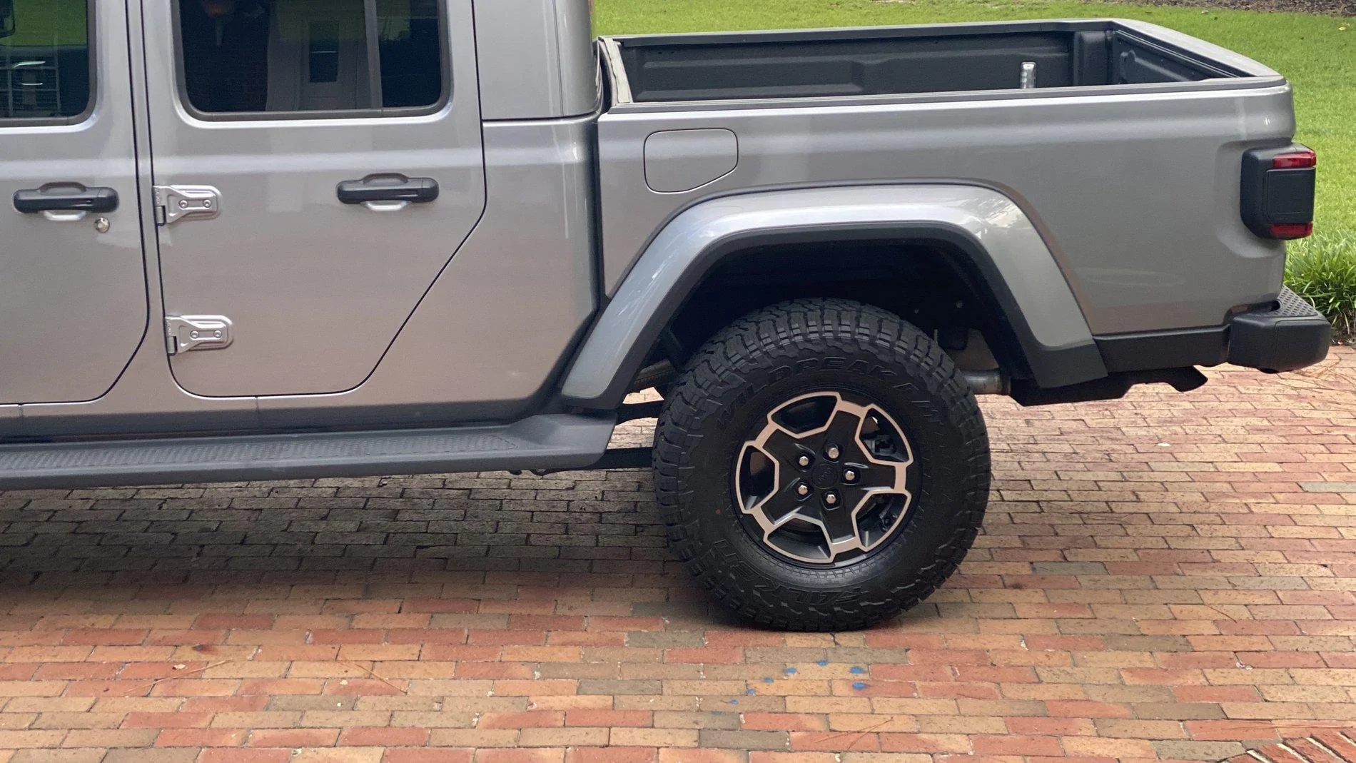

Looking to keep my Sport stock height, but wanted to get bigger tires. Any recommendations on how large of a tire I can go.
I put 285/70/17's on my Overland and have had no issues at all. I think anything bigger without a lift would rub in the front.
