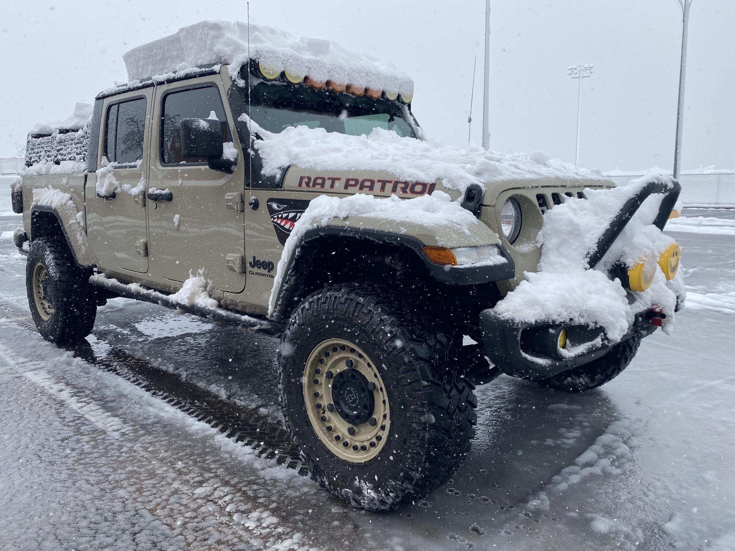

I ran -18 offset 17s when my Sport S was pretty much stock with 33s
I ran Rubicon take offs and a spacer with 33s and got no rubbing, I went to 35s and rubbed a tiny bit at full flex.
I ended up with a 2.5 Clayton Lift and 35x11.5s but I wheel a few times a month in the summer.
