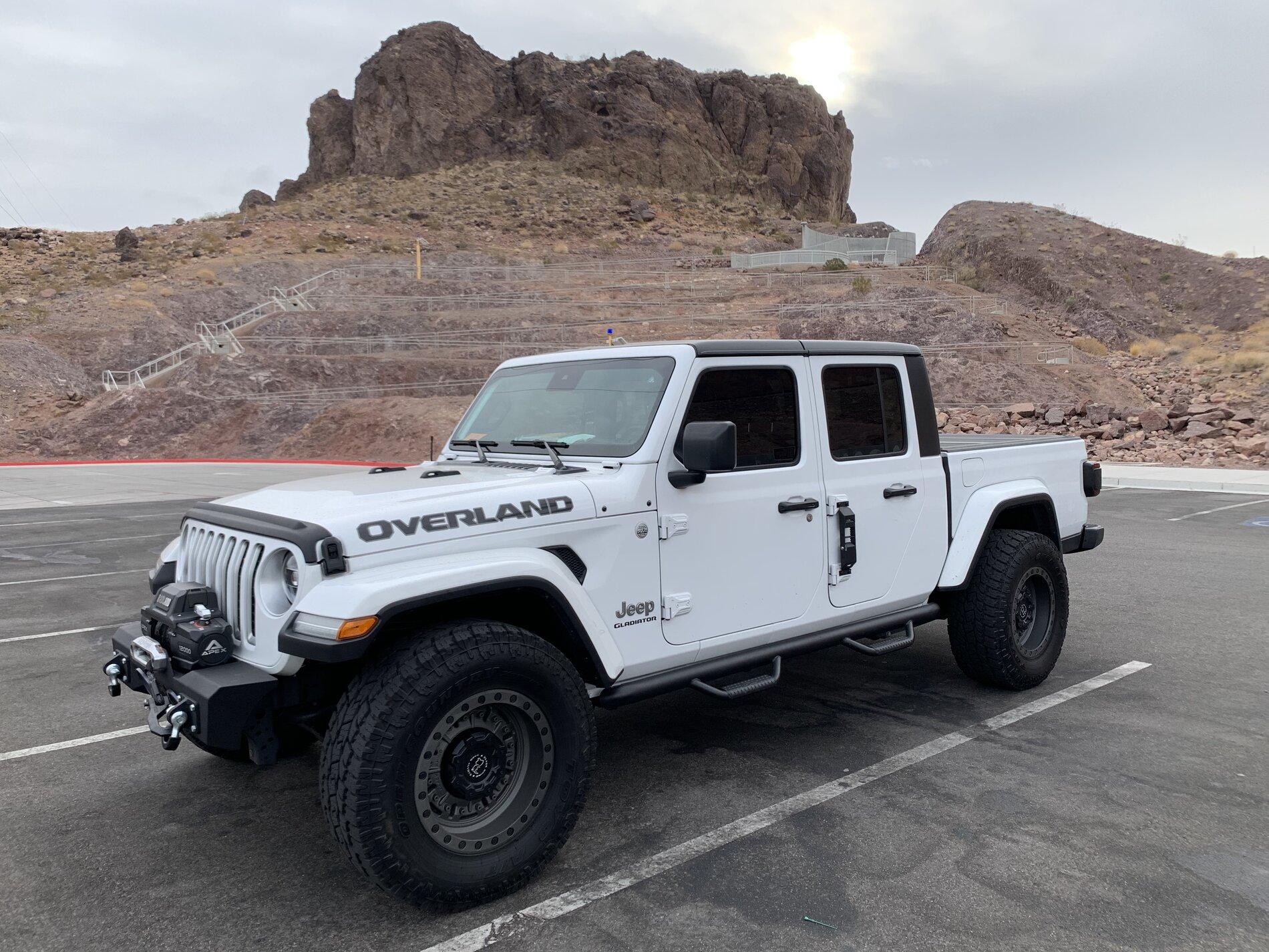

What is the max size tire I can go with an overland without any lift kits or changing out the fender? Don’t want rubbing, want to still be able to off-road and haul as needed. Thanks in advance everyone.

Looks really cool. How do you like that bug deflector? Also what’s that thing on your back door hinge?

35’s or you have to get the Rubicon fenders to go any bigger, even if you did the lift.
Bug Deflector works good. Mostly got it for the aesthetics but has held up well.
I put on some side steps on the back door hinge to climb up the roof. Mostly for aesthetics but planning on adding a roof rack for storage in the future.
