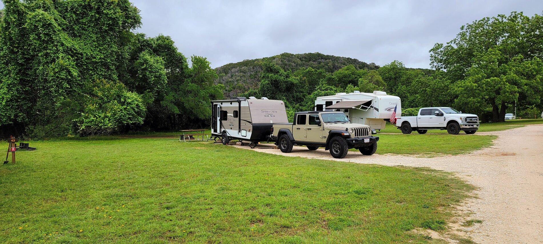

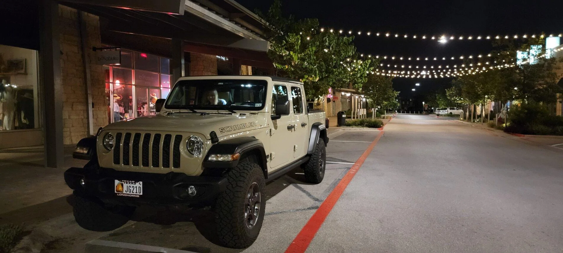

I have a max tow. Bought shocks and springs off a rubicon for $300 on Craigslist. Added a half inch spacer to the front . Now I run Kenda Klever 35x10.50. Tow 5K pounds all over TX and CO without issues.

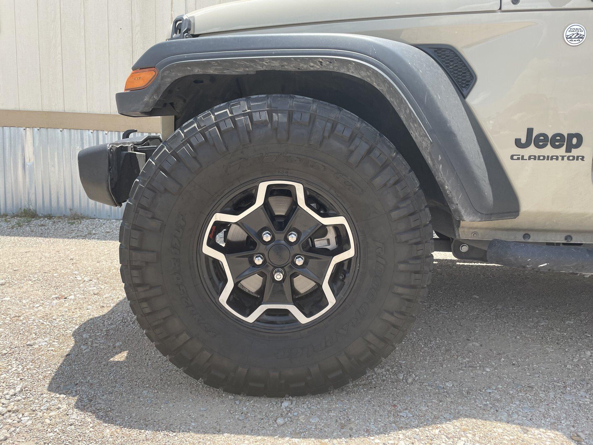

Completely stock Max Tow with 37x12.50r17 Nitto Ridge Grapplers on OEM Rubi wheels. No issues so far including driving all over muddy and primitive construction sites since we are one of the first trades out doing work. Planning to add a lift or spacer at some point but for every day driving this will suffice. Down to between 16.1-17 mpg from stock.
Wow then 35's should be no problem!

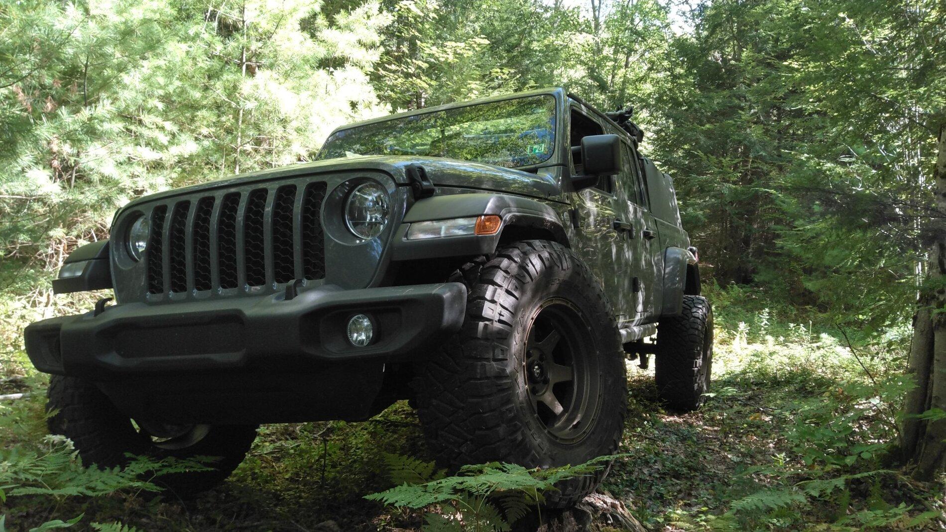

Just added Micky Thomson Baja Boss A/T 255/85r17 (35/10R17). Very aggressive looking ATs compared to Falken ATs.
Pictures are with stock Rubicon suspension and stock wheels.
Very cool, those just came out o believe. Did they take much weight to balance? Are they quiet?
Mac,
It looks like the tire shop used about the same amount or less weights to balance the tires compared to Falken ATs.
I don't have enough miles to say that they are very quiet tires, but I thought the Falken were very quiet, and I don't think these will be as quiet. But nothing like an MT. I am willing to compromise little bit of tire noise for how aggressive these are. Also, I am really liking the pizza cutter look. As far as my butt dyno goes, I don't feel any loss of power due to larger size. Maybe due to how skinny the tires are?

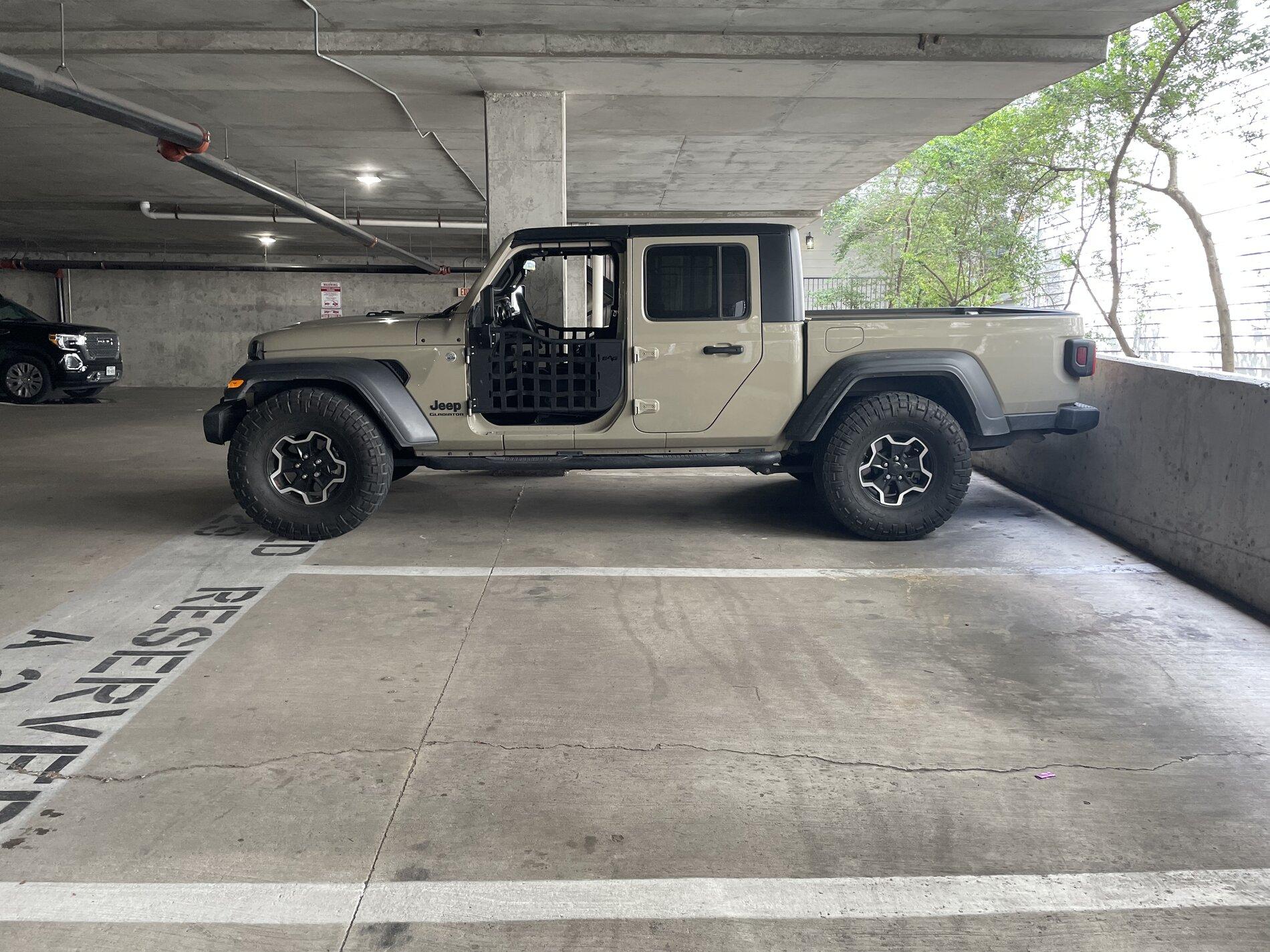

^ Alot depends on the offset of your wheel. I ran -18's with 35x12.5's for almost a year with no lift on my Max Tow sport, and never touched the inner fender liners. It'd rub the outer edge of the front fender at flex, but that's about it.
