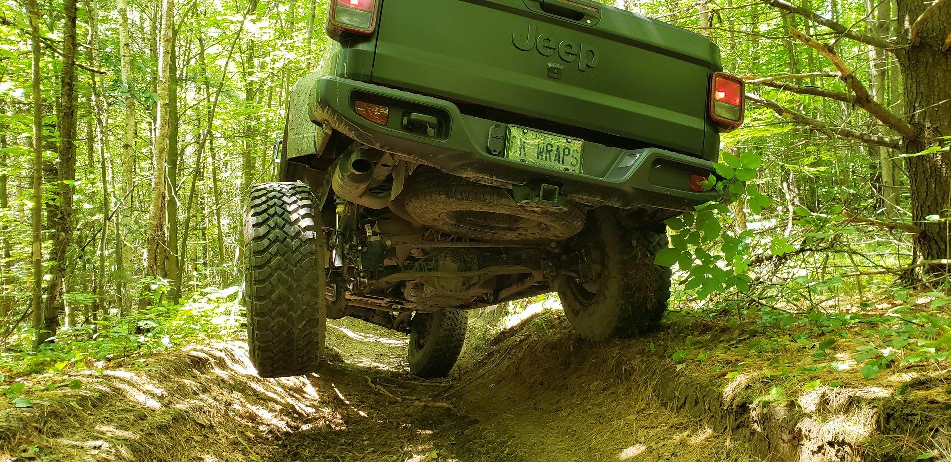

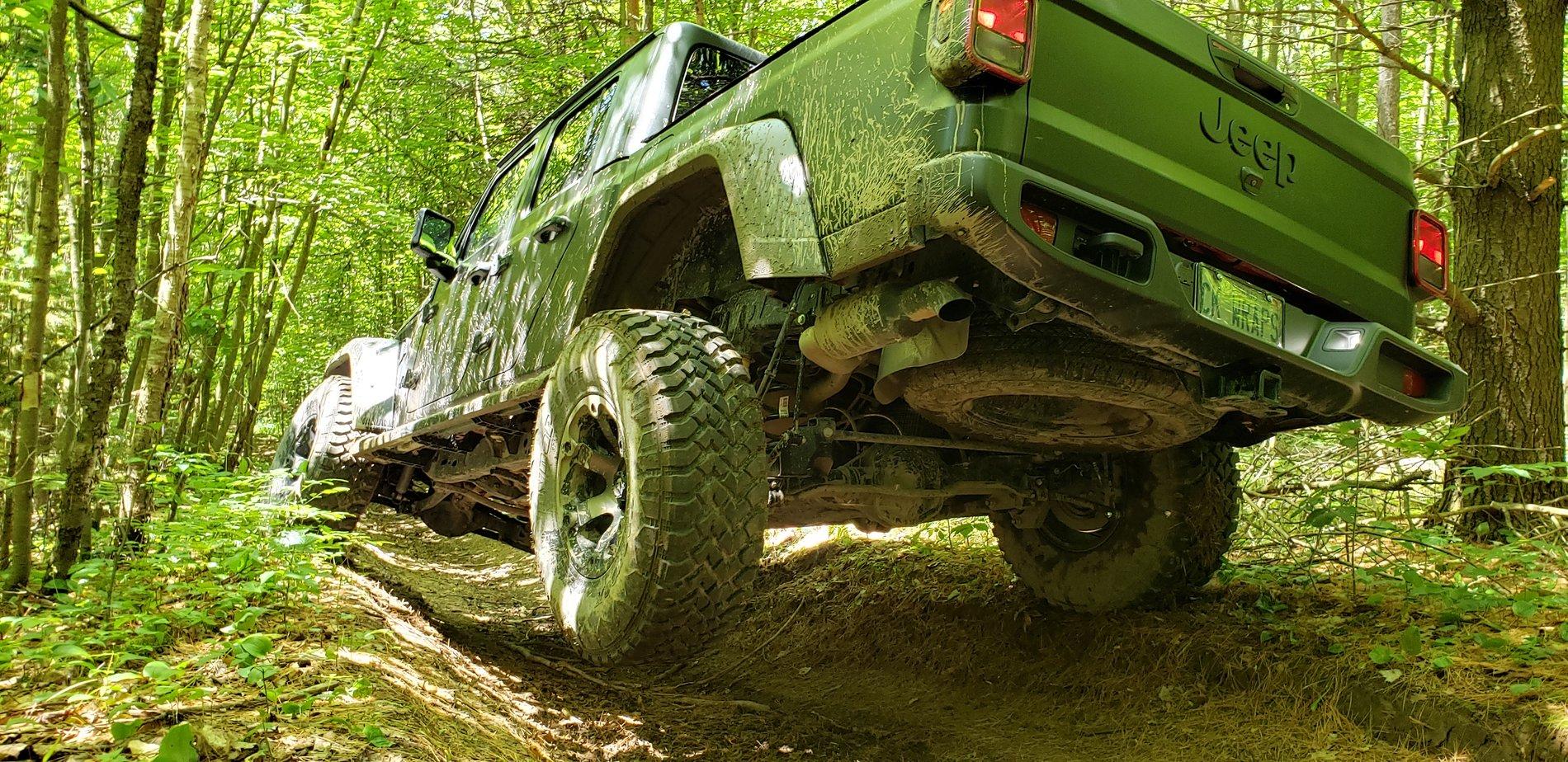

Either way, took it out today and yesterday. The jt handled a lot with the 37's and the 3.5 lift, overall I'm pretty satisfied for now. I've been trying to order the 6.5 Evo lift but my shop here hasn't gotten back to me yet.

Either way, took it out today and yesterday. The jt handled a lot woth the 37's and the 3.5 lift and overall I'm pretty satisfied for now I've been trying to order the 6.5 Evo lift but my shop here hasn't gotten back to me yet.
I'm surprised the 37s are rubbing with a 3.5" lift. I was just about to ask where they rubbed ... then I saw this pic.
Is this spot in the rear the only spot that rubs? Does the tire just graze the fender flare, or does it make significant contact?
Great looking rig by the way!
That's about the only spot it made contact with. Depends on what you think significant is . It'll make contact enough to actually pop the fender clips off. The fenders remove so easily I've debated removing them before I head out each time
Moving the flares enough to pop the clips is significant in my book. My guess is that 35s might just brush the flare then. Thanks for sharing your experience/observations. I planned on getting 37s with the 2" Mopar lift. I'll have to get more intel before I pull the trigger on wheel/tire upgrades.

I had a few more thoughts on the RUB this morning.
Getting quick disconnects for your front sway bar will give you a little more articulation up front which will require the rear to articulate less. This may reduce/eliminate rear rub.
Adding a little height to your bump stops would reduce travel enough to eliminate rubbing.
Either or both of these solutions would probably serve your purposes and be more cost effective than adding more lift height. More lift height would require some additional geometry correction and raise your center of gravity too.
Is there somewhere I can get lockers and a sway bar disconnect for the JT? I tried looking but my search wasn't successful.
The front seems to be good, it's only the rear, and is the picture where it's rubbing the opposing wheel is completely off the ground

Youre right, I wouldn't recommend taking it through any kind of extreme terrain without a lift. I did take it off road and it was rubbing while stock height. I took it out again yesterday, first time since the lift and it was much better but still rubbed slightly
JL Wrangler stuff should be a direct fit for the swaybar. Not sure about the rear axle in yours...but something should work. Try some of the shops like Northridge.

How do the Rough Country shocks
The shocks actually seem half decent. Definitely a better ride than the stock ones. Don't know if they'll last but I'm trying to get an Evo lift. I'll check that shop out. Where abouts are they based?
