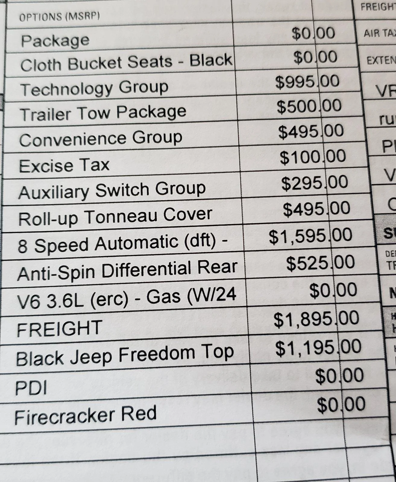

Ok, so I know I have the Trailer Hitch Zoom. But I don't have the 2 pieces flares like the Overland and Rubi come with

This is what I got

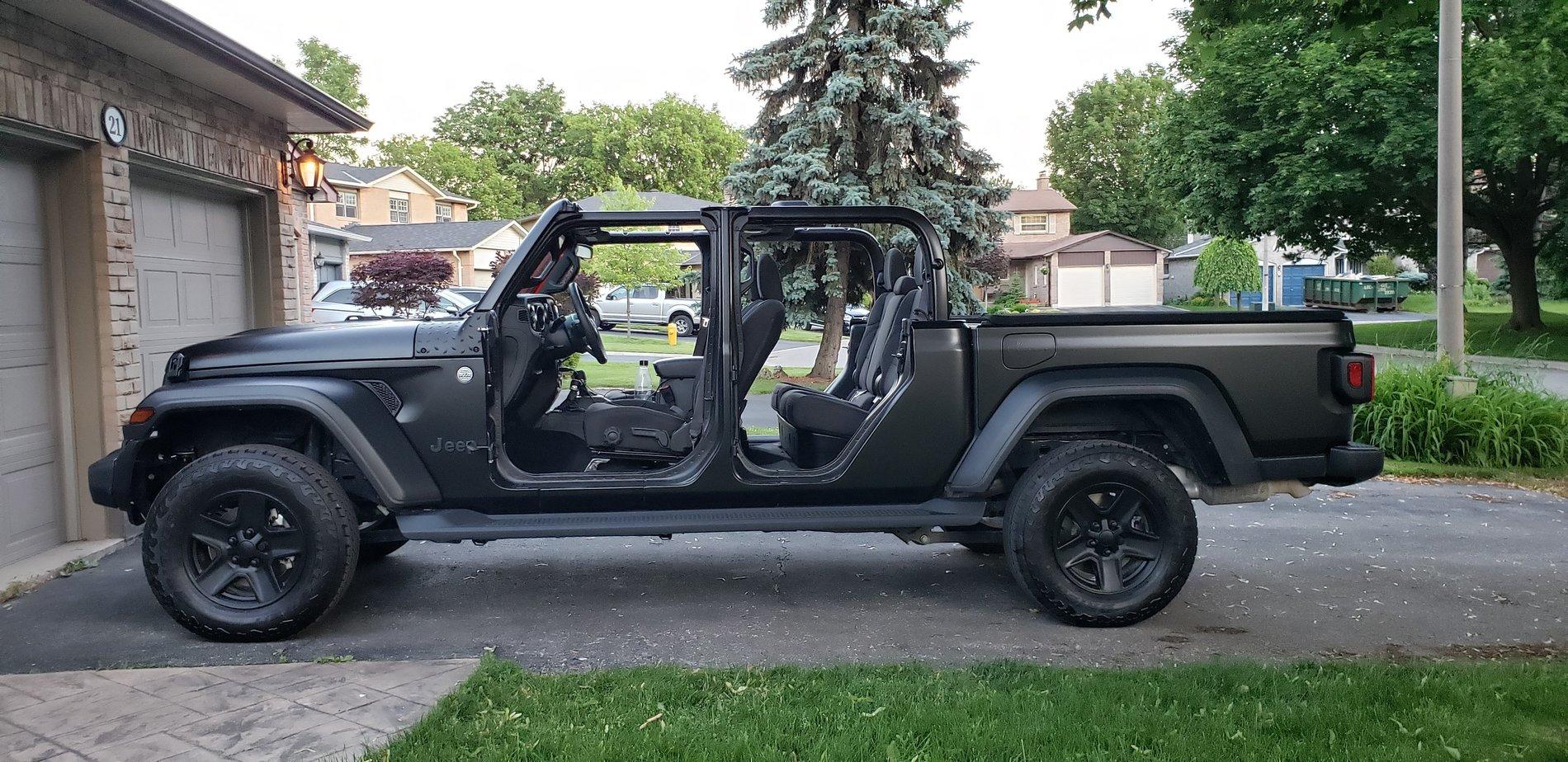

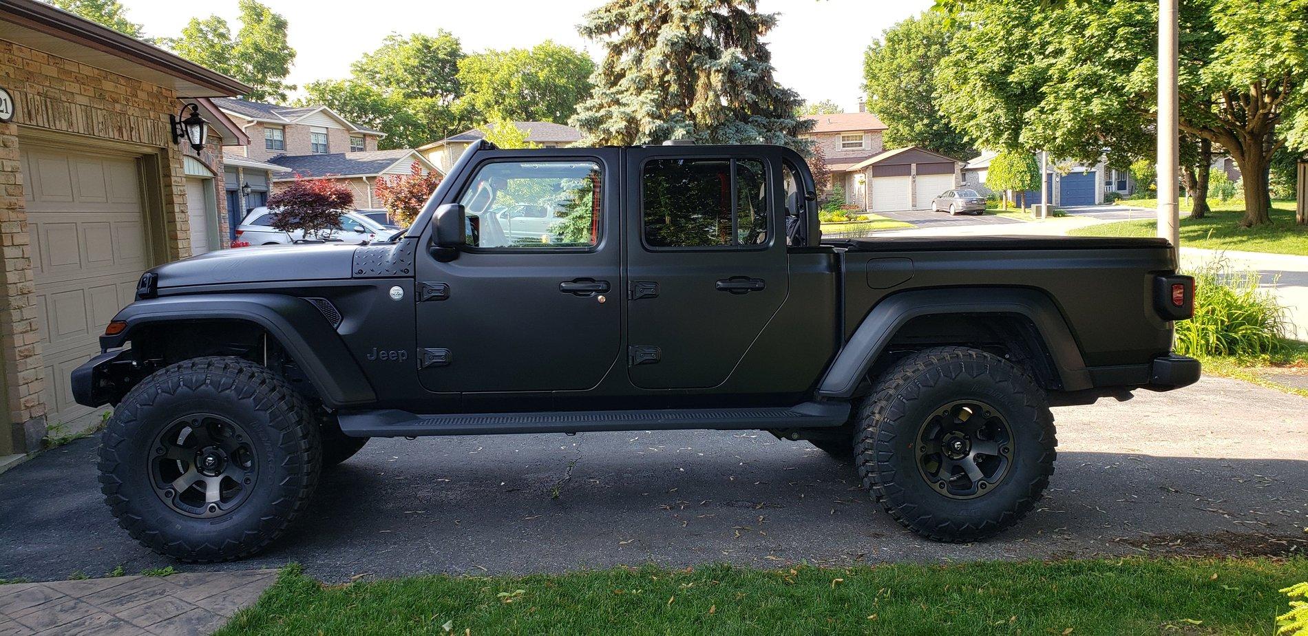

I believe that is a Sport S with Max Tow... it has the integrated daytime running lights in the fenders and the stock tires look like the Dueler A/Ts that come with the Max Tow package.
BTW... your rig looks a lot better with the lift! It makes a big difference in my opinion.

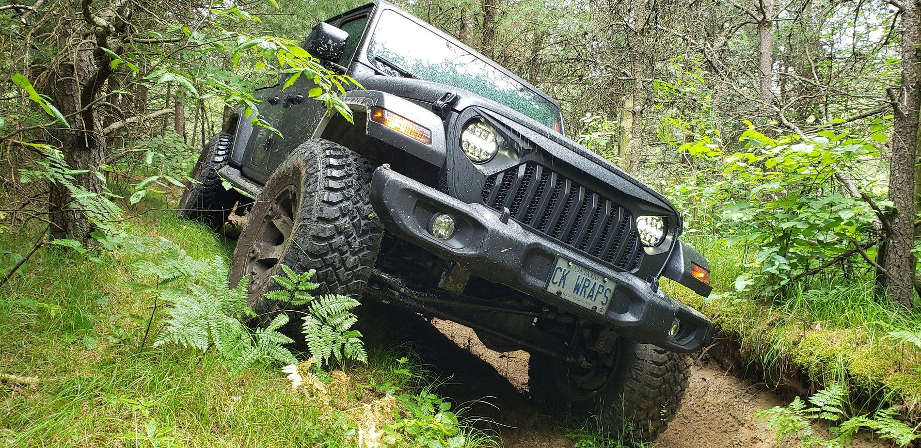

I’m going to challenge the headline of the story on this forum which links to this post. While the owner of this Jeep has indeed put 37’s on his JT with only minor trimming, there is absolutely no way this is effective for moderate or more extreme off roading. Those fender flares would not last long when the suspension gets crossed up in ruts. I have no problem with people doing the minimum required to fit big tires (I actually prefer the LCG approach), but the “Jeep Gladiator has now been shown to fit a 37″ tire with no need for a lift kit” headline is misleading.

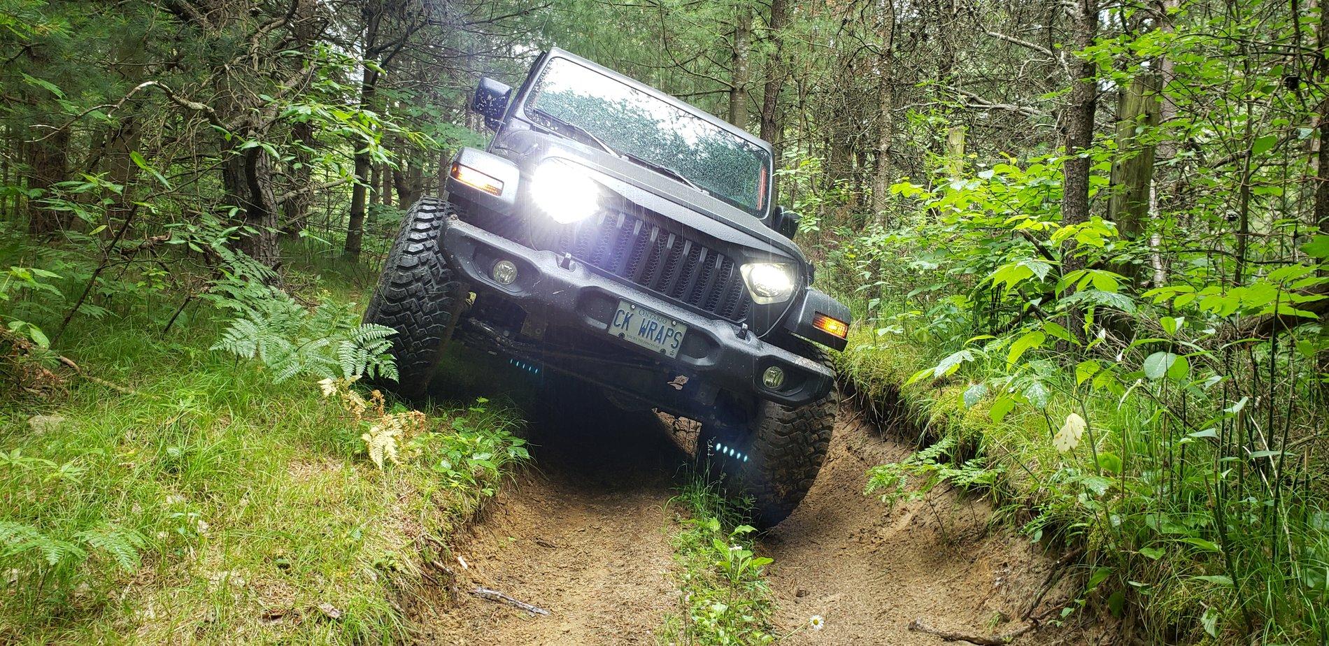

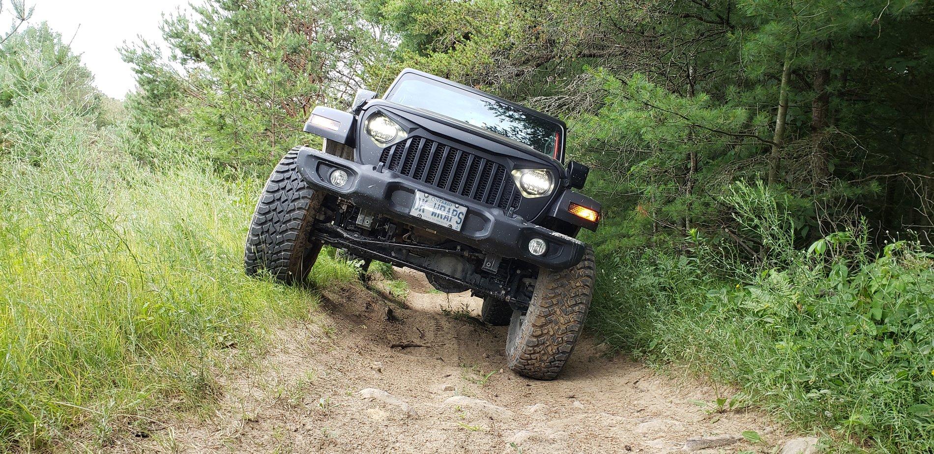

Youre right, I wouldn't recommend taking it through any kind of extreme terrain without a lift. I did take it off road and it was rubbing while stock height. I took it out again yesterday, first time since the lift and it was much better but still rubbed slightly

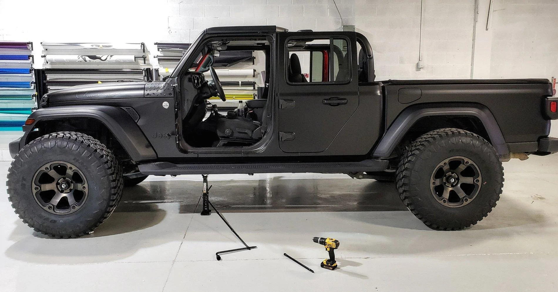

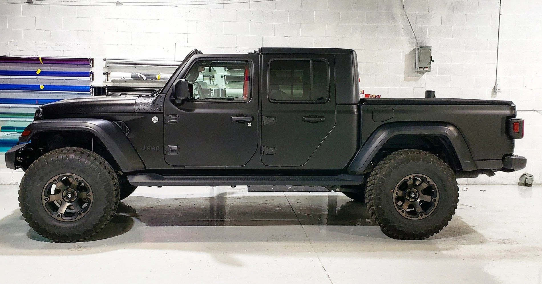

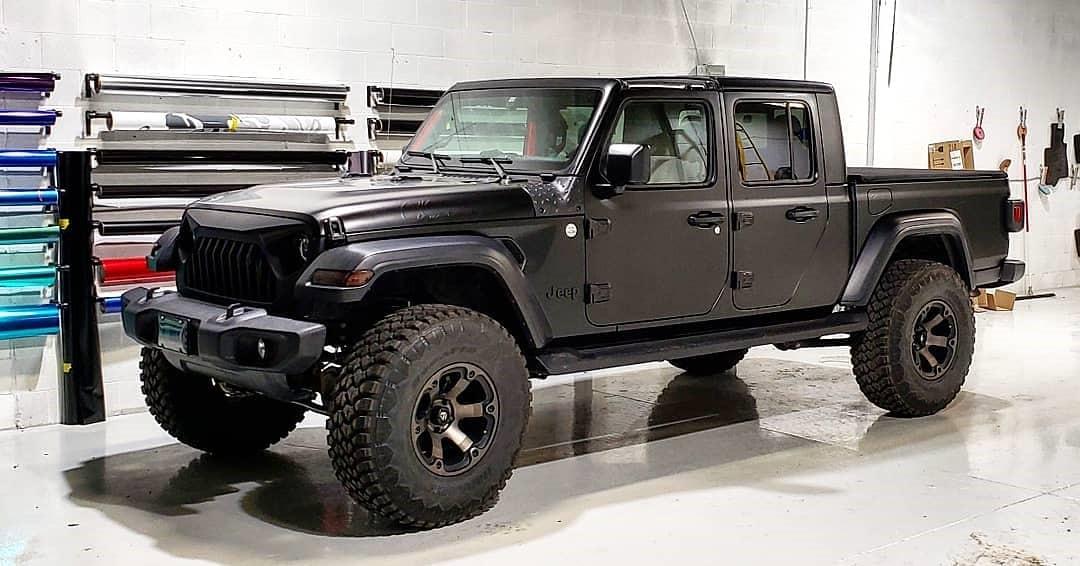

I installed 37's yesterday before receiving the 3.5" lift. Was totally ready to do some modifications but in the end it didn't need much. I removed the panel that goes just below the front indicator lights (actually like the look better now) and trimmed the front splash guards on each side about 1.5". I wanted to show and let people know that the Jeep rides and drives great without the lift. No rubbing with regular driving and very minor rubbing when I took it on the trail. It would only graze the fenders slightly when I pushed it. It'll sit much better once the lift goes on next week.
The wheels I'm running are Fuel Beast 17x10 -18
The tires are Dynapro M/T 37x12.5
Stock height Gladiator Sport
