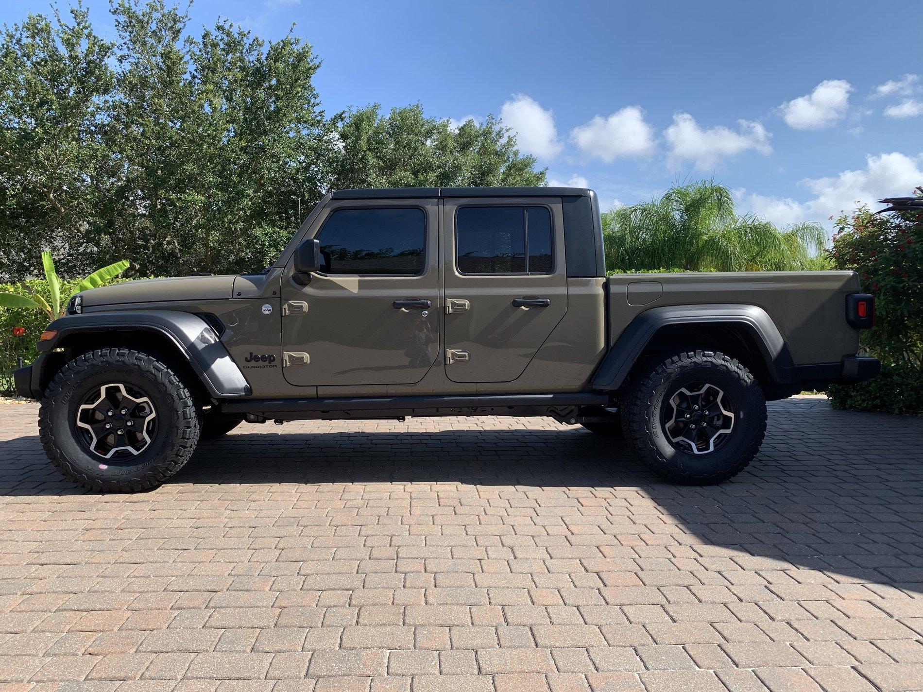

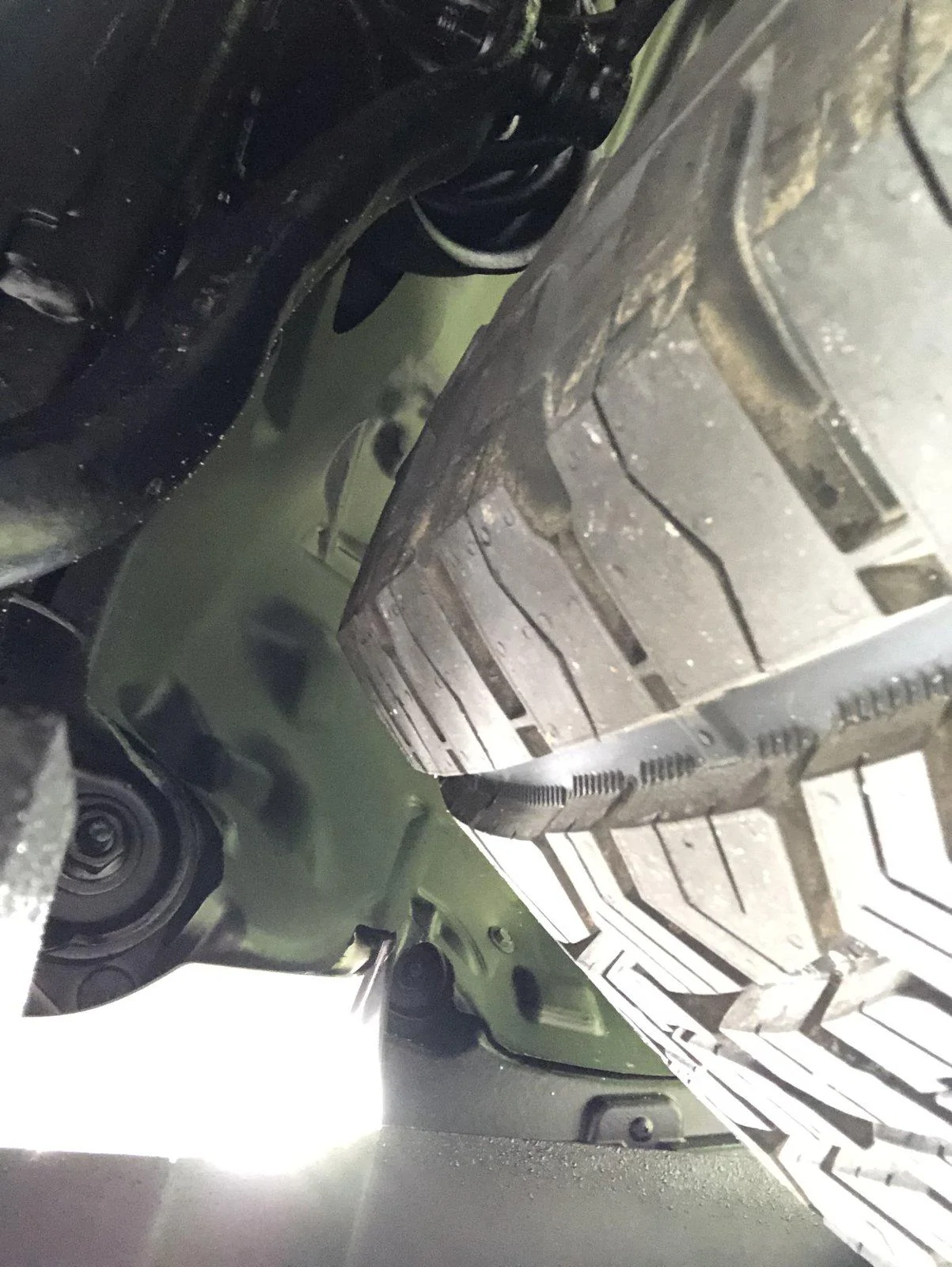

315 Bfg’s. No trimming or rubbing. Stock height Sport S.
Wow imagine that, I thought I could of fit them without rubbing but trimmed mine to be on the safe side because I was planning on replacing the front bumper anyway. Almost seemed like someone was calling me out in a earlier post, maybe not;) The Jeep looks great by the way:like:

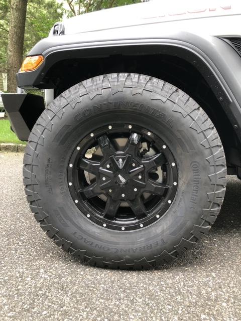

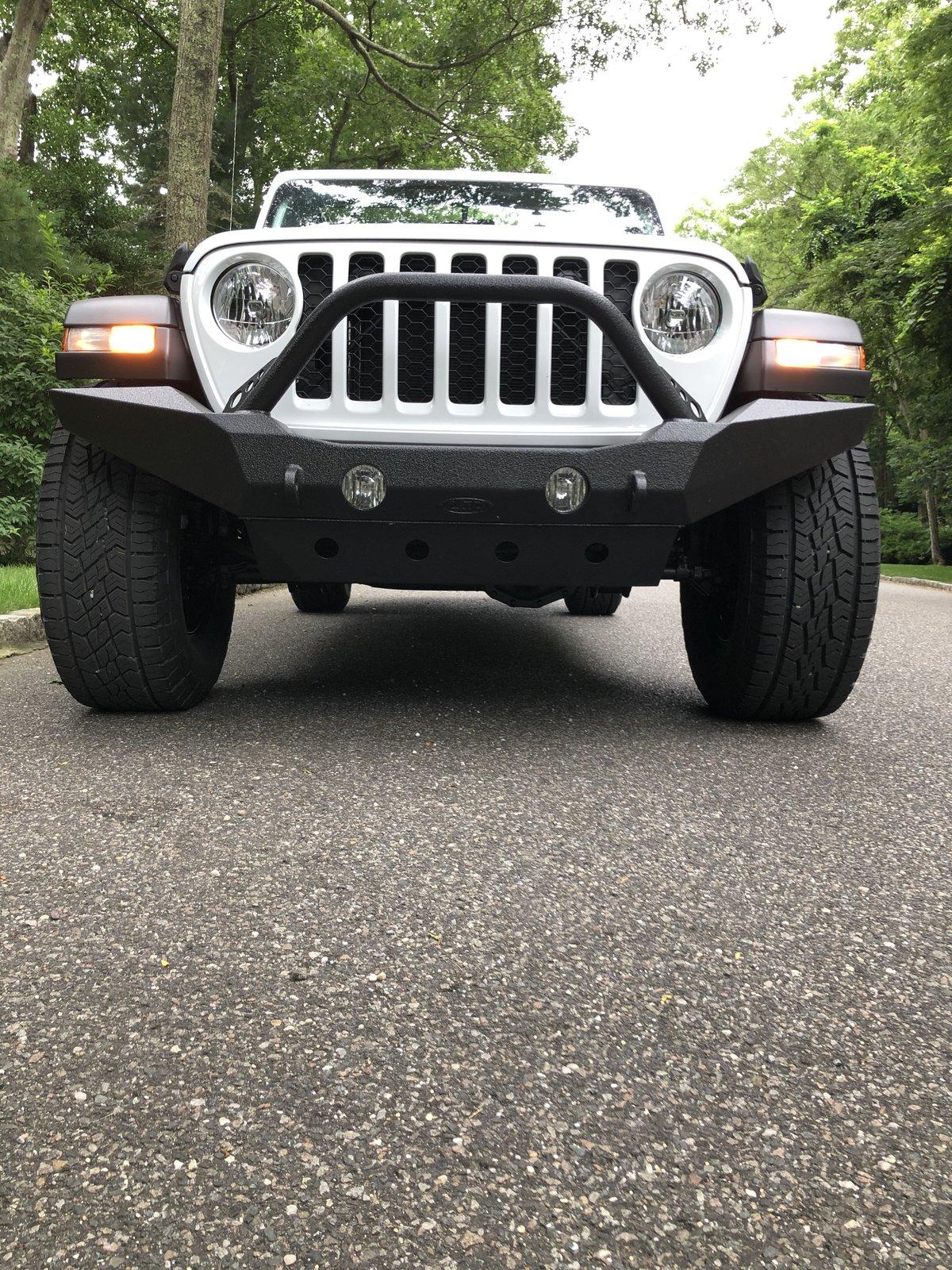

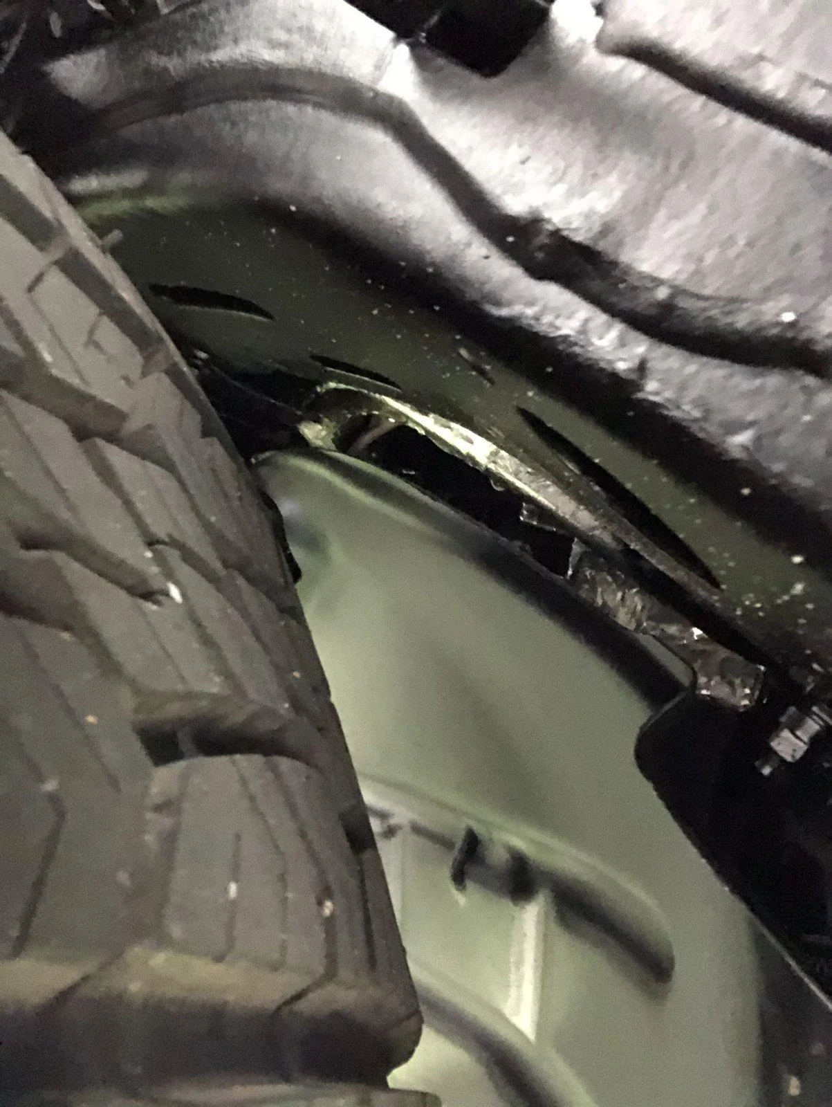

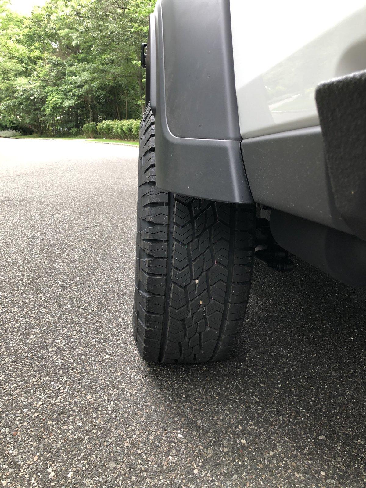

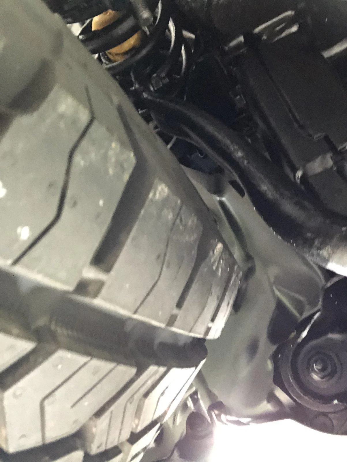

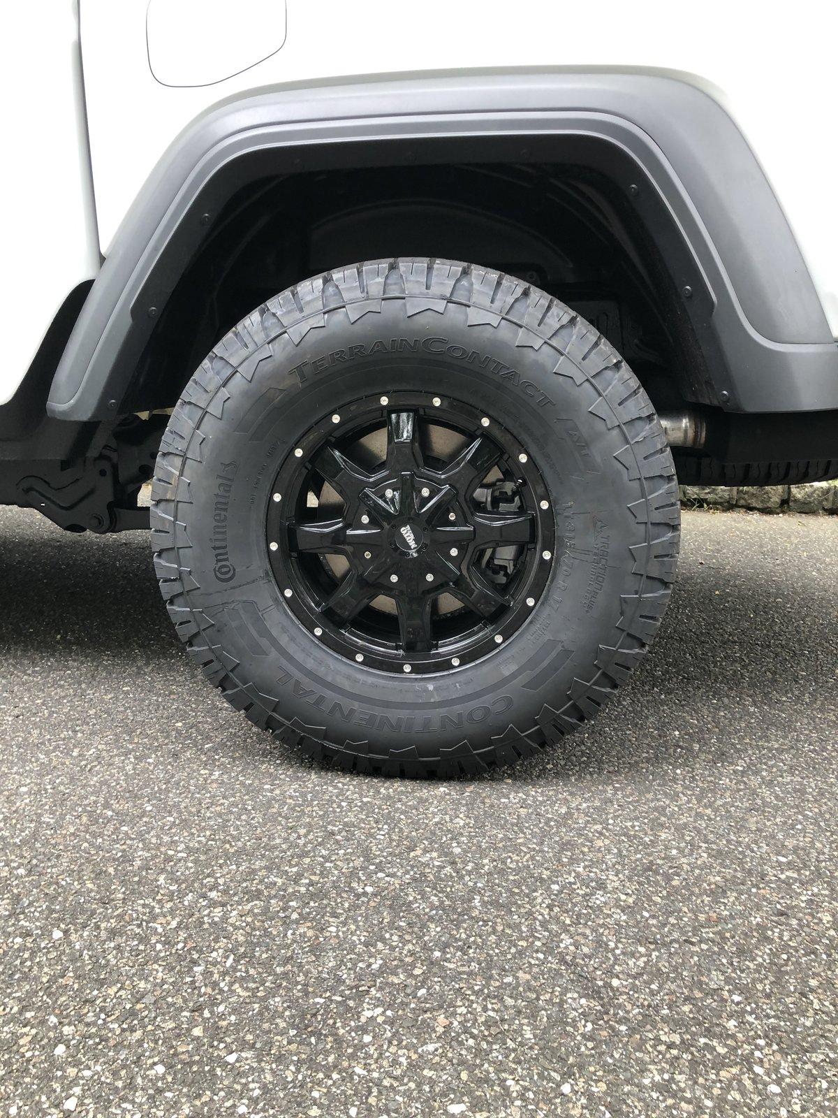

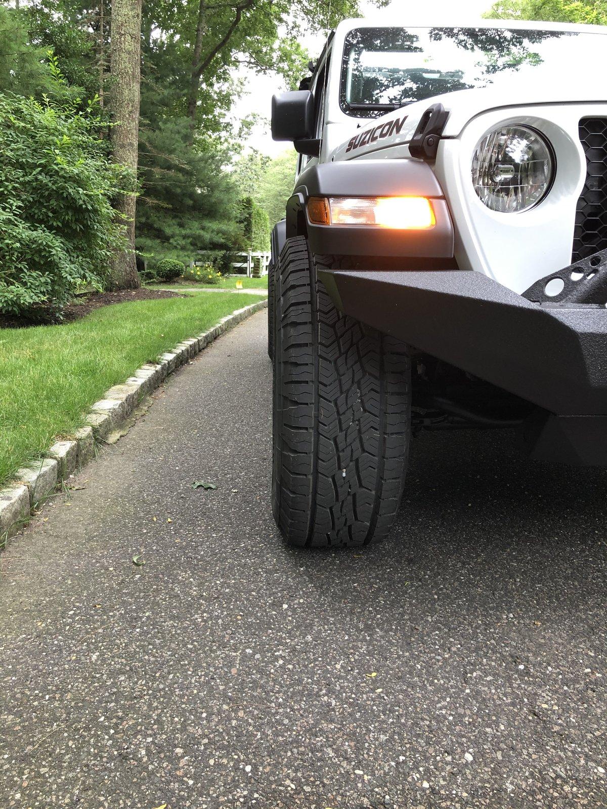

Hey guys, I just wanted to post a few pics of my Gladiator build. It's a sport with the Max Tow package. I went with Moto Metal rims that are 17 x 8 with 6.062" backspacing and 40mm of offset. The tires are Continental Terrain Contact A/T's size 315/70-17. There is zero scrub radius with this combination and the tires tuck inside of the fenders with no lift. You can see how much clearance I have with this combo. I set the Jeep up this way primarily for on road and beach driving . Everything works fine and at 40psi the truck rides great.
