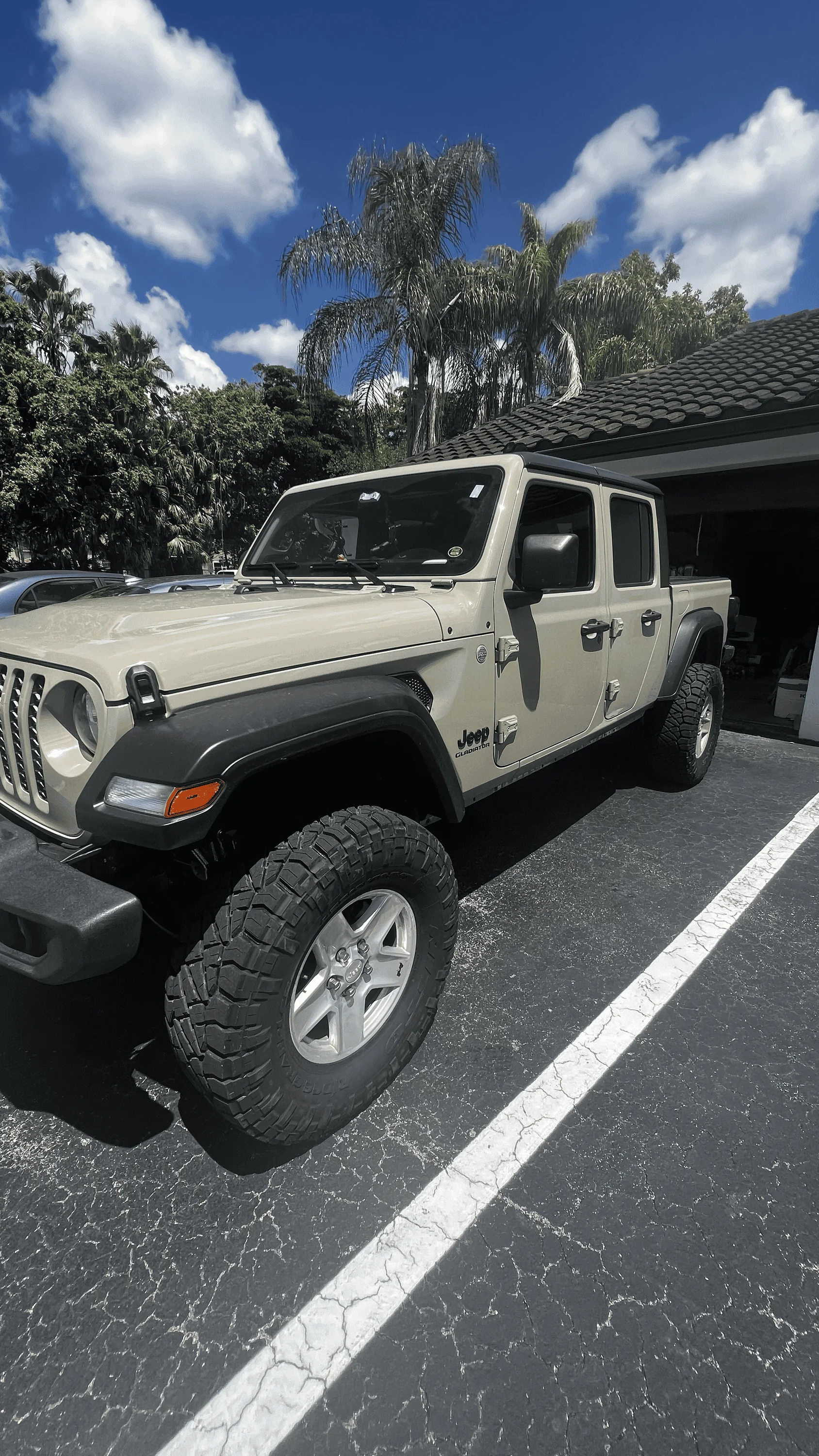

i have metalcloack 3.5 lift kit in a sport s nietos ridge grappler 315 with 1.5 spacers
Jeep Gladiator 315/70/17 tempImagejiKWLS
